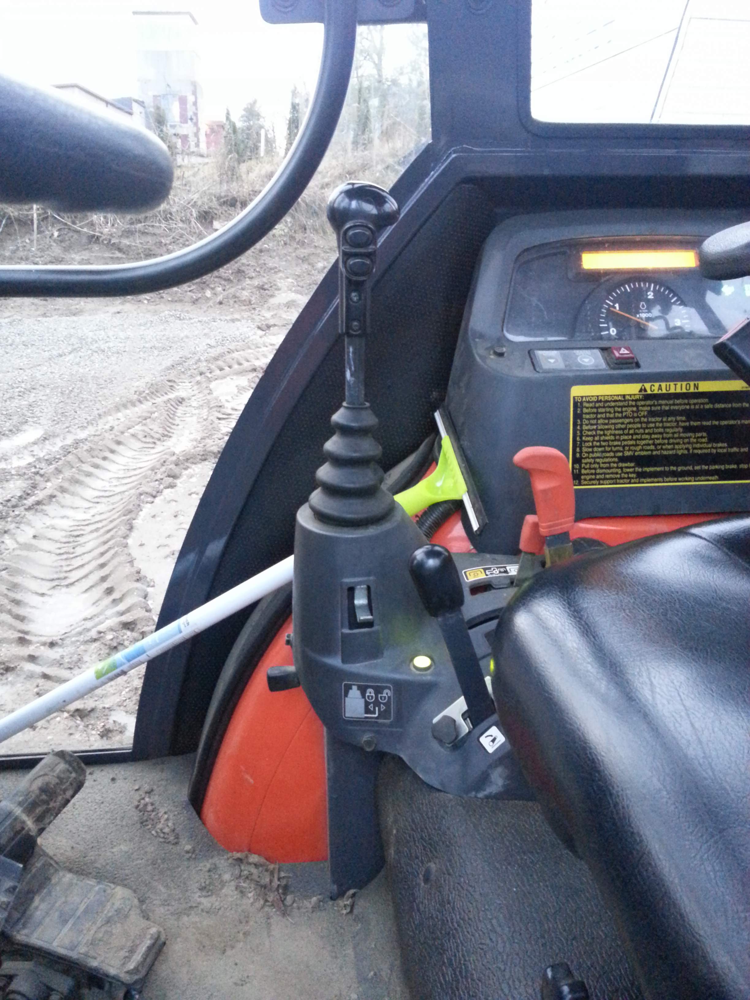

I am picking up a used L45 and I want to get to work over the winter on equipping it with some hydraulic goodies.
1. 3rd Function
2. Hydraulic Thumb
3. Rear Remotes
Could someone that has an L45 with these options post some pictures of the various valves/switches/mounts/etc?
I'd love to just drop the machine off at Kubota and have them install it all, but I don't think I could ever convince myself to pay their probably $10k.
Also, is there anything you would change about the way Kubota/your dealer did the install?
Thanks!

Lauren,
I searched for your thread, any chance you could snap some pics of the 3rd function on the front? That is what I plan to tackle first.
Specifically: valve and valve location, handle and anything else that might be helpful would be amazing.

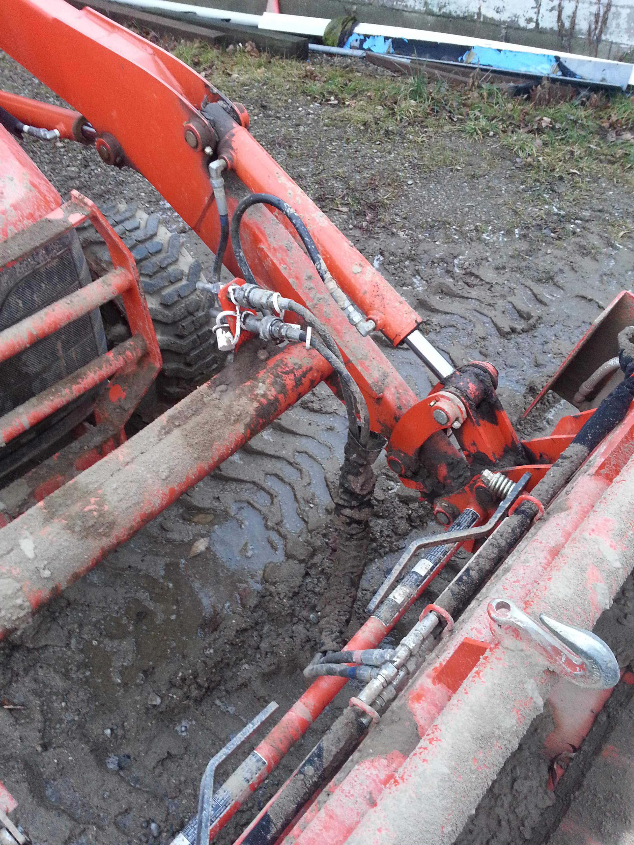

Here a couple of photos of the Kubota 3rd function for the loader. As you can see you get a new loader handle with two buttons underneath - you press one button to open and the other to close. These buttons operate electric solenoids I believe so at the base of the lever on the right you will see a round yellow light in the photo. The light indicates that the 3rd function is on - push the light/switch and it will turn off and the lever buttons will no longer function. The second photo shows where the quick connects get mounted on the loader. I have been working in a very muddy area for the last couple of weekends so the L45 really needs a bath.
L45 3rd function loader handle 121210.jpg L45 3rd function loader quick connects 121210.jpg
I know the Kubota 3rd function solution is not cheap but I think it is far better than having another valve to deal with. The buttons are very handy and allow you to open and close the attachment as you are raising and lowering it if need be. I would not want to have to deal with a separate valve and lever.

Lauren,
I GREATLY appreciate the photos you posted, as well as the commentary. I put a factory Kubota kit on my L39, and I just couldn't see the point spending $840 on an aftermarket one when $885 buys me one designed for my machine. A few questions:
1. Are the lines for the 3rd function hard line along the loader or are they hose?
2. What type of couplers came with the setup? Flush face skid steer or agricultural?
3. Did you buy your machine with the setup installed?

/ L45 Hydraulic Accessories #6
Hi ac
The hard lines run along the underside of the left llader arm.
The kit came with couplers that are not flat faced.
The dealer installed the kit as part of the deal. As I recall it was only a couple of bours labour.
Lauren

Lauren,
Wow, that's a nice change. The Kubota kit I put on my L39 was all hose.
I was quoted $150 for labor to install, so it must be ~2 hours.
