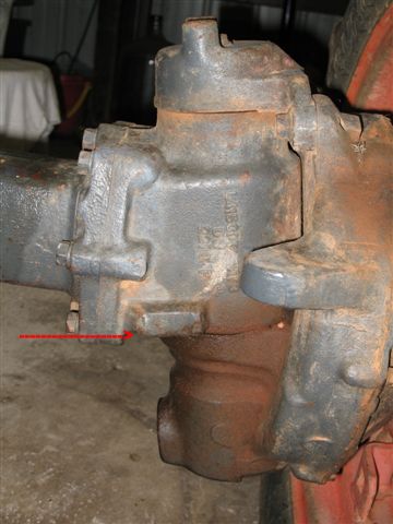

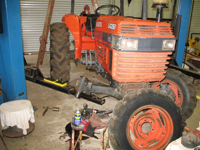

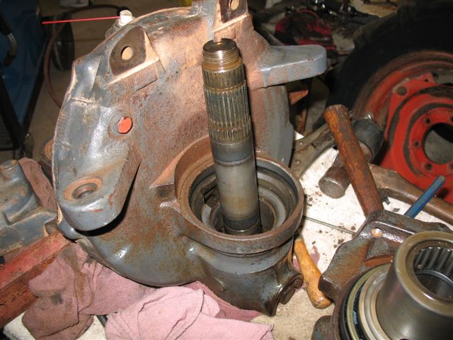

Any help on the serial number? By the way I've torn down front end and have right front kingpin assembly sitting on the workbench. I'm waiting on new seal to arrive. Hopefully I'll have it in a few days and I can get it up and running.

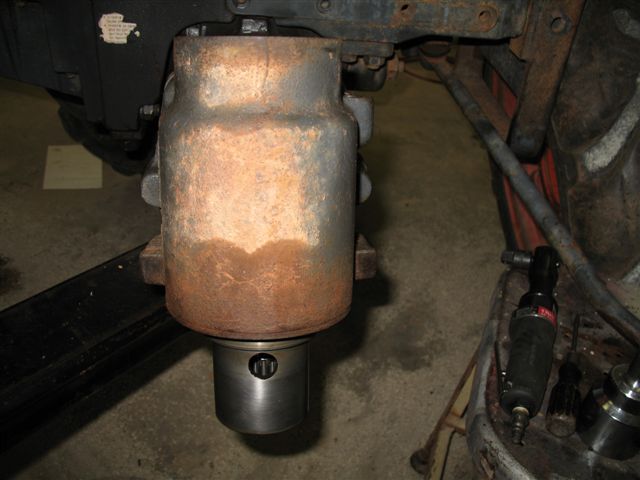

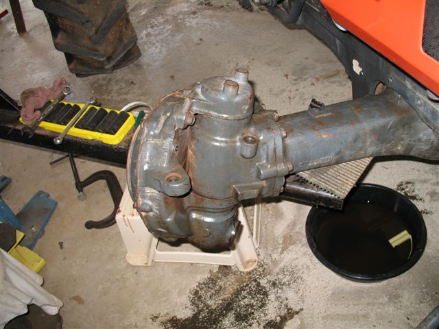

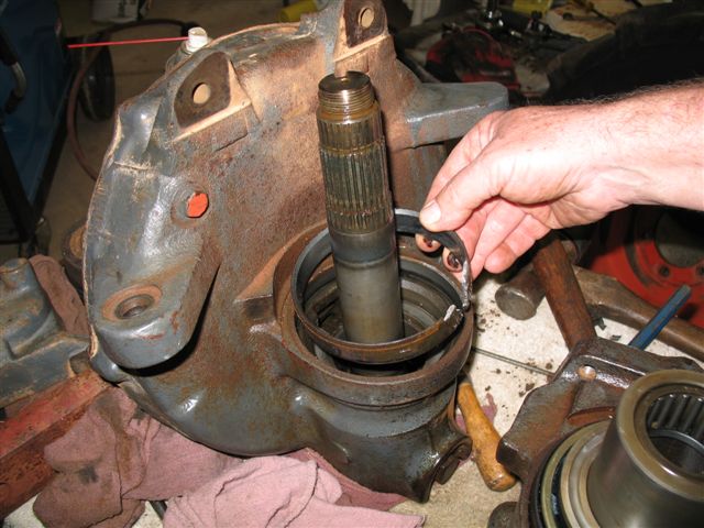

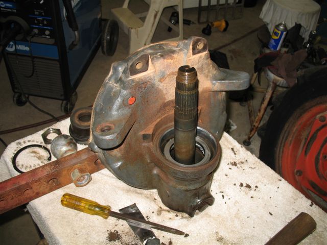

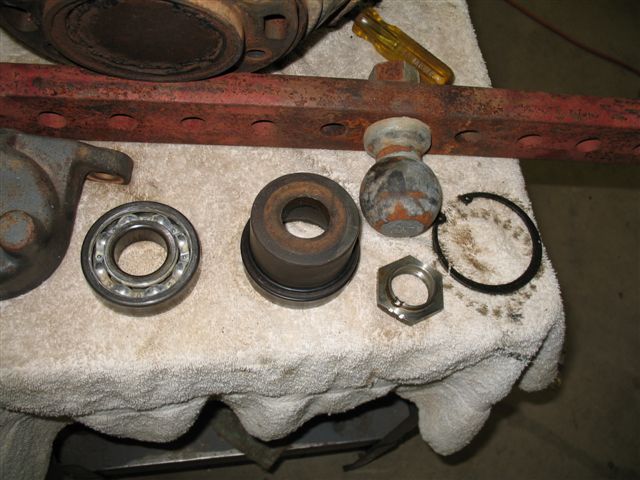

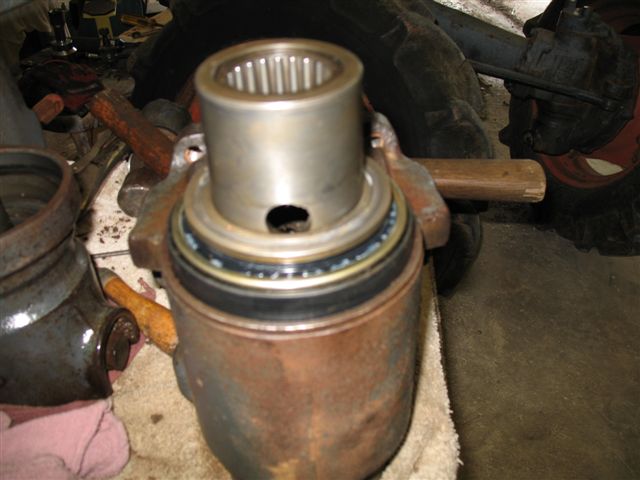

I removed bevel gear case and put it up on the bench. The upper race for the thrust bearing is a press fit. I heated it a little so it would release from the shaft and slide off. I removed old seal and cleaned up shaft with scotch brite pad. I drove on new seal with an old enfamil can I keep bolts in the shop. It was just the right size. This pic is the bevel gear case upside down on table with new seal, and upper thrust bearing race reinstalled.

It took about 2.5 quarts of gear lube to fill up bevel gear case and axle case which is seperate resevoir than main axle that has screw in dipstick. Also, I want to be clear on this. I highly recommend Ronnie at http://http://www.tractorsmart.com/enter.htm , without his help it could have been a trip to the dealer. My father in law was there every step to help because this is NOT a one man job. This stuff is heavy and it would be easy to get hurt.
One more thing about Ronnie, he charged me $30.87 for the new seal. I called two different local Kubota dealerships and they each wanted $52 for the part. This is a great forum.
Ken
