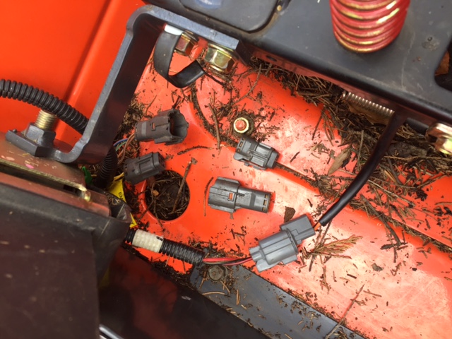

If you unplug the GST transmission ECU, you can remove the 2 dummy connectors and plug the 2 wired connectors by the right rear of the seat to put the tractor into 1st gear. but it may not work if you are having electrical problems.
Are all the hydraulics working, the GST gets flow from the regulator on the power steering section of the pump.
Check fuses under dash and fuses and connectors on battery. Had problems with the positive battery terminal and where the master fuses buss connector slides onto the battery terminal.

Checked all the fuses in both locations. Cleaned the battery terminals well. Voltage reads over 13v at 1500 rpm. Transmission fluid was low, although the tractor is on an incline. Topped it off to no avail at 1500 rpm. Loader, 3PH, and power steering all work. I'll check that master fuse buss connector tomorrow.
Below may be a picture of the connectors you mentioned under the seat. Their caps are lying nearby. Are those the dummy connectors you mentioned? The connectors were taped together and the yellow label says "Emergency" with what is probably a "read the manual" icon. Do I just unplug the GST ECU, and then plug these two together for first gear? Do you know where the ECU is located? (It's all mud down there..)
Thanks,
John
