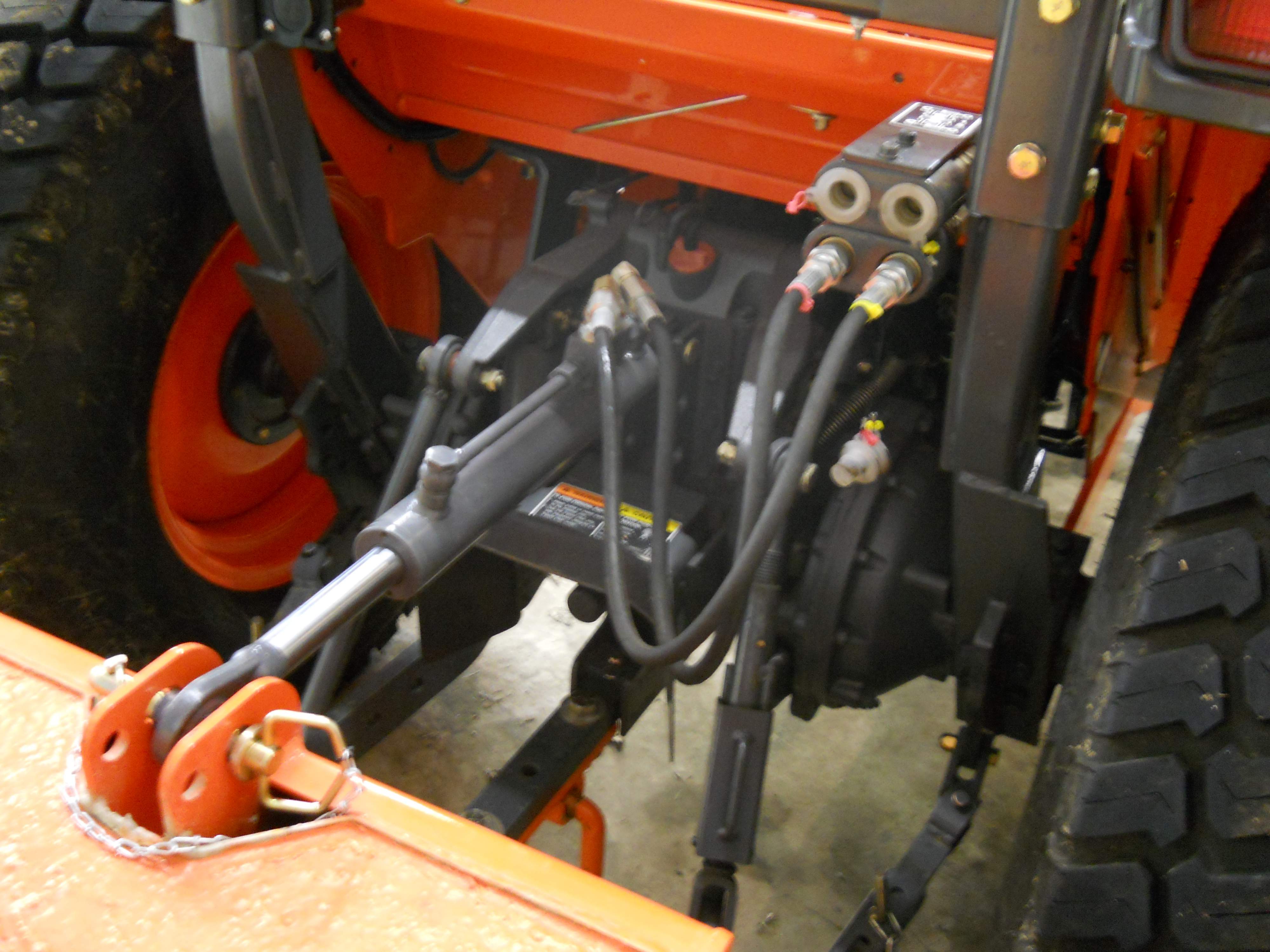

I need to do something about those stupid hoses on the tnt, they could have supplied some better stuff. I think I need a few 45's for them o fit better.
/ L4240 upgrades #15
I don't have the tilt, but I did install my own top. I used -4 hoses for better installation. The smaller inside diameter works well speed wise (I don't think anyone needs a speedy tnt), and just lays out better. Philip.

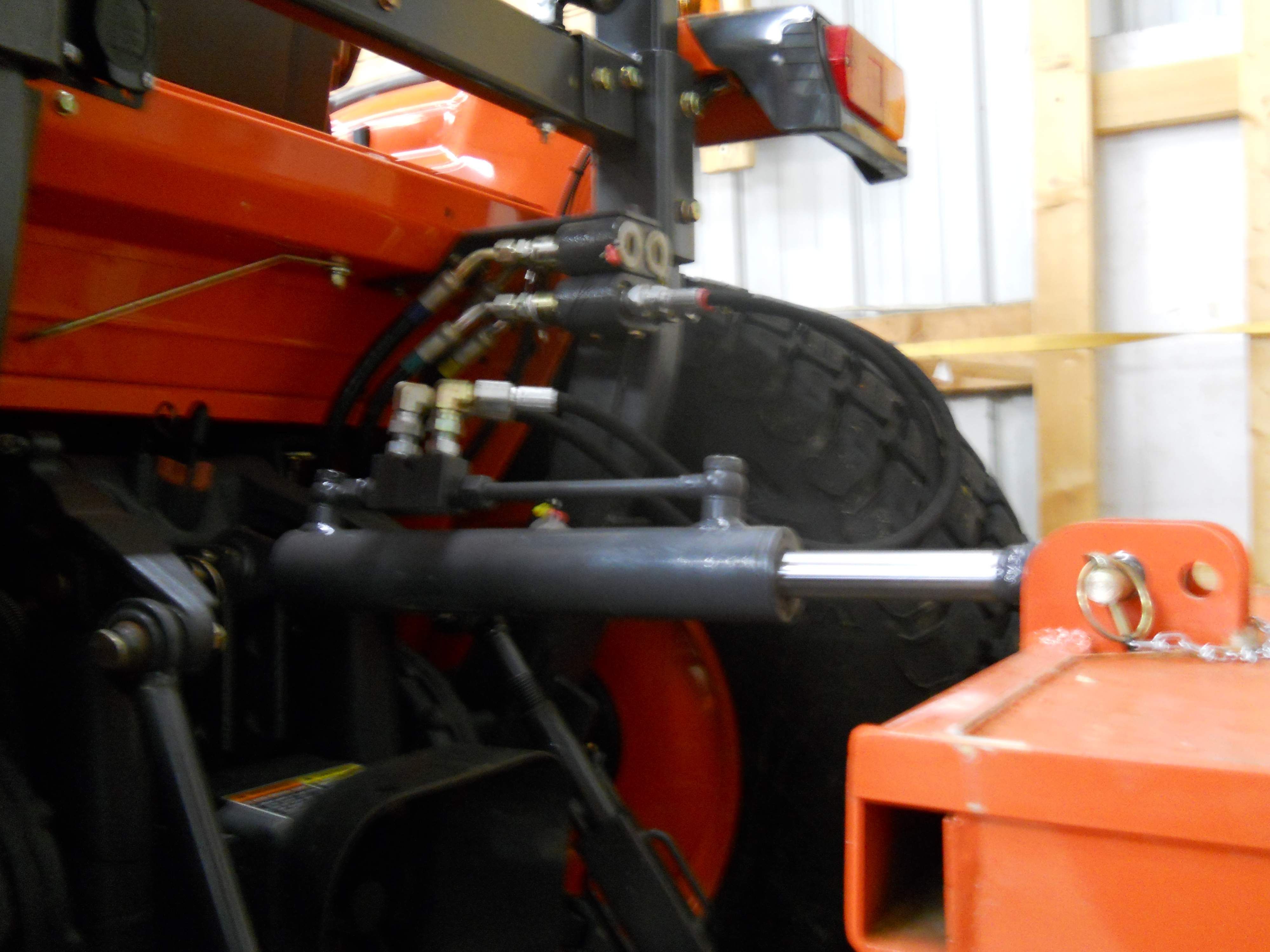

/ L4240 upgrades #19
That'll work. Is there any reason why you have the manually adjustable link for the tilt and the hydraulic cylinder?
It is often very difficult if not next to impossible to make the hydraulic side link exactly the size of the stationary link and still have an equal amount of tilt to each side. By installing the manually adjustable side link opposite of the hydraulic link, you then set the hydraulic link at mid stroke and then level the hitch out with the OEM adjustable link. Now you have an equal amount of tilt to each side. This only works if the design of the hydraulic link is to obtain an equal amount of tilt to each side. There are side links out there that are intended to only tilt in one direction : and if you were to adjust the OEM link to get the tilt equal with one of those hydraulic side links, then your implement would never lift up as high as it should. ;)
/ L4240 upgrades #20
Sounds logical. I was curious because the non adjustable link has three pin holes while the adjustable one only has two.
