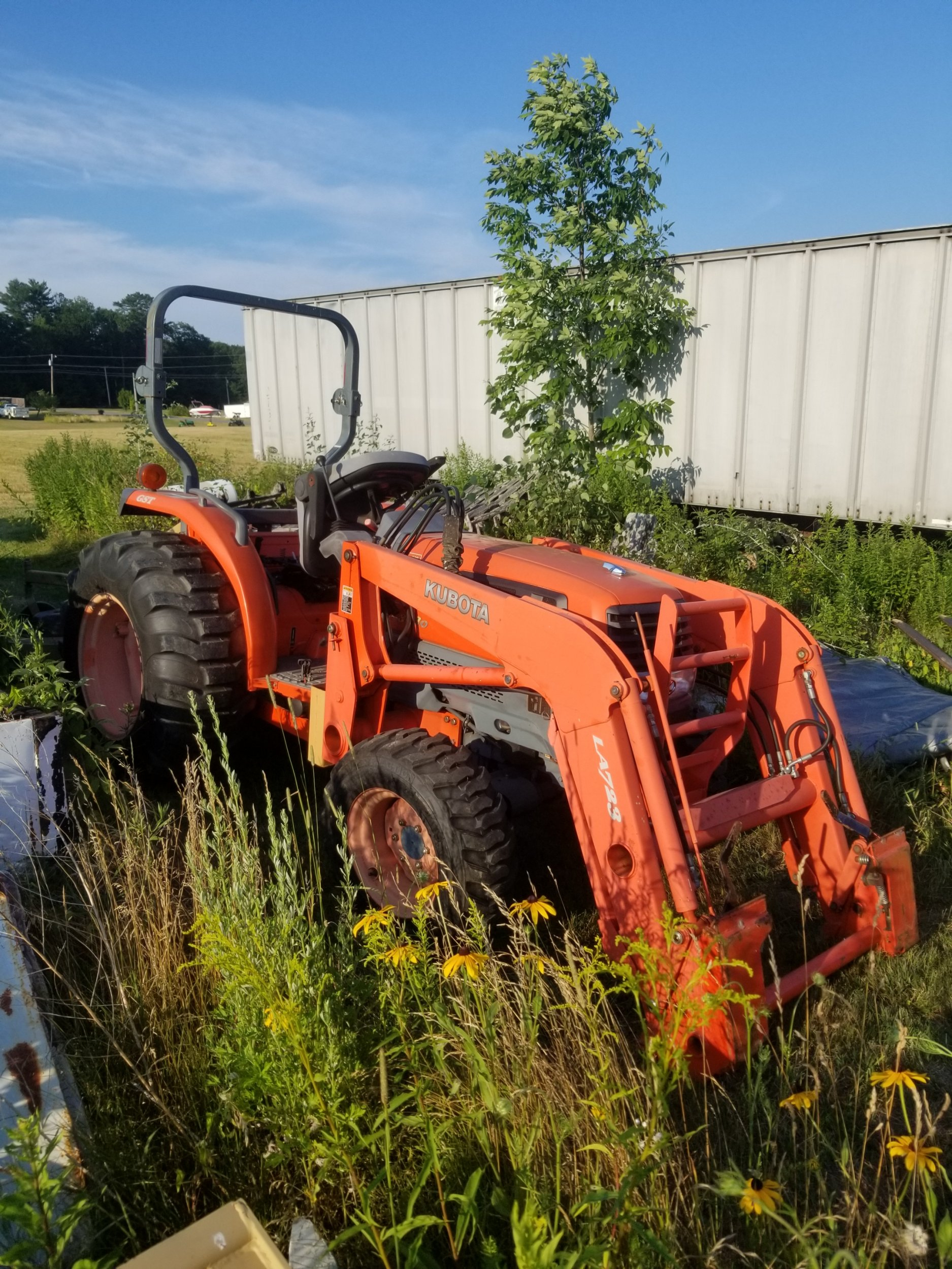

I recently purchased a used [AFFILIATE=1, nofollow=true, newwindow=true, title="Kubota"]Kubota[/AFFILIATE] L4240 GST with 1,100 hours. I took it straight to a neighbor friend tractor mechanic to look over.
What major things should be assessed, adjusted, replaced at this point? Anything particular to check for wear?

Fortunately the 40 series is a stout machine, and unless it was beaten like a rented mule I can't imagine you'll encounter any real problems.
Until you know exactly what need be done, I'd replace all fluids, as that's going to be a part of it anyhow. Oh, and get at the grease points.
   / L4240 GST 1,000 Hour Service #5
i'm willing to bet the 800 hours valve clearance check was not done. adjusting clutch and brake pedal wouldn't hurt. front axle pivot adjustment is at 600 hours.
like someone else mentioned, all fluids and filters on a new to you machine.

Yeah he’s just checking for anything I might’ve missed. And will run on his dyno to test output.
I ordered the shop manual pdf and will get part numbers together for the [AFFILIATE=1, nofollow=true, newwindow=true, title="Kubota"]Kubota[/AFFILIATE] dealer to order oil/fuel/air filters and fluids.
   / L4240 GST 1,000 Hour Service #8
The PDF (last time I checked) was free. A dyno (pto dyno) won't tell you much of anything anyway, except maybe if the main clutch is slipping or the pto clutch brake is shot. It won't tell you anything about the traveling gears or if the GST solenoids are working correctly. Why I would never have one, the complexity of the transmission.
