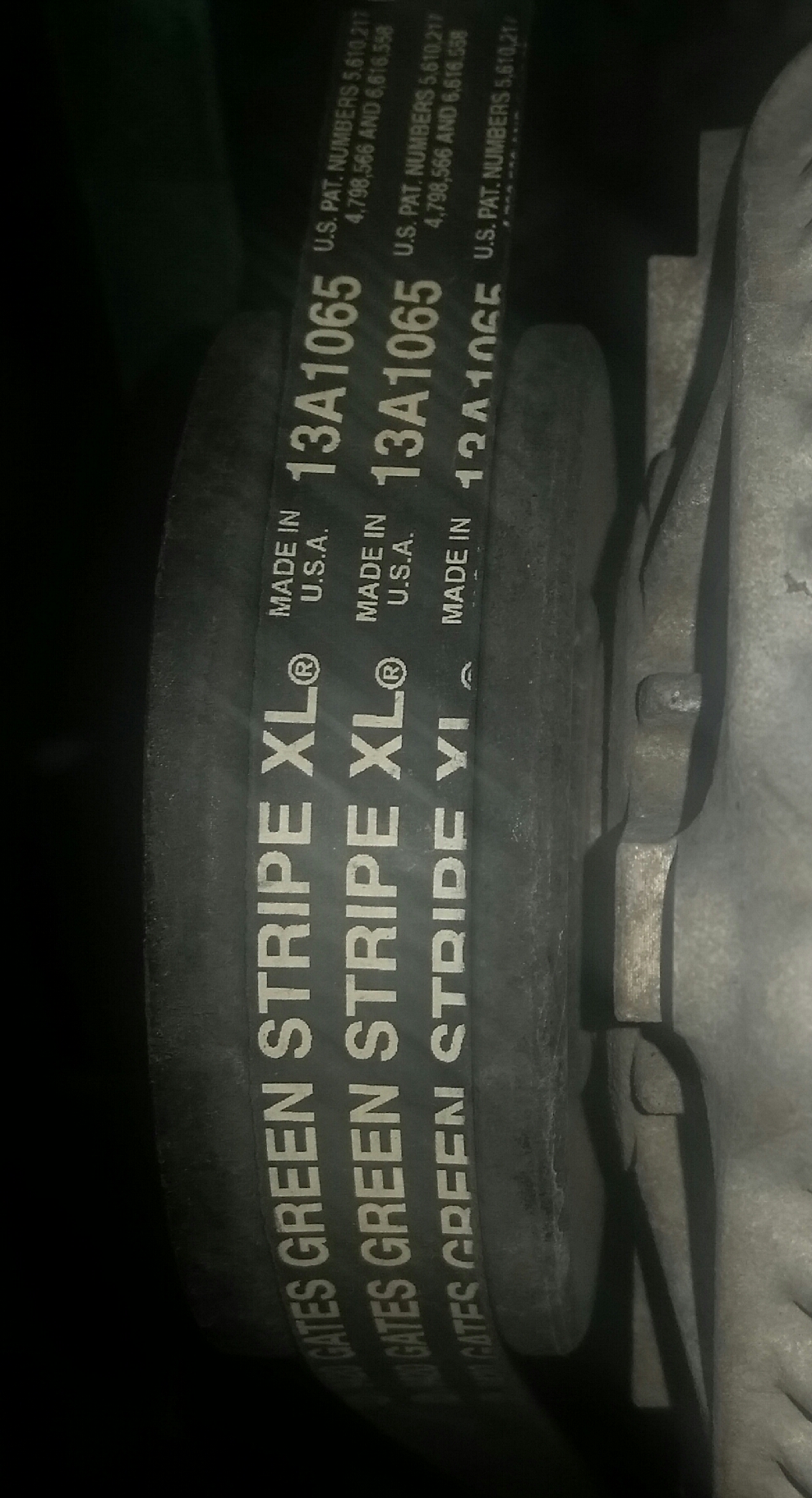

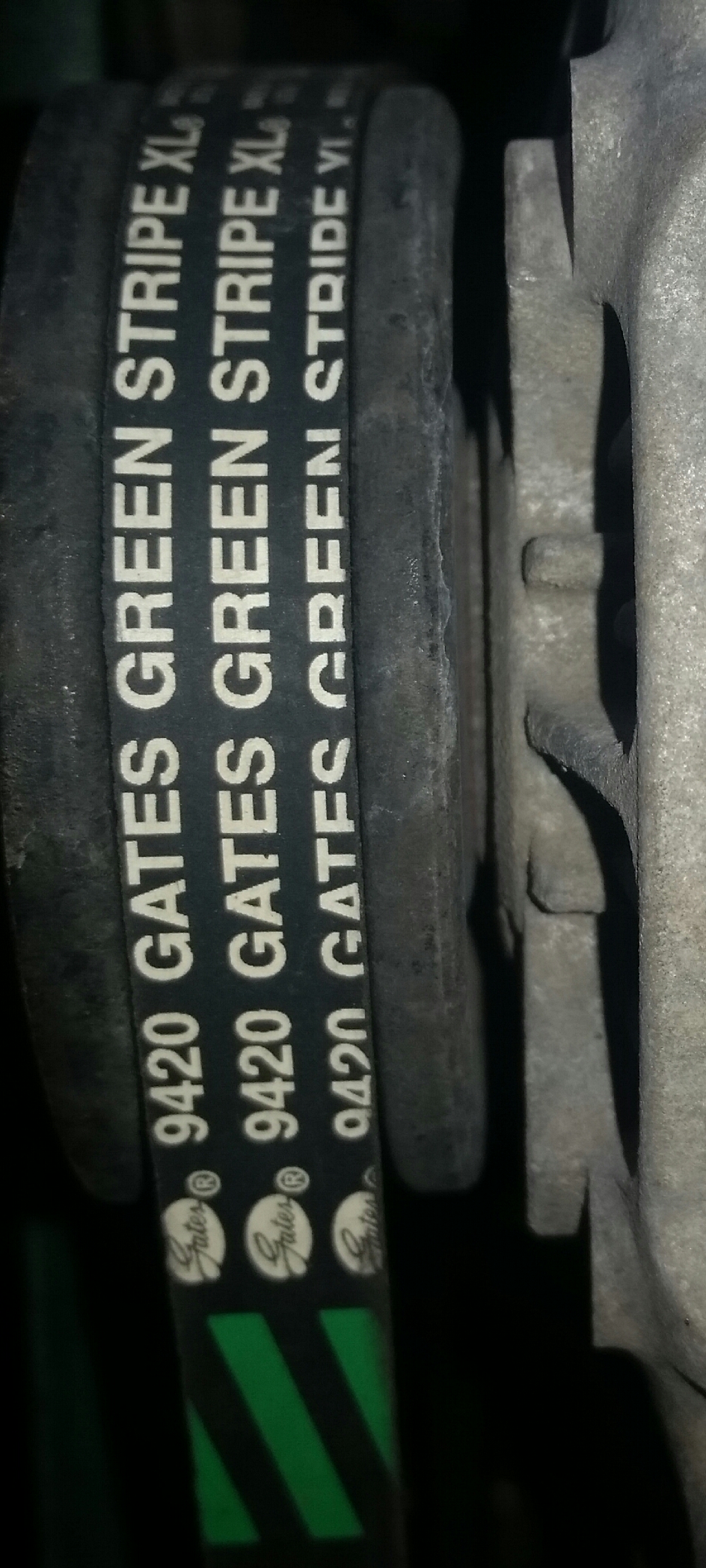

Hi Guys,
Could somebody point me in the direction of a step by step guide to replace the fan belt? I've no prior knowledge of the procedure.
Thanks,
Luath.
   / L4200 fan belt replacement. #2
The tension adjustment is the starting point...
Loosen the bolts that hold the alternator, then swing the alt in toward the engine, remove the belt from around the fan while fishing it out from inside the fan shroud, reverse the procedure to reinstall new belt.
BTW, if you actually Remove the alternator and then place the Shortest belt possible on the pulleys and then (With a little difficulty) remount the alternator... You will gain a little better access to the Oil fill port, located beneath the alternator... that is not really necessary but it is a little handier for my annual engine oil changes ... L4200 is A Great tractor, I love mine. KennyV
   / L4200 fan belt replacement. #3
The Best (though takes a little finessing to install) is the Gates 9420 same as Gates 13A1065... It is available at O'Rileys auto parts and a lot of others... KennyV
   / L4200 fan belt replacement. #4
This is a couple pictures of the belt on My L4200.... KennyV
