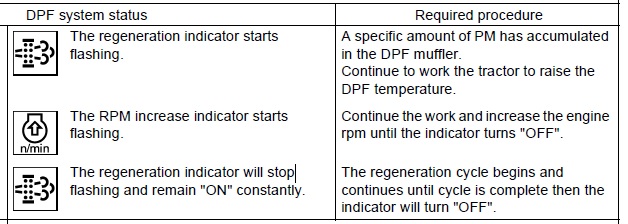

kubota L2650
had my second regen at 25hrs yesterday,the regen light started flashing then the rpm light flashed,i raised the rpms to about 2100 and the rpm light went out and the regen light stopped flashing...after a few seconds the regen light stated to flash again but the rpm light did not come on,i raised the rpms to about 2600 to stop the flashing but after a few minutes the regen light begins to flash again...this happens all thru the regen process and after about 25 minutes the light goes out ...if i was using my brush i would have had to stop because of the high rpms..most of the threads i have read have said raise the rpms to about 2100 ,the rpm light goes out and the regen light does not flash..i have kept my rpms at 1900 all the time when the tractor is running..any help will be appreciated.

When the rpms light goes out the regen light will keep flashing until the regen is done. It may take 15 mins or so then it should go out. When it gets close to being done you will hear the engine change sound and then the light will go out. All RPM light does is let you know if you are at the correct RPM's

I think the light or one of the lights is supposed to flash off and on while regenning.
This is wrong, here is what the OM has:
attachment.php
I have had mine start flashing again if I was working it hard and then stop. Raise the RPMs and it will stop flashing and complete.

glad i wasn't the only one having this happen..thanks for all the replies
