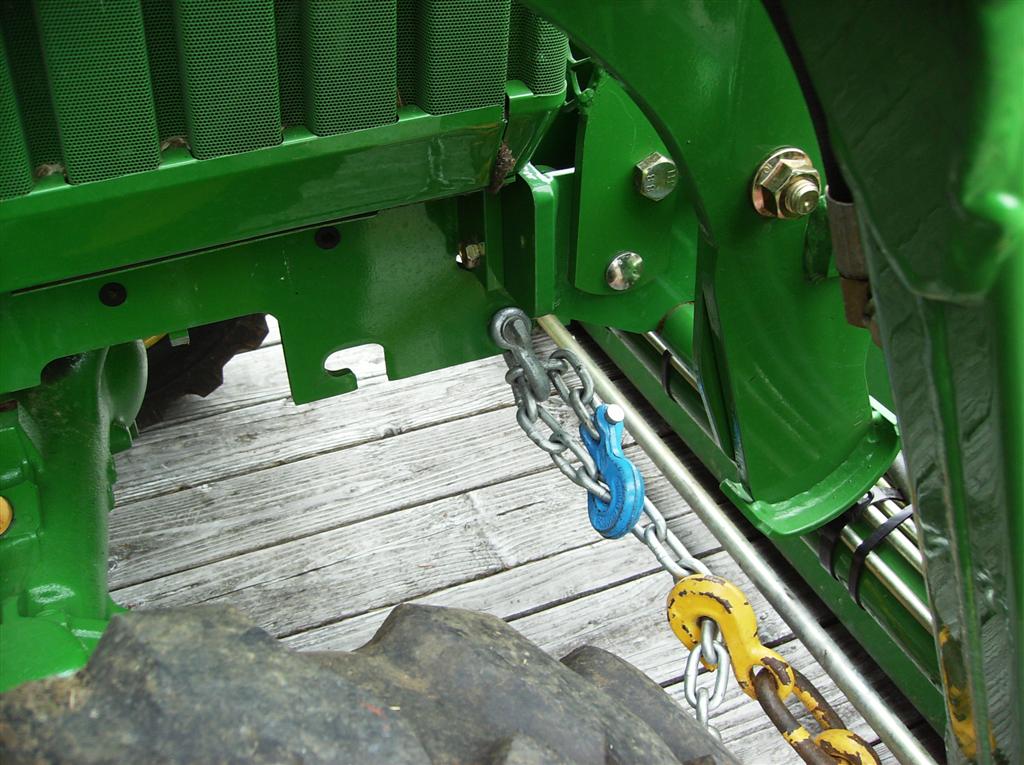

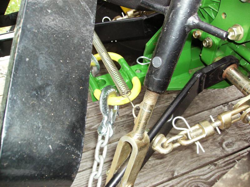

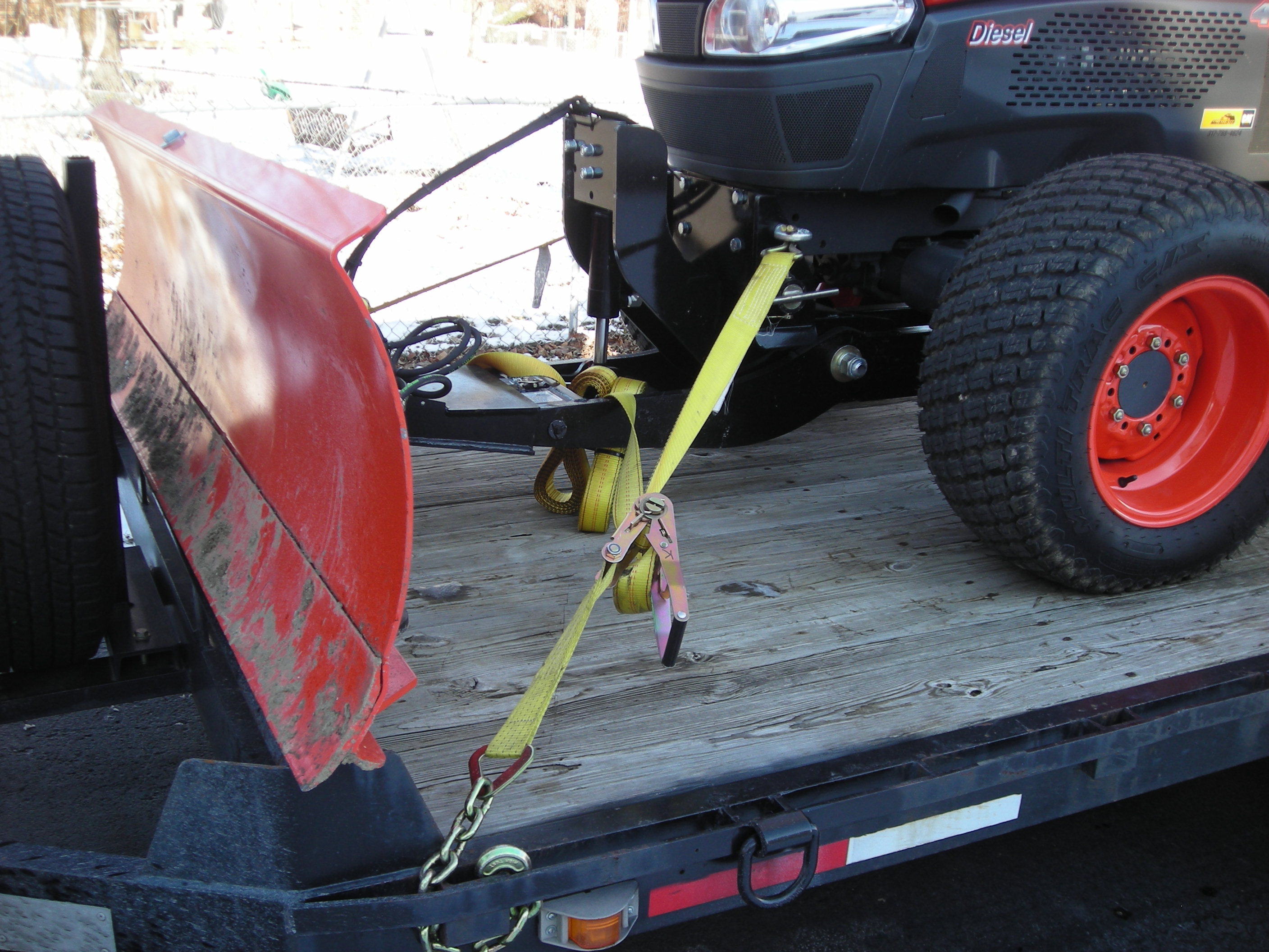

Here is how I do it on L3940. Take some of these ideas, look at your L39, and come up with plan. Philip.

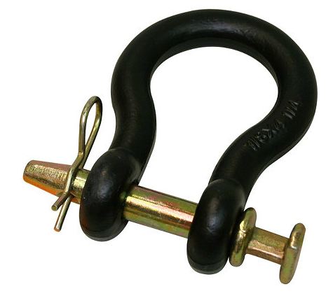

Something else on that page has worked well for me. A shackle with clevis pin and clip.
There are holes for and aft on my little BX that an appropriately-sized one of those will fit. The shackle is nice and smooth for a strap to bear against.

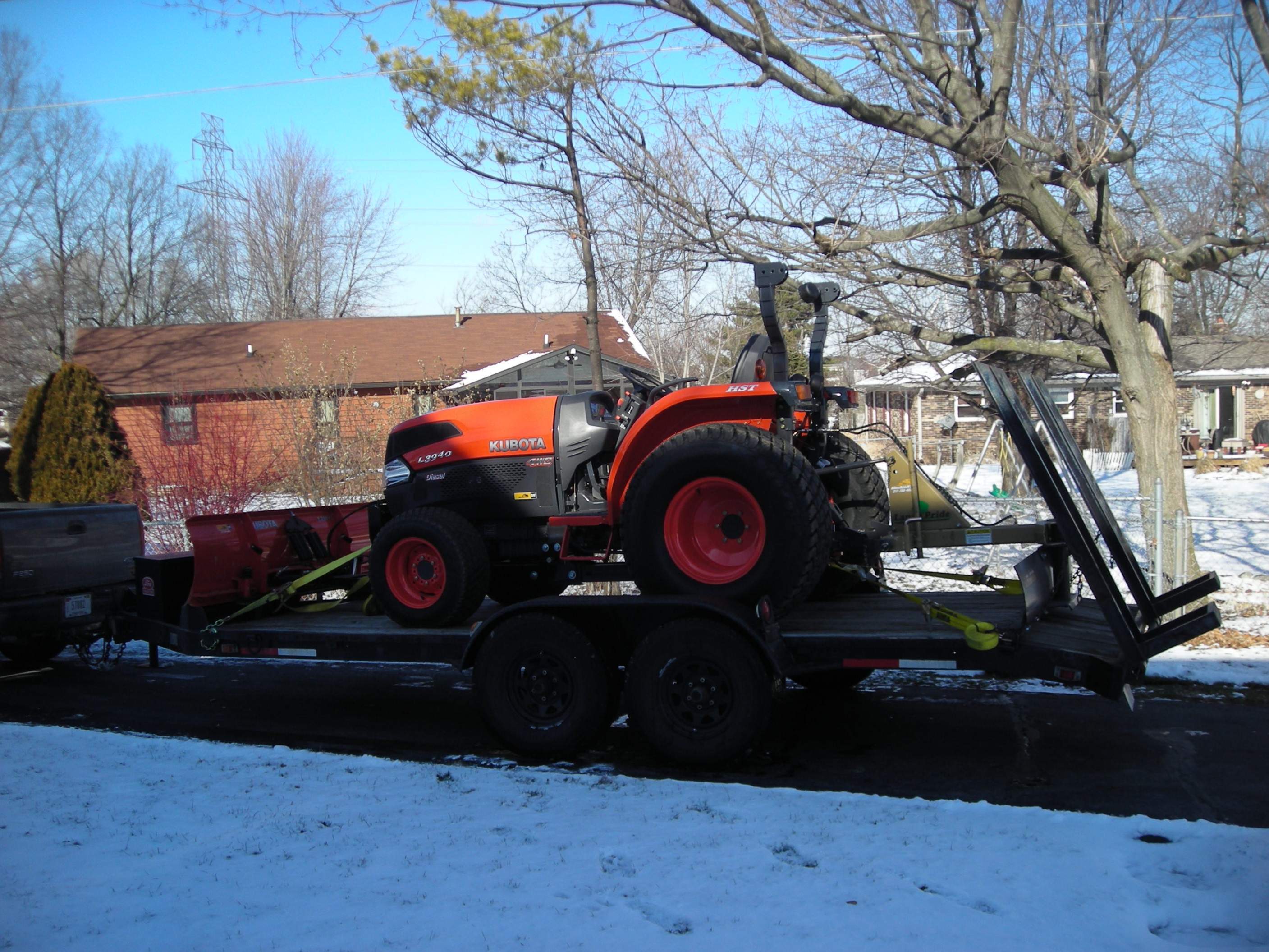

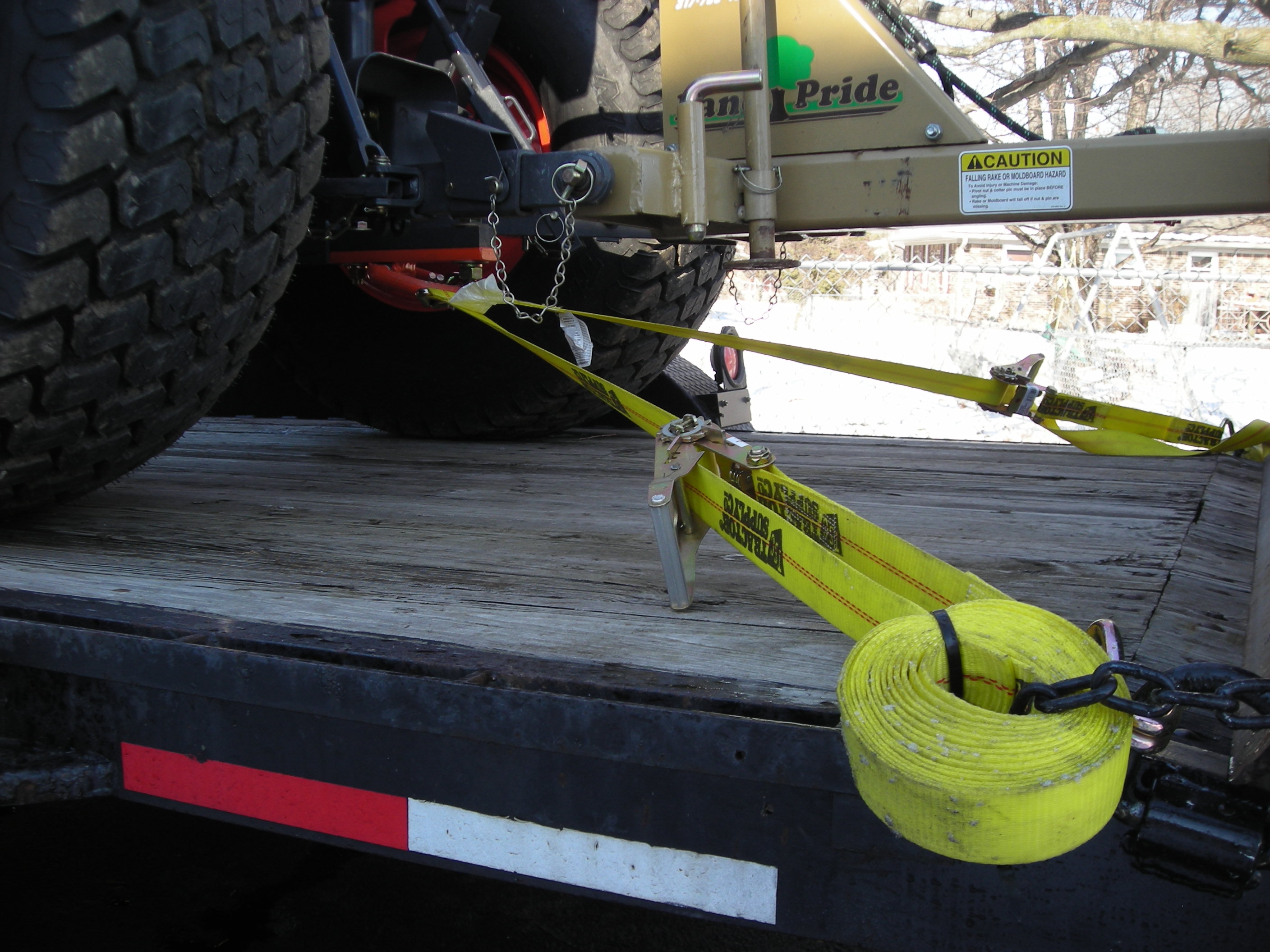

Here's a shot of my L39 on the trailer. I did not have a picture with it chained downed, so I drew yellow lines on the picture where I put the chains. One through the front brush guard, one through the backhoe at the lower pivot and one across the backhoe bucket. I typically put a tie down strap on the front bucket to keep it from bouncing.

/ L39 tie down points? #8
I do the same as this except for the one over the backhoe bucket. I curl the bucket all the way up and put the chain through the linkage.
I also put a chain over the front loader arms.
Z.
On our trucks we use several types of these type of clevis's to secure tractors. There are places on the front that take a small diamer pin and on the rear we use a twisted one to keep the straps right.
