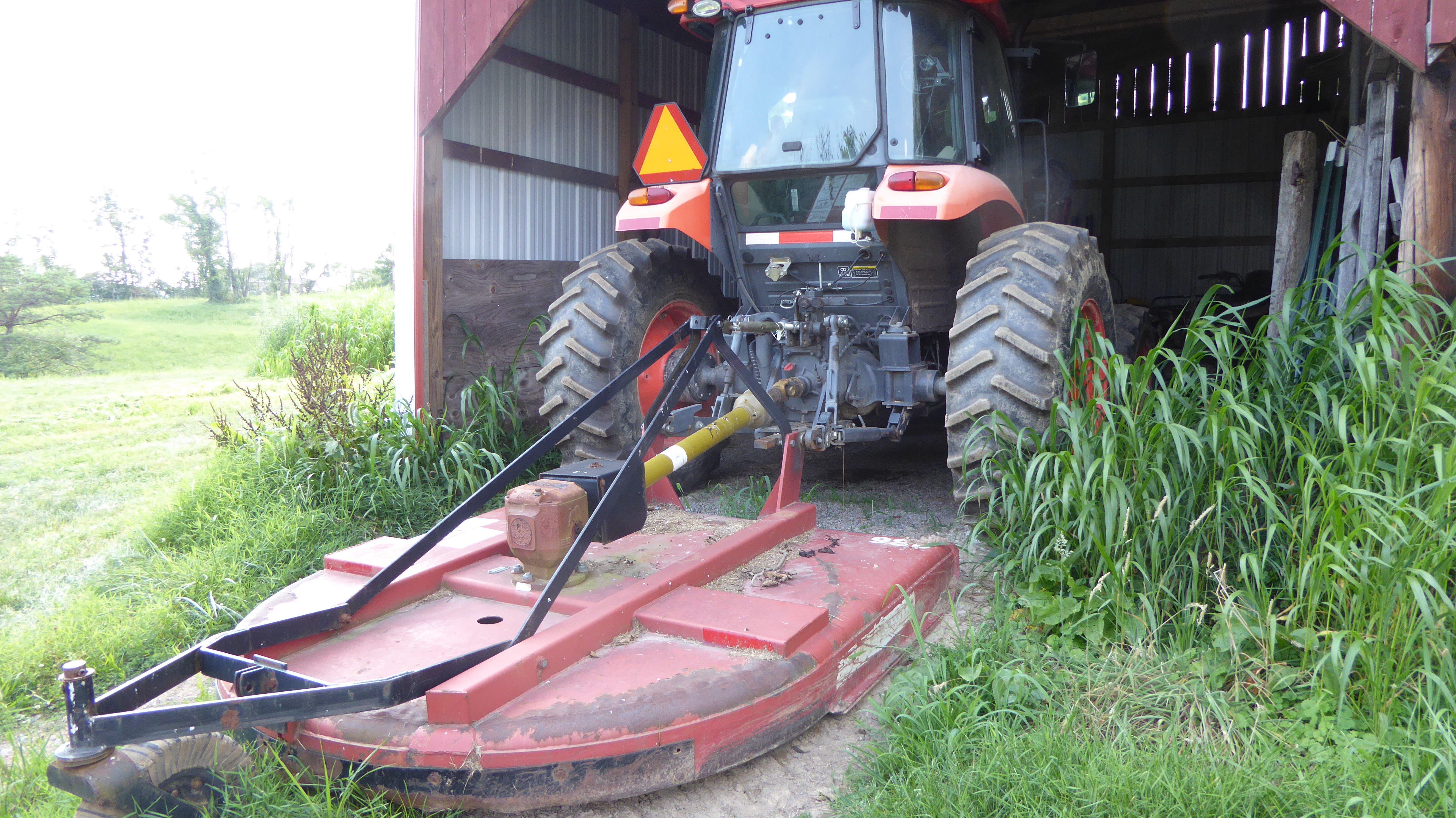

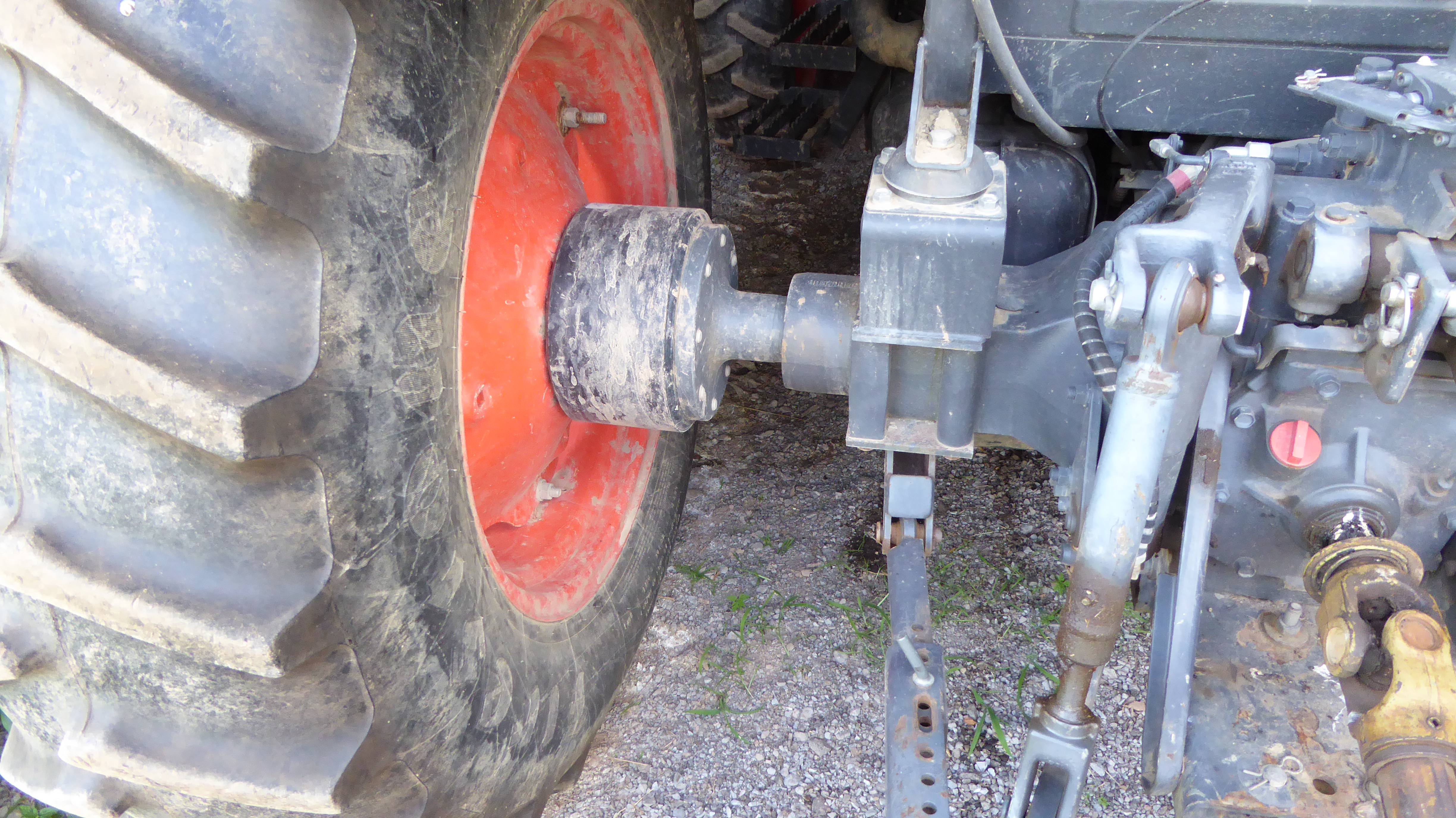

Oosik -- I've not been in the market for a tractor this size in several years. When I was, back in 2011, the larger Kubotas seemed to have a lot more flexibility in rear wheel spacing.
Whichever model Kubota I was looking at then would not quite go out to an 8ft "outer edge of tires" spacing. The MF 2660 I bought is set now (and the way I keep it) at just over 8ft outer edge to outer edge spacing and could be put out another foot (6" per side) if I needed to. My pasture renters have a 6040 and they added 6" spacers to each side which they felt was needed for comfort on steep ground. I really can't comment too much as I have not operated their 6040. They (and I) deal with some pretty steep stuff on an old hilly farm.
Here is what theirs is like:
