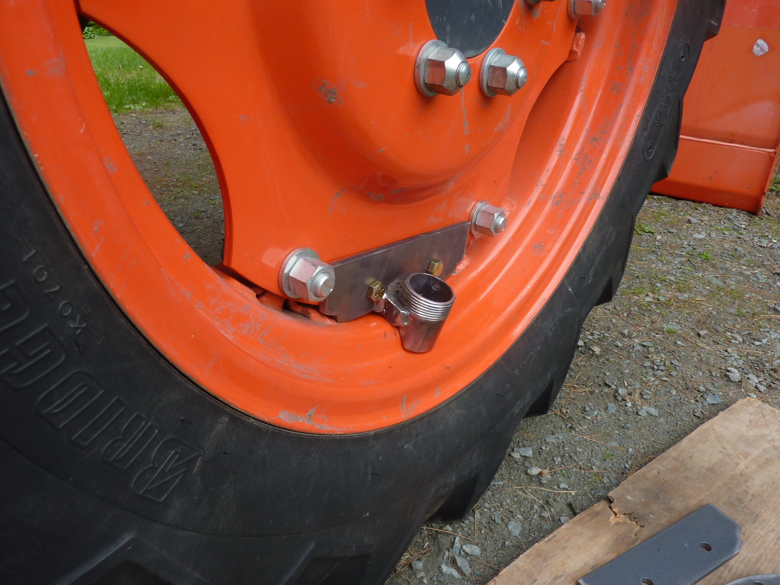

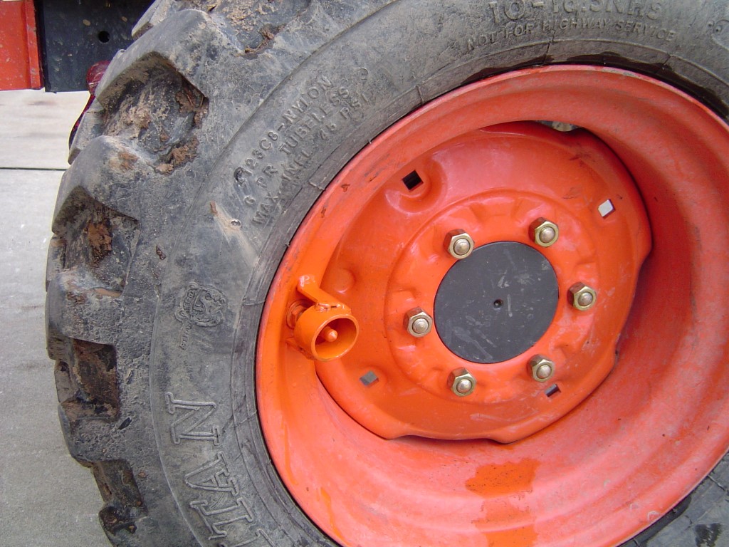

I f you run your tractor in the brush it is going to happen, Foamed tires will certainly do the trick but a simple guard will work too. Weld one on or get one welded on. Or make a clamp on guard like this.
gg
Nice job on the guard, I have welded couplings or nipples on rims as a guard but I like yourbolt on one better then welded on.

I went one step further with a clamp on valve protector, I took a old piece of inner tube with a hose clamp, laid the inner tube over the top of pipe, clamped the inner tube on so's to keep out debris being caked in around the valve stem, also makes a lower profile compared to a screw on cap.
