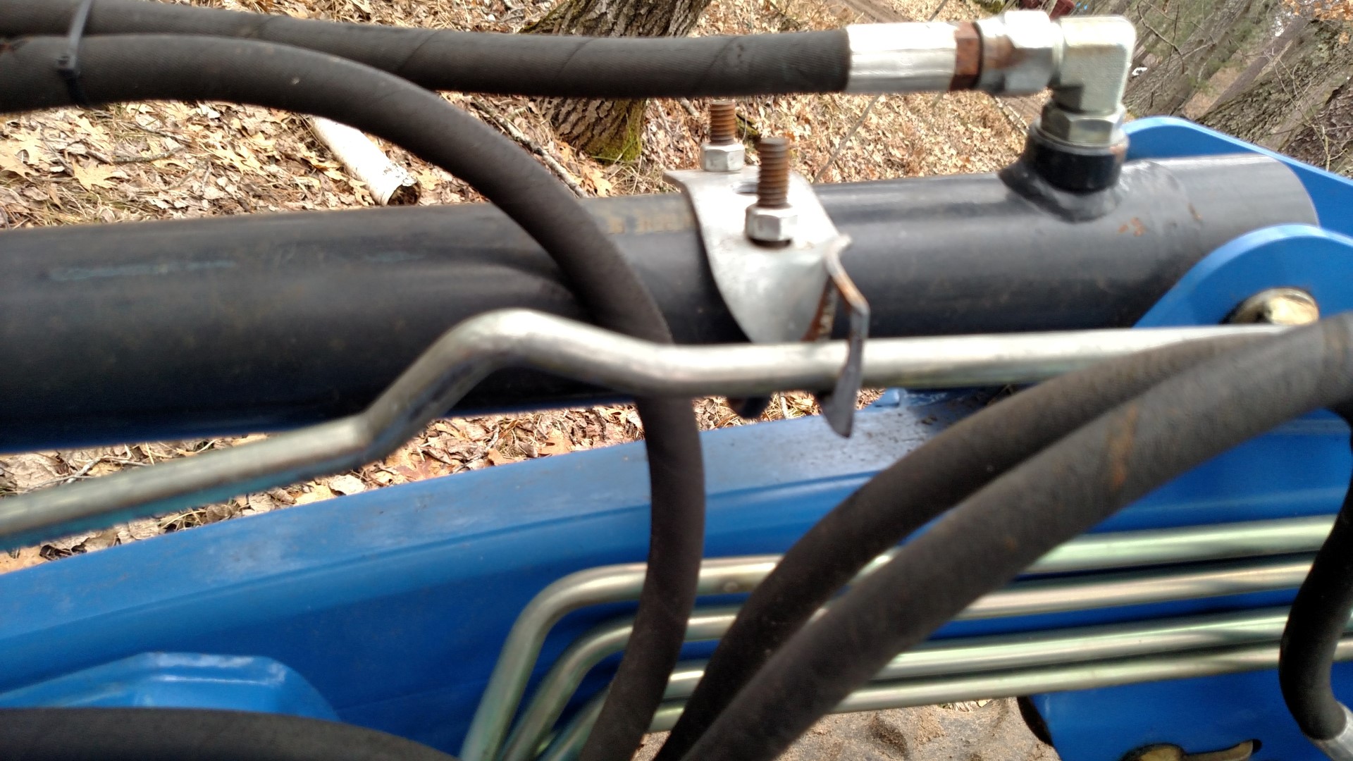

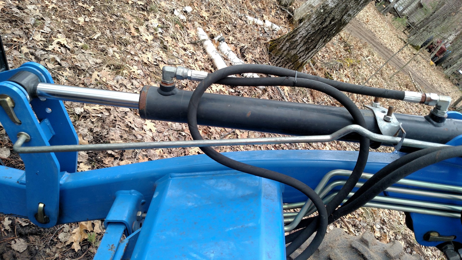

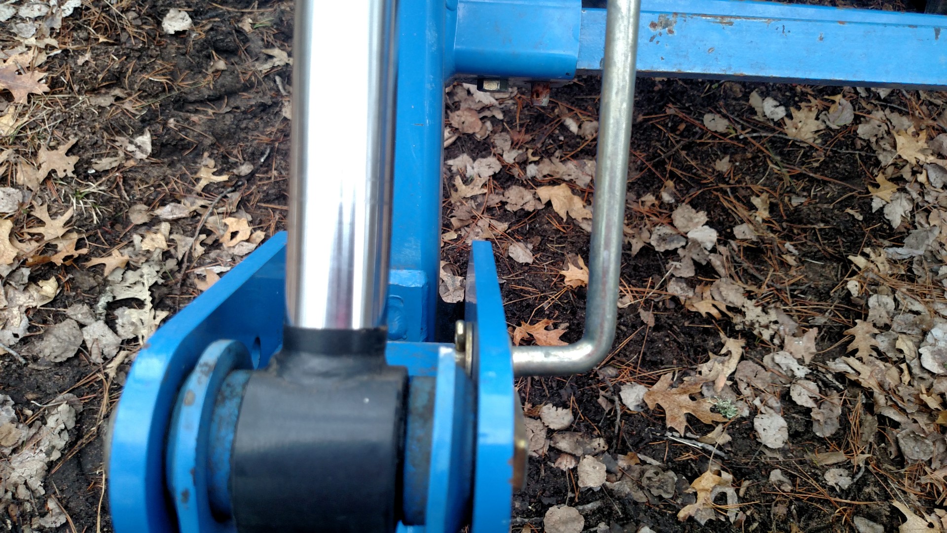

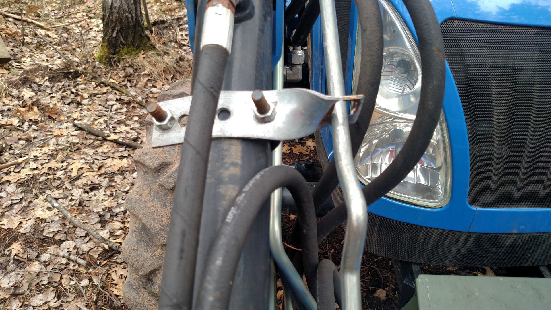

Here are pics of my bucket level indicator. When that little "crook" settles in the bracket, it's level. It really makes an operator out of you.
Bucket Level (Large).jpg Bucket Level 2 (Large).jpg Bucket Level 3 (Large).jpg Bucket Level 4 (Large).jpg

Thanks for the pics. I need one of these!
It works brilliantly, and should be easy enough to fab up. My New Holland 1925 had a rod that slid in a tube, but this design with the "crook" is much better.

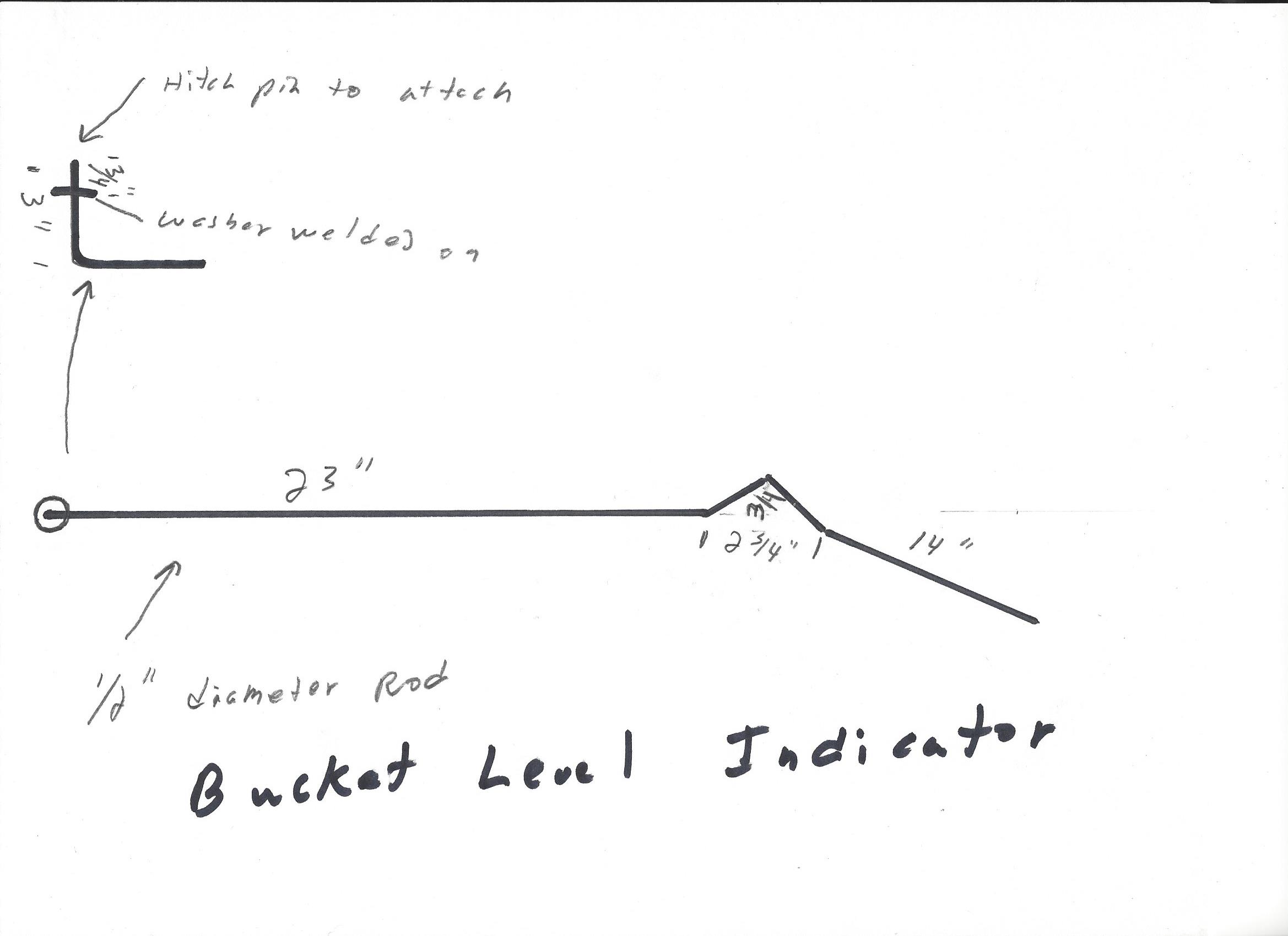

Bucket Level Indicator
I made a quick sketch of my bucket level indicator rod. It might make it easier to make yours, I neglected to note that it "droops" about 4" after the "crook" to follow along the angle of the loader arm. You may want to make a wire model to adapt the dimensions to your loader, but starting with some dimensions is easier than starting with no dimensions.

Awesome! Thank you, the wire mock up is a great idea...
