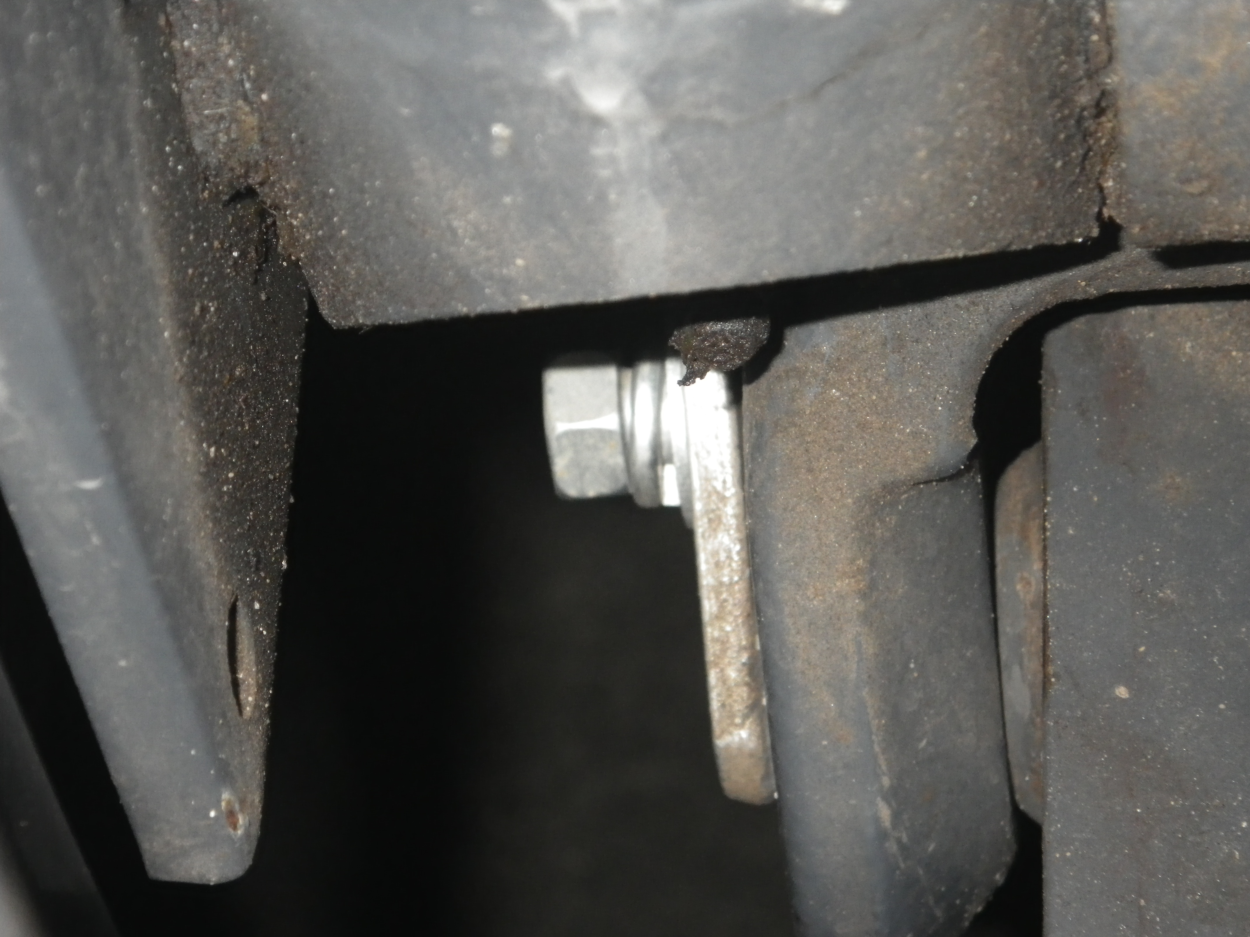

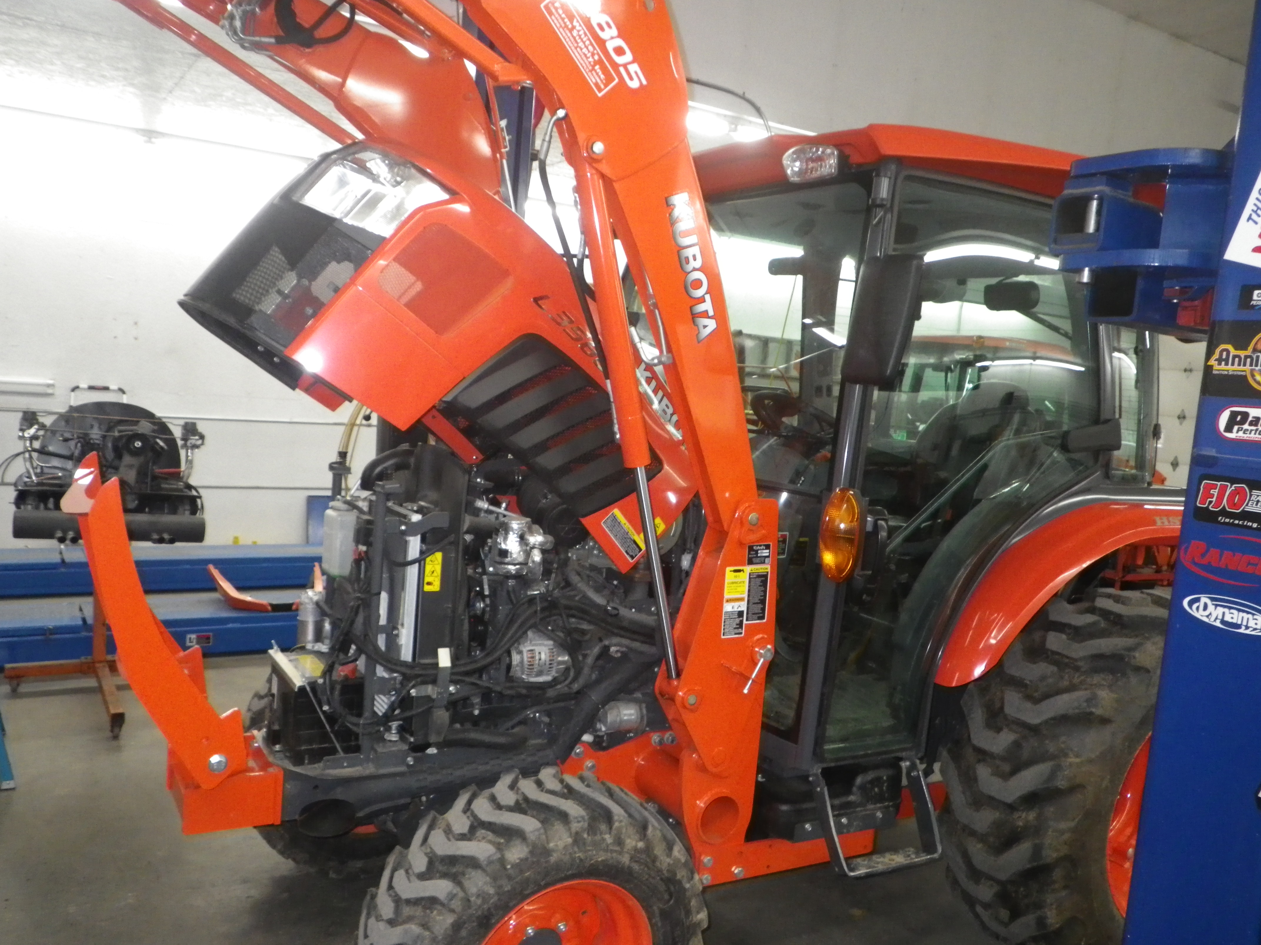

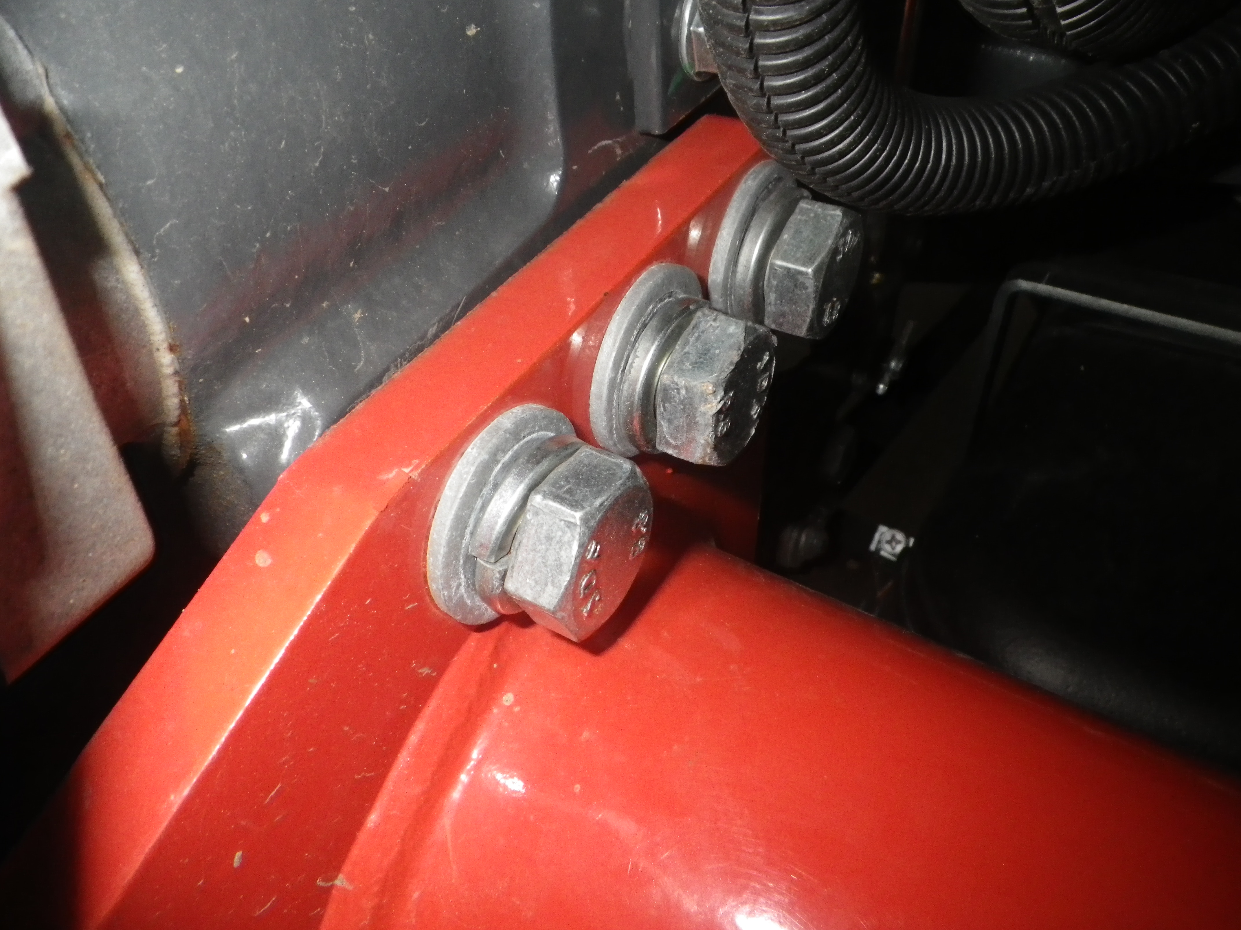

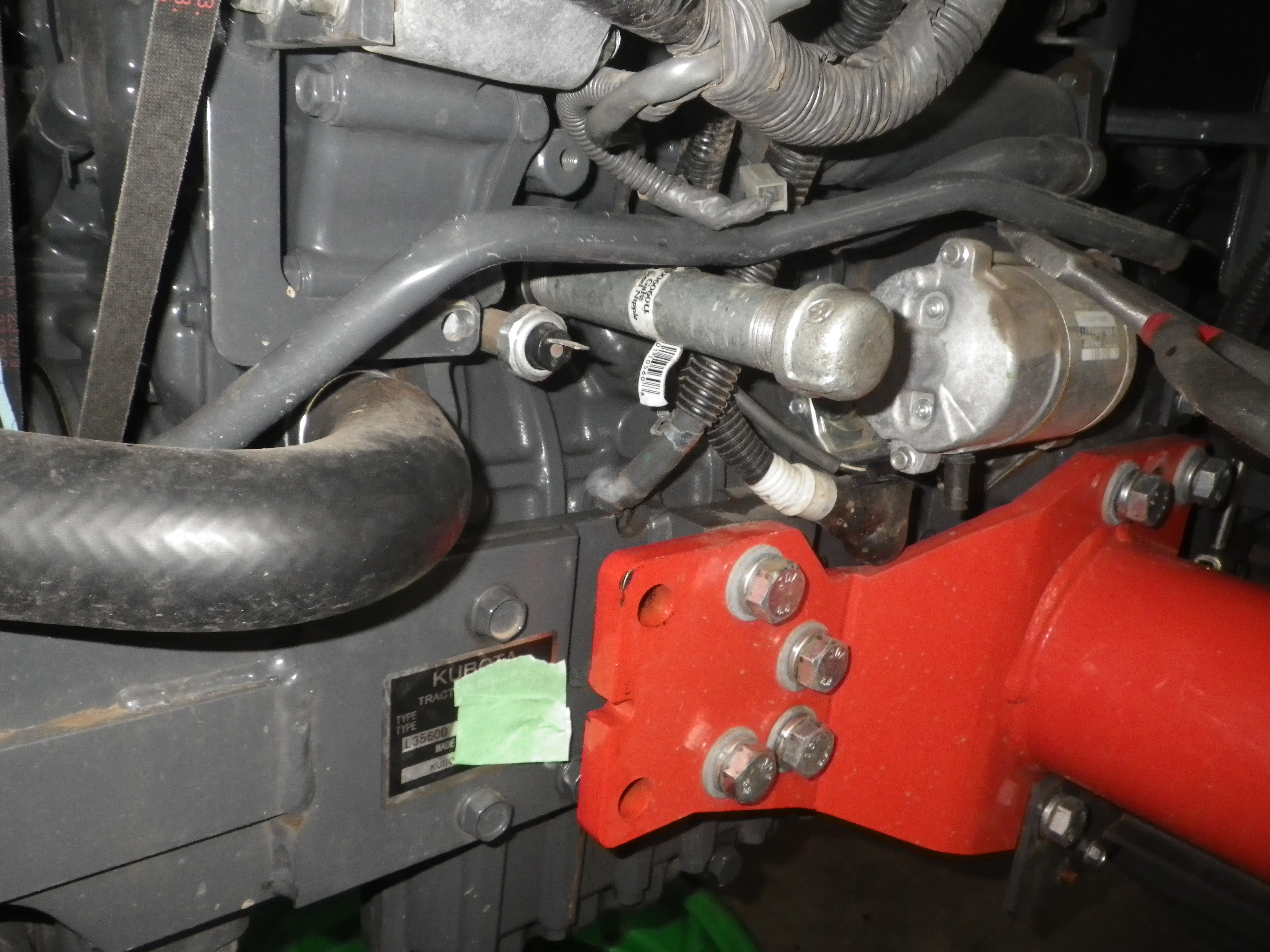

Not mine, I agreed to do the first service on this L3560 with 135 hours. Obviously never touched, it doesn't look like the loader has even been greased.

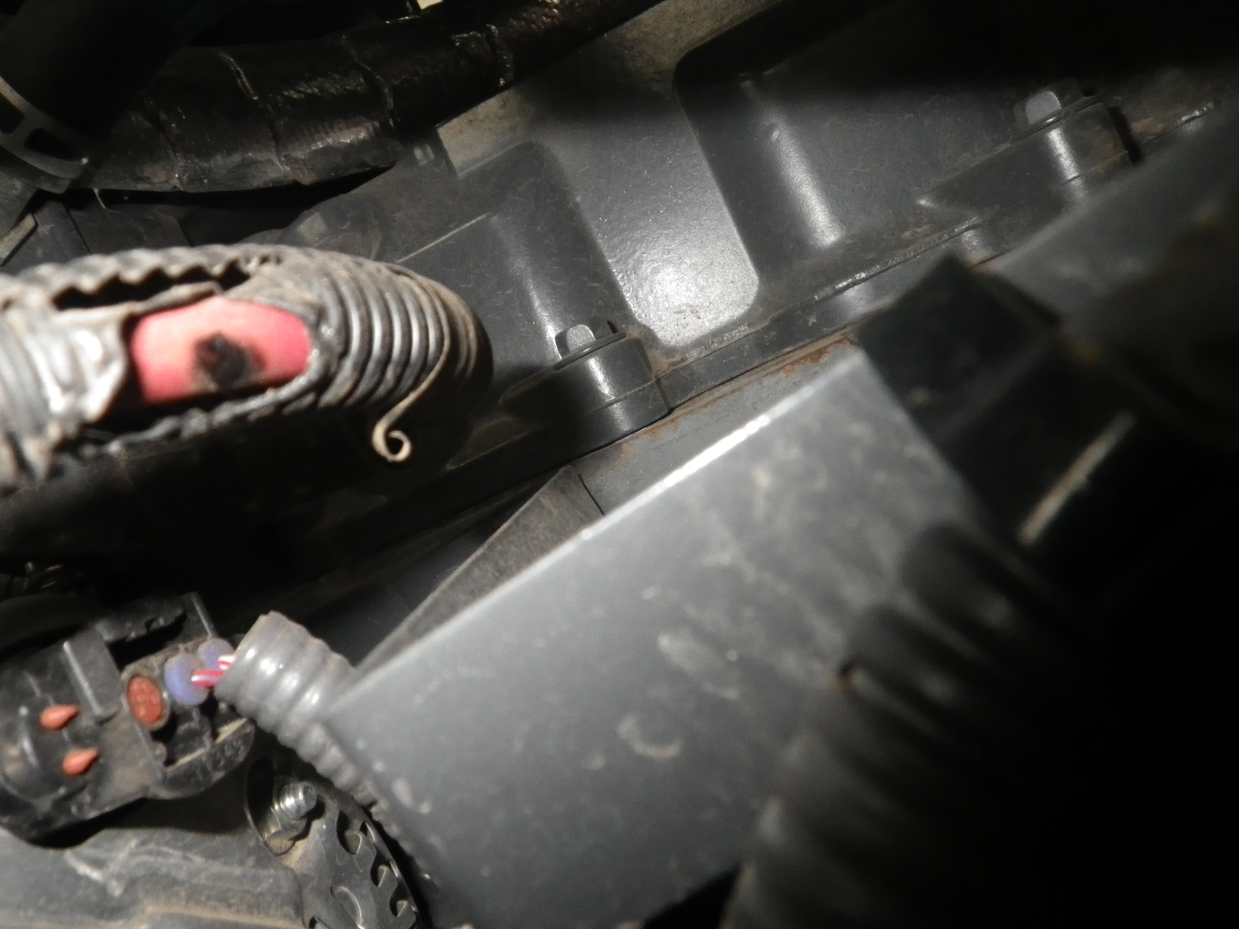

Loose bolts everywhere actually some falling out. Makes me angry to see poor dealer prep on a machine like this. Alternator belt loose, alternator wiring touching exhaust manifold.
Hydraulic hose hanging down 8 inches from the ground, not acceptable.
I will say this, running in the shop to warm it up it doesn't stink at all. Hate to say it but my next machine will be common rail with electronic control.
Thank-you dealerships but I'll do my own servicing.
Rant over.

The bolts are too long, I'm not sure why but they bottom in the holes. You can see where the tooth of the lock washer never contacted the base.

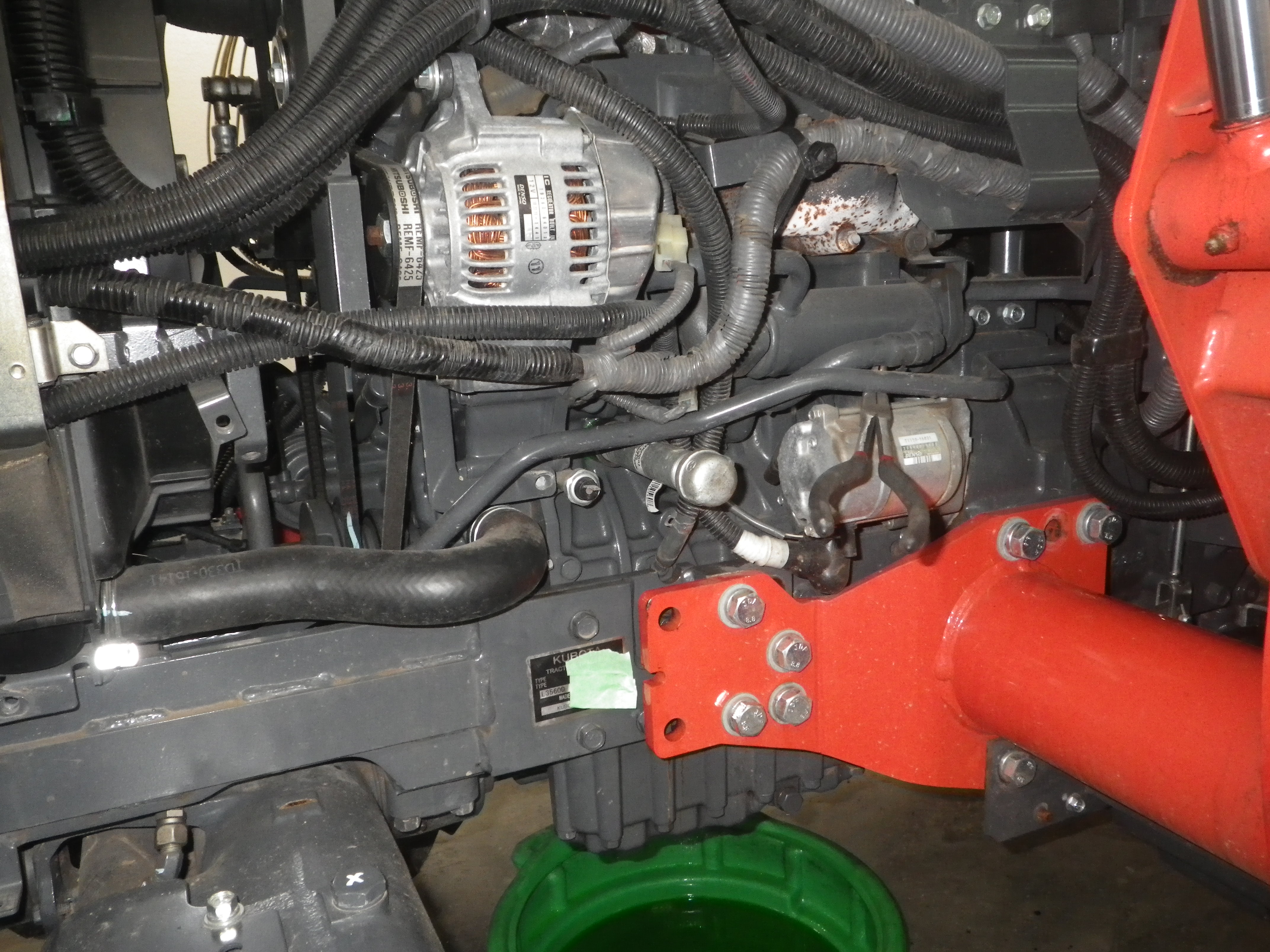

Also alternator belt falling off, it looks like this had some alternator update as witnessed by an extra instruction book in the manual.
DEALER setup issues no sense arguing the point, sorry I sound blunt but I see this constantly with service.

The bolts being too long is incompetent to the extreme on the part of the dealer.

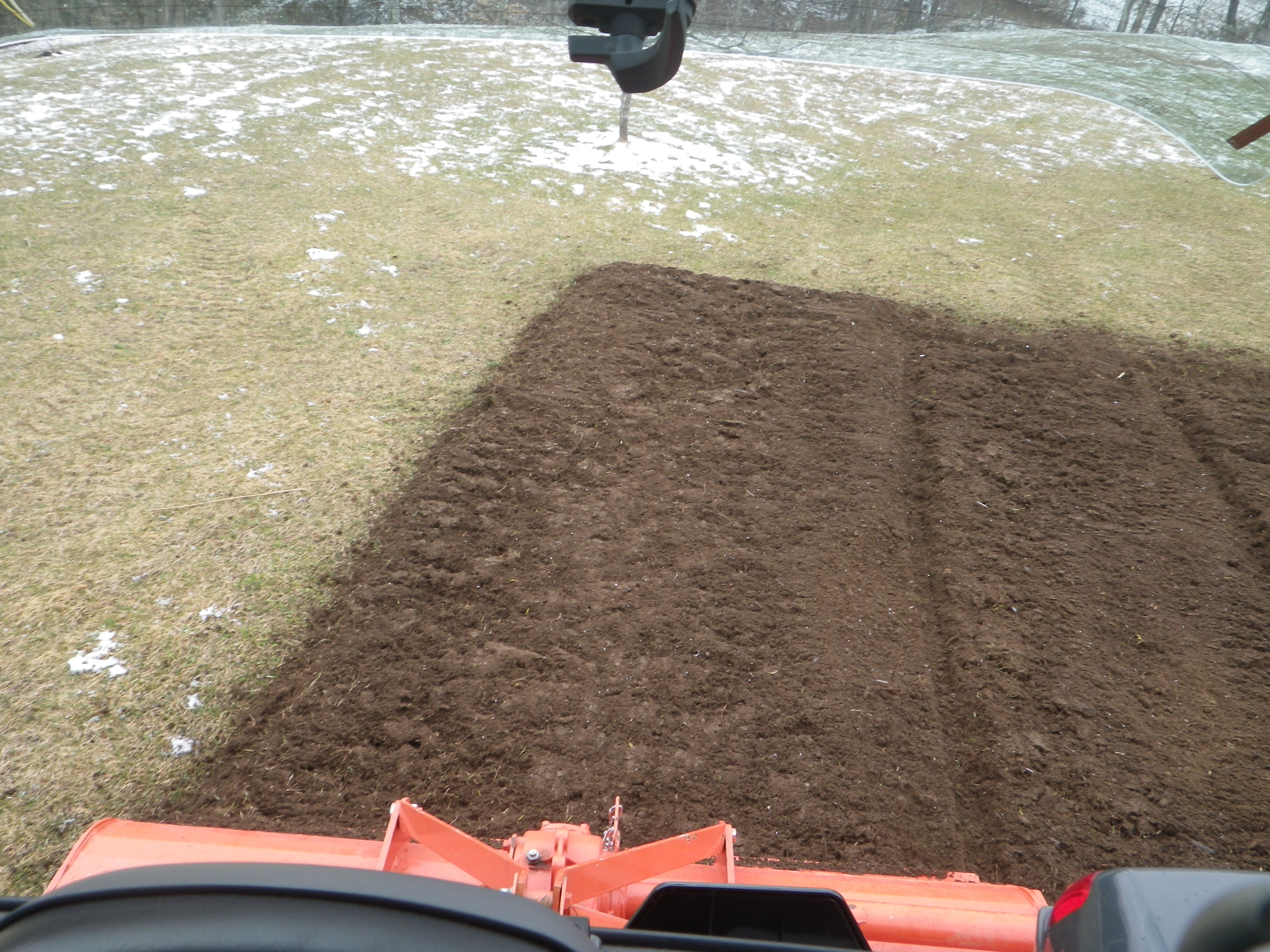

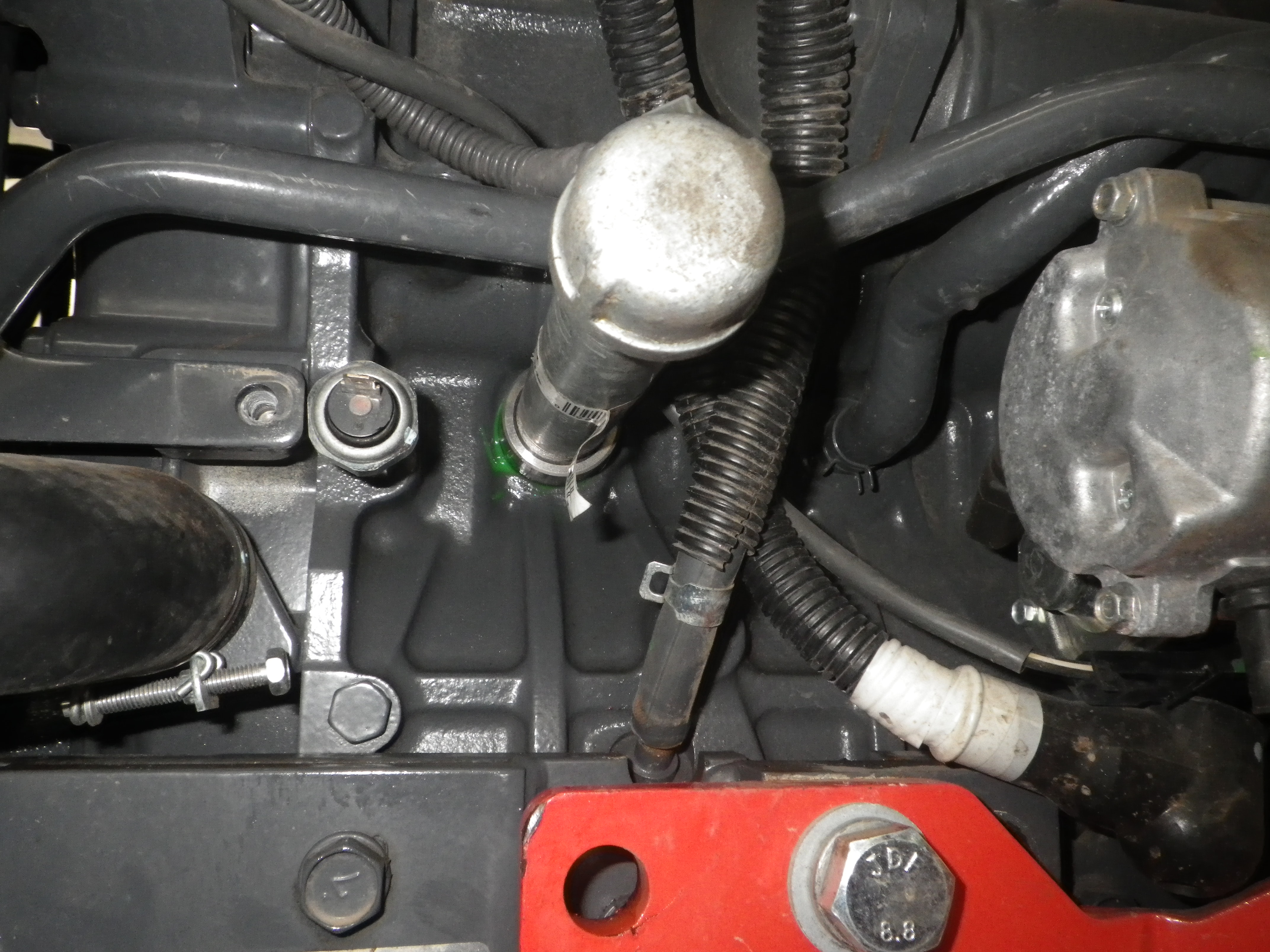

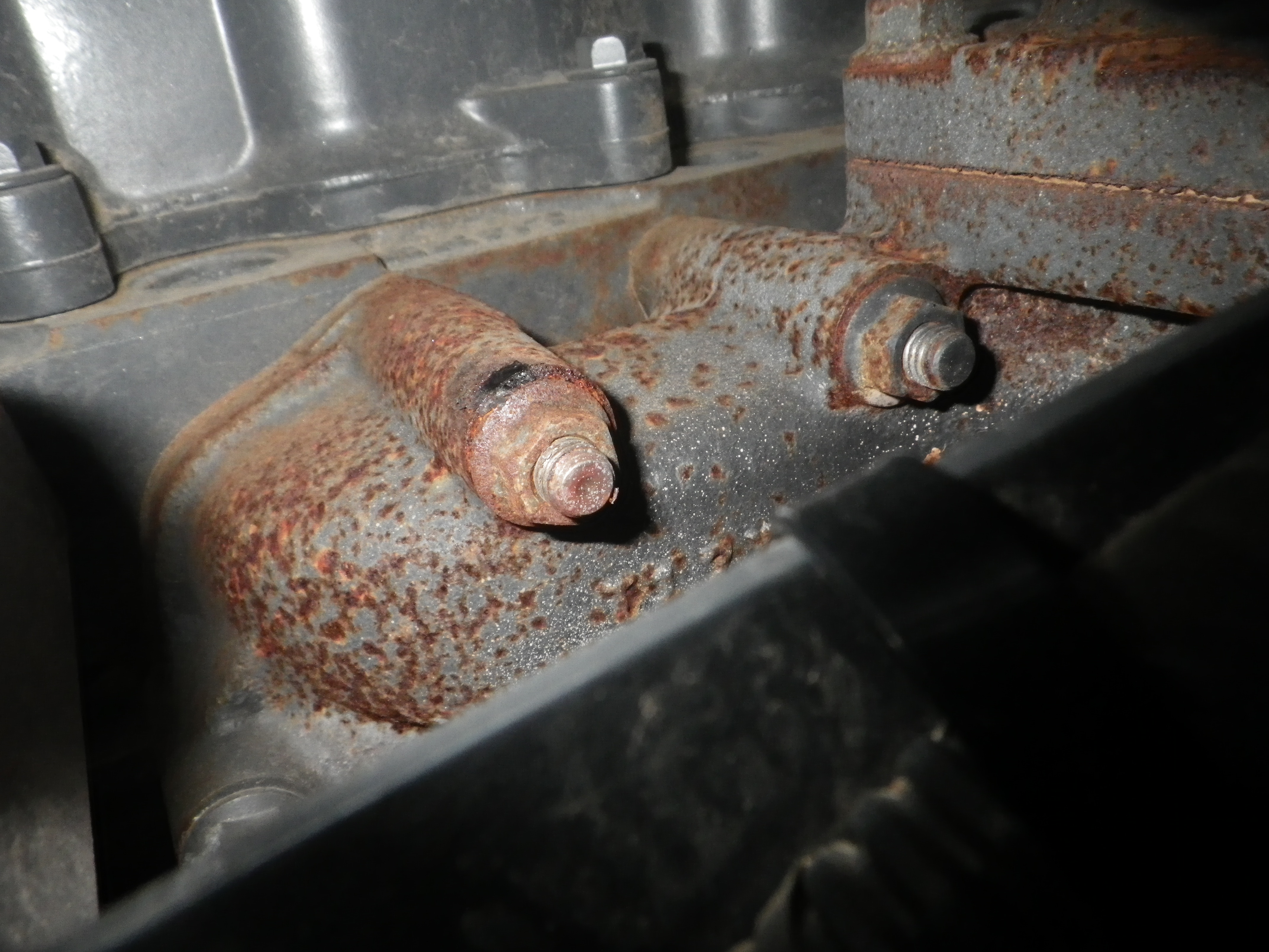

More bolts never tightened. Block heater install is easy once you remove the exhaust pipe for excellent access. Used a 8 inch lone 3/4" threaded pipe to seat the block heater collar where the frost plug was. Installed the correct length bolts for the loader frame so they bottom on the frame itself.
Now for some testing around the yard for comparison to my L3940.
Runs a 6 foot tiller like no problem whatsoever. Much nicer to operate, nice being able to exit the right side of the cab. I would own this thing, whoops did I just say that?
Post edit: Failed the road test miserably. Drove 1/2 mile up the road to see how good it is. Any incline kills this thing. Great around the yard though.

Had the same issue on my loader bolts. The lock washer hasn’t been locked down on all 3. Thought the same thing immediately as there are two lengths of bolts supplied for loader install. I want the block heater myself. Do you have any tips or the part number for it? Gonna have the dealer look this thing over since they had it for 3 months there is no excuse why it wasn’t checked over thoroughly while they installed the whole good kits!
