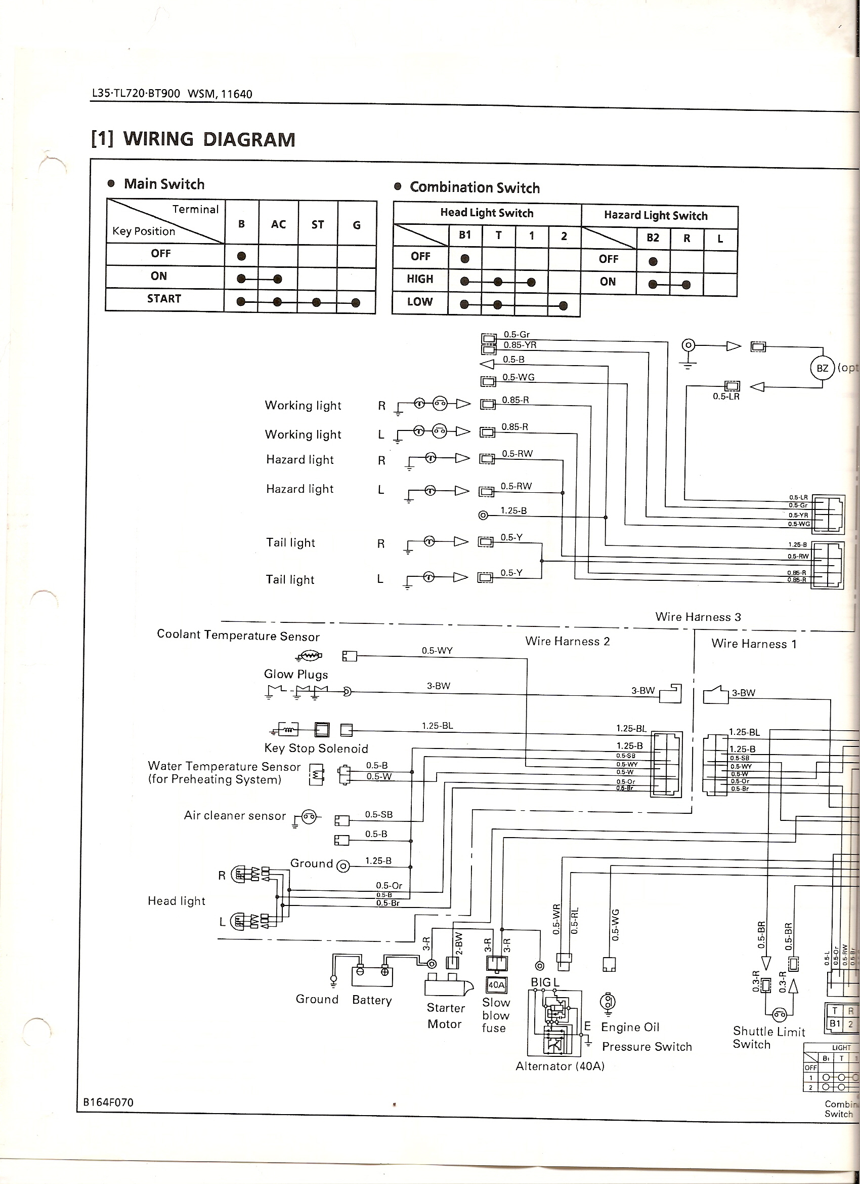

Hi
Has anybody got a copy of the wiring Diagram for the kubota L35. The back of my fuse box has just about corroded away, and when I removed it to replace it, the wires popped out and I haven't a clue where they should go in the new fuse box?
Here's hoping
Chris

   / L35 wiring Diagram needed
Thanks very much for posting the diagrams Alchemysa
Unfortunatly they bare no relationship to the L35 so I'm back to square one.
I have also discovered that while the new fuse block has come with fuses, the actual metal male connections that the cable female end would fit on are not there? in fact there is no metal in the block at all, just a lot of plastic slots.
Any suggetions
Chris

Hi Chris,
I'm on my way to work right now, but I do have a shop manual for the L35. PM me (to remind me) and I'll make a copy of the wiring diagram this afternoon/evening, sorry I can't do it right now.
   / L35 wiring Diagram needed #5
Let me know if this is good enough Chris.

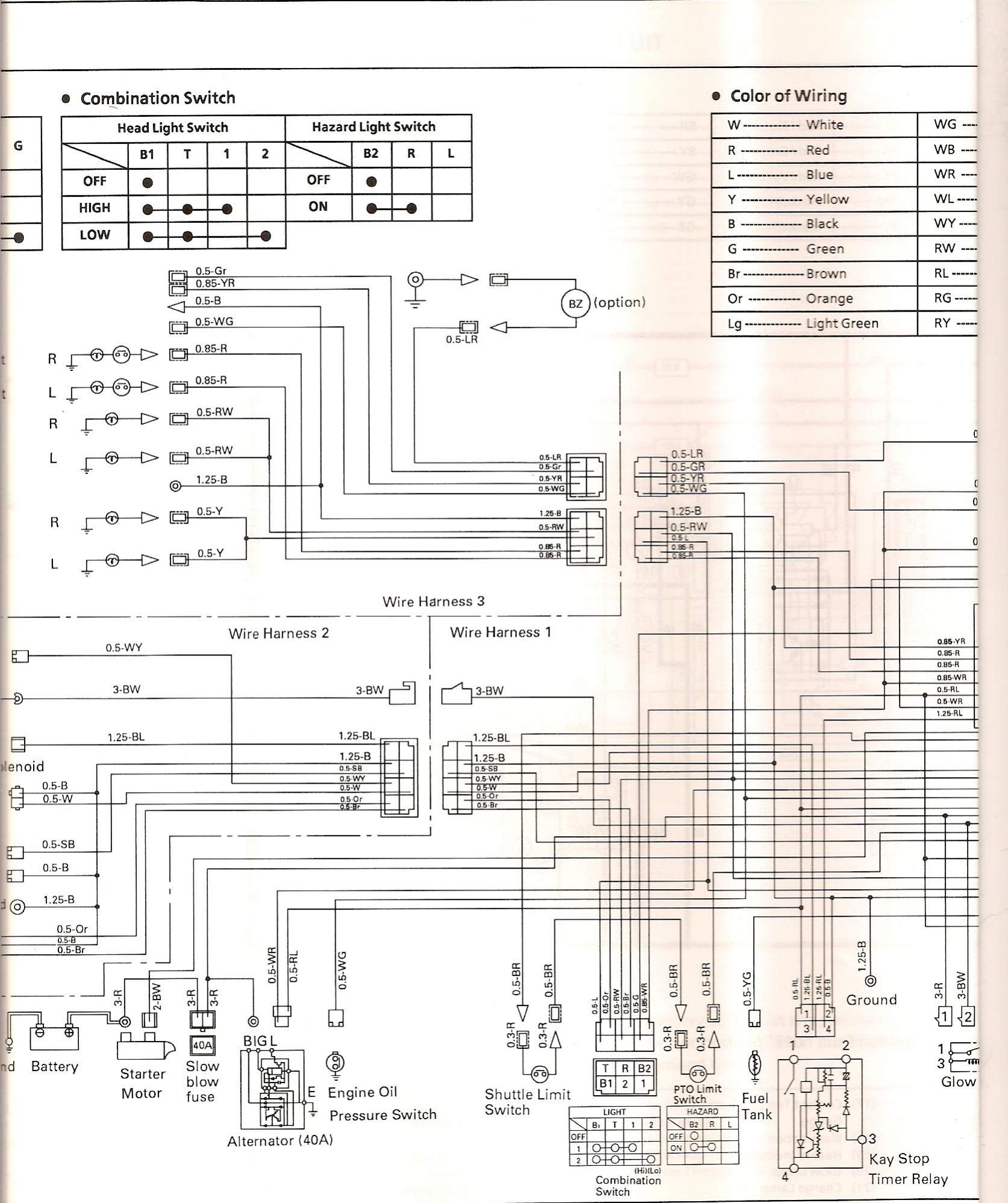

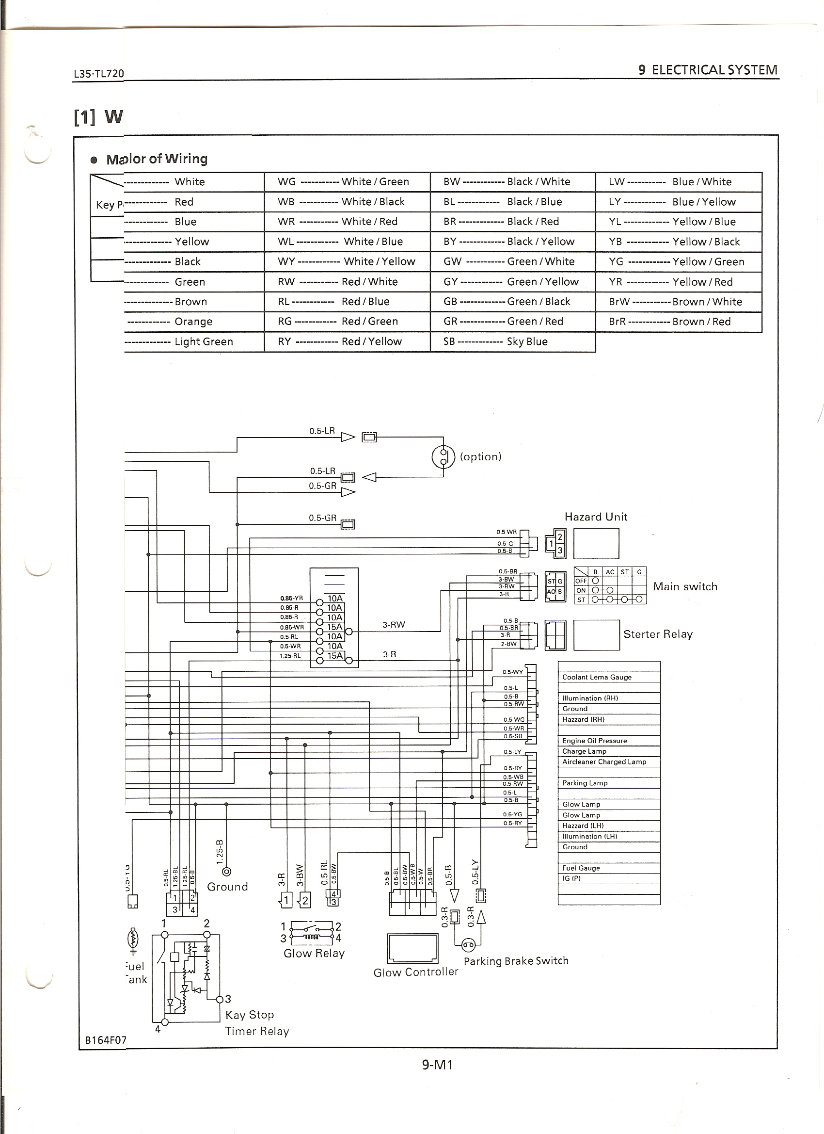

   / L35 wiring Diagram needed #6
As per your PM, here's the center section.
Hopefully this will do it for you Chris.
