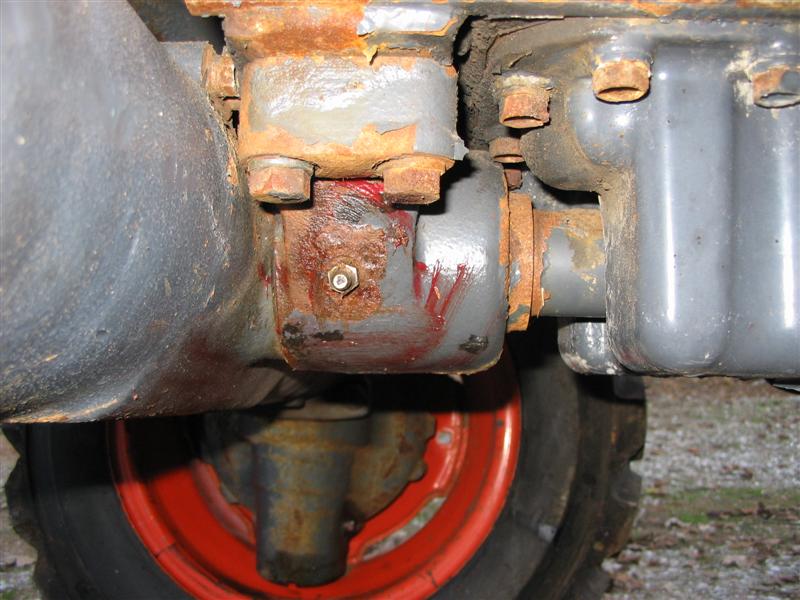

I recently bought a 2000 L35 with 1300 hours. There is a grease zirk just behind the front axle pivot point under the tractor. What does this grease? After only 5-10 "pumps" from my grease gun all the other zirks ooze grease out from someplace. I have put two tubes of grease into the one behind the front axle and havent seen any sign of grease coming out ANYWHERE.
Ive put about 1 hour on the tractor since the last grease job which is when I put so much grease in that mystery zirk. Now today the hydraulics are acting up. It sounds strange (the hydraulic pump I guess) at high RPM and the hydraulics are suddenly very jerky. Like as if it is low on fluid or the pump has gone south. The fluid level looks fine on and the fluid color look good on the dip stick. When I pulled the filter however the fluid that comes out looks awfully dark. I didnt see any grease in it that I could tell but it doesnt look like nice clean hydraulic fluid should.
Did I push grease someplace it shouldnt be? I would think if I blew out a seal with my "over" grease job on that zirk that whatever fluid that seal was holding in would leak out. I dont see anything leaking anyplace.
Maybe some (or allot) of the grease got pushed into the hydraulic system but its keeping the fluid from leaking out?
Any help would be greatly appreciated. Thanks in advance. Hutch

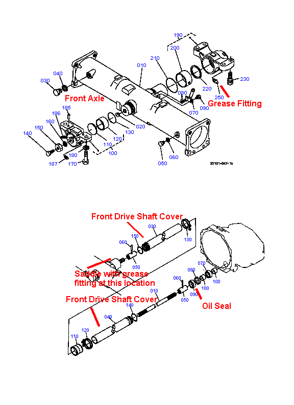

Is this a picture of the grease nipple in question? These are the only ones that come close to the location. They are used to lube the steering cylinder bushings and shouldn't have any connection to the hydraulic system.
Can you post a picture of the location you greased? Just so I don't duplicate it...
jb

Sorry been out of town, and now I am at work. I will go off shift Wed. morning and will post some pics. The Zirk is just behind the front axle and is pointing basically at the left front tire.
I dont understand this at all either. Seems like if I blew out a hydraulic seal with grease it would then leak hydraulic fluid. I'm guessin the grease is keeping it from leaking maybe? It is definately in the system though, just on the low pressure side. I am going through hydraulic filters quickly. One at one hour and another at about three hours so far (at about $30 bucks a pop). When I pulled all the (four) trans/hyd fluid drain plugs the one nearest the zirk had grease on it.
I hate to keep running the tractor with it in there but......to get to where the grease is at looks to be a MAJOR tear down. Any other sugessions?
Will post a pic soon as I can. Thanks for the replies so far. Hutch

When I came across this I could not help but see if such was possible.
After looking at the parts manual I will have to say yes that pumping enough grease into the fitting at the back side of the front axle on the L35 could find it's way into the transmission and thus into the hydraulic filters,etc.
The 4WD drive shaft is sealed so well I do believe that grease forced by pressure from a grease gun could travel up the metal covers and past the oil seal and enter into the transmission area.
The oil seal was to keep oil at no pressure in. Not to keep grease under pressure out.
Look at the picture and see if you agree.

Yes I THINK that is the grease zirk in question. Sorry I dont have a picture yet, I'm still at work (we work 3 consecutive 24's/week), I will post one as soon as I can take one and figure out how to post.
It is just behind the front axle and it LOOKS like it feeds that front driveshaft tube.
I think I was just being a frustrated ****** and I pumped that thing FULL of grease with a cordless grease gun (yes, the ones that pump at around 7500psi). So I wasnt able to FEEL the resistance increasing before it pushed past the seal. I was just frustrated and like an IDIOT I kept my "finger on the trigger" waiting to see where the grease was coming out. Which of course I couldnt see because it was coming out in my transmission case.
Sure appreciate the replies.........Hutch

Happy Thanksgiving all,
Here is a picture of the grease zirk behind the front axle on my L35 that I overgreased (ALLOT). I figure the grease traveled down the front driveline tube, through a low pressure oil seal (as was mentioned) and right into my hydraulic system. AAAAAARRRRRRRGGGGGGGHHHHHHHH!!!!!!!!!
Hutch
