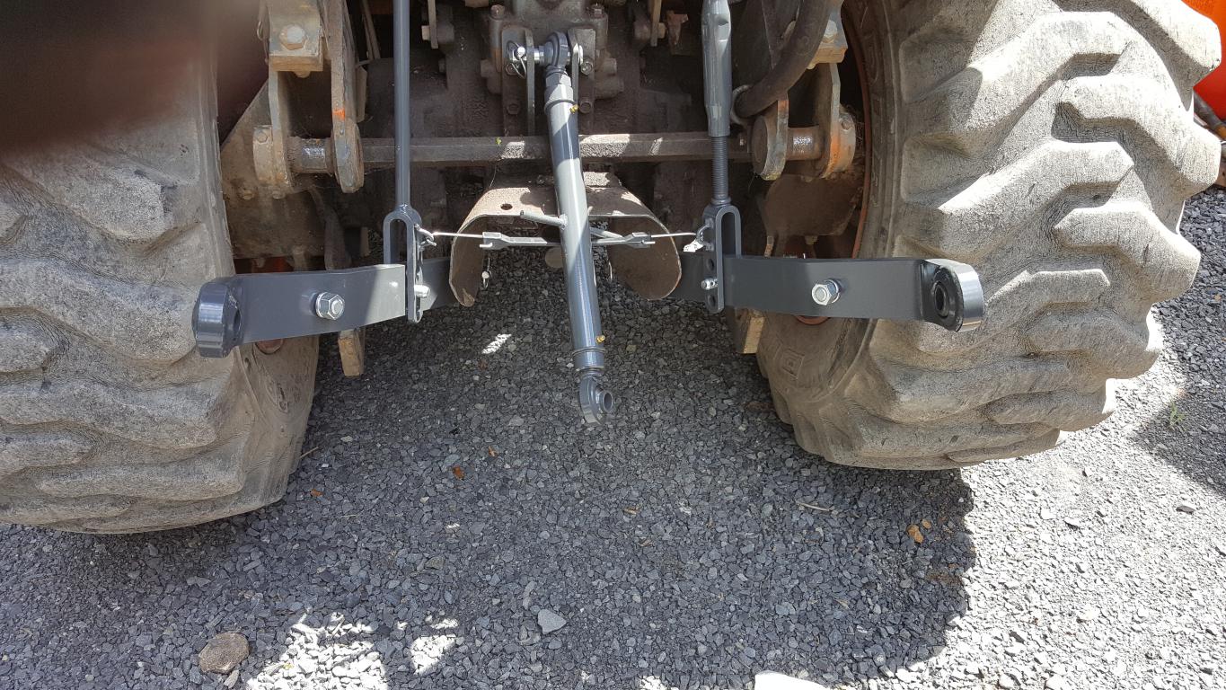

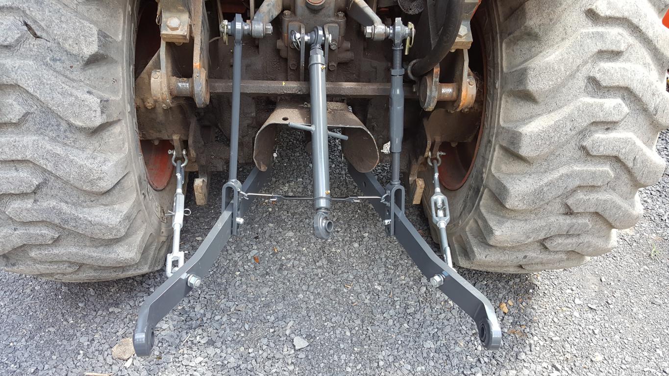

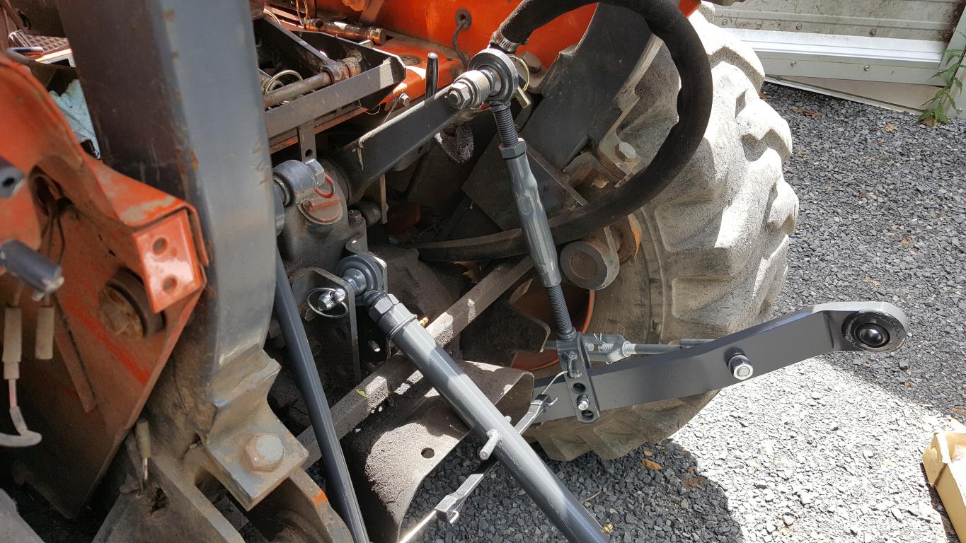

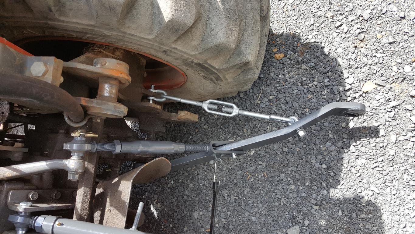

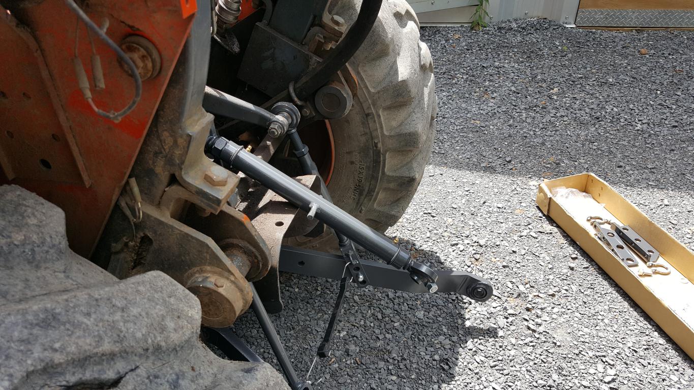

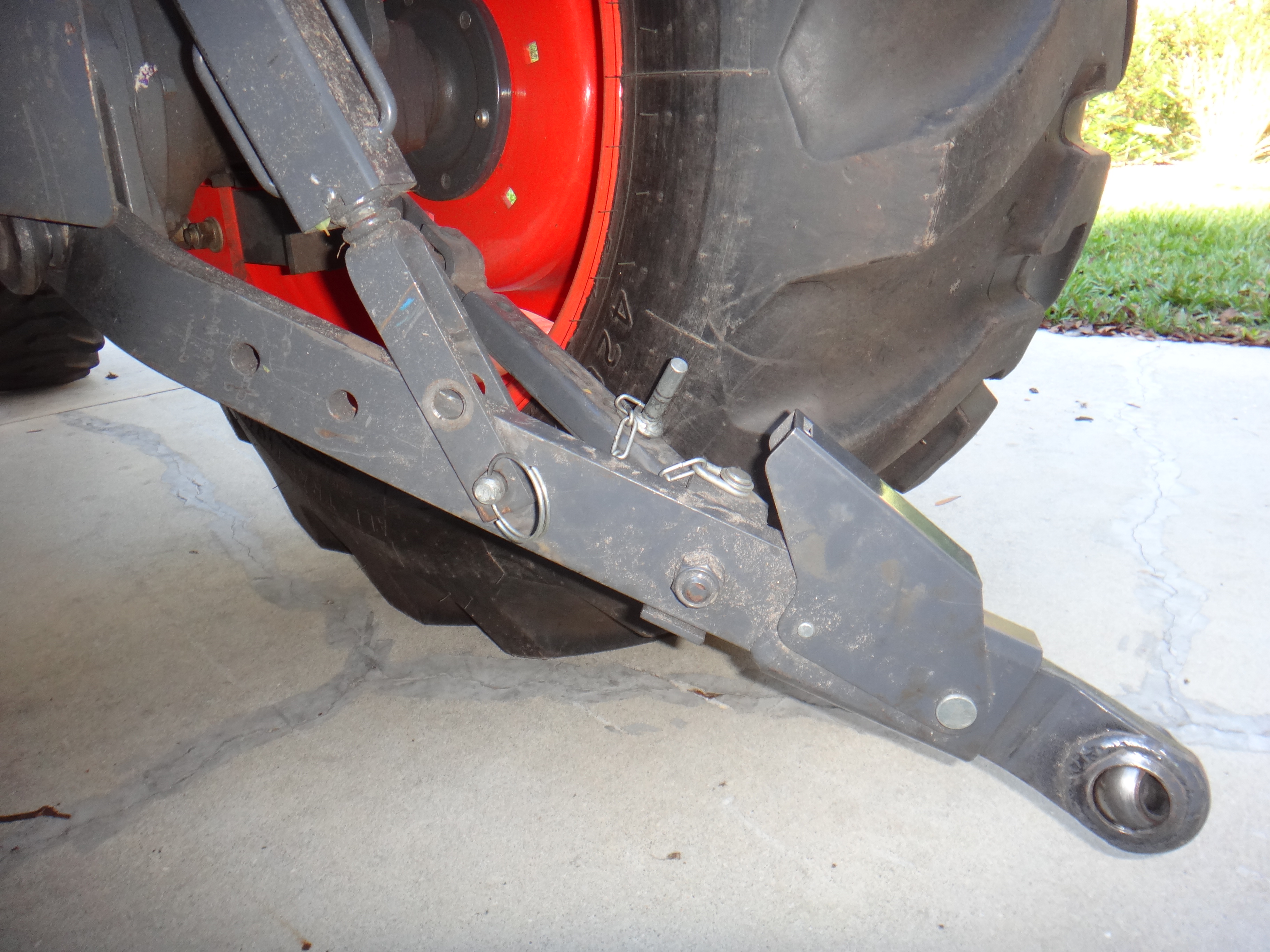

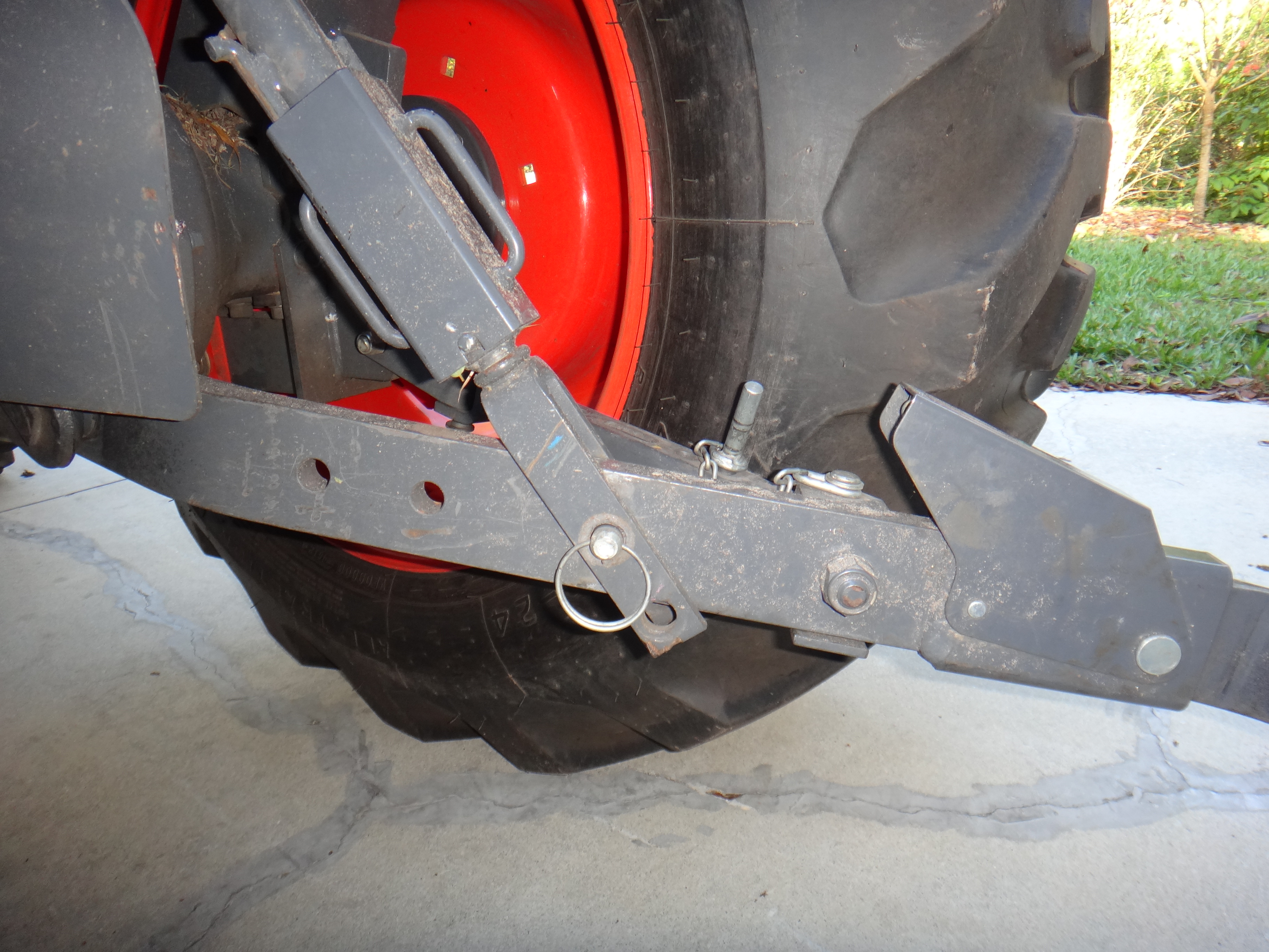

Answering my own question, in case this info will be of use to others.
I purchased the L39 3 point hitch kit from Kubota.
As far as I can tell it fits the L35 perfectly.
The alignment of all of the mounting points looks good.
The quality of the parts is far better than the aftermarket setup I was using - the arms are thicker, and in general the setup feels nice and solid.
The kits include all the hardware - pins, lock pins, even the brackets that attach to the gearbox (which are already on a L35)
The attached photos show a couple of views, with the arms up and down.
Side view Up.jpgRear_Up.jpgDetail one side.jpgSide view Down.jpgRear_Down.jpg

Photo #2, Photo #5
I notice L35 has three holes in the Lifting Rod stirrups on both left and right side. You have adjustment pins in middle holes. I suggest Ring Cotters to secure those pins. Brush or varying pressure on the Lower Links will pull one or the other out, sooner or later. (Nothing is securing the pins in the photos.)
Grand Ls have three holes on the left side and two holes on the right side.
With Grand Ls the top hole is the 'normal' pin position. May or may not be the same on your L35.
If your implements position too high or too low, move the pin. HIGHER HOLE = HIGHER LIFT. See photos.
Nice tractor. I am jealous.
Do not push in reverse with those turnbuckle stabilizers.
Amply strong drawing implements forward. No support pushing in reverse when turnbuckles are slack.
Easily deformed. (Ask me how I know.)

Thanks for feedback. The photos were taken when I first assembled things; your point about the pins has been taken care of.
Your comments bout pushing are interesting; I have turned a set of aftermarket lift arms into pretzels pushing, but didn't hurt the stabilizers. The L39 lift arms are much more robust and I have been back blading without anything looking even slightly stressed.
The L35 is so nice with the backhoe that attaches to the frame - a nice size and really robust.
