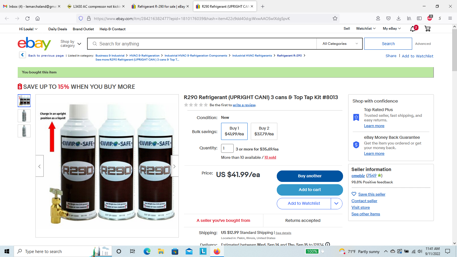

I believe I paid 25 bucks per can for dried propane last time I bought in (early this year) It's quite expensive but compatible with all refrigerants, I believe even the old R11-12 as well and no seal issues either like when retrofitting from 11-12 to 134.
You never want to valve off BOTH heater lines, you are only stopping the flow, so either line works but not both.
/ L3430 AC compressor not kicking in #22
Nothing is cheap TODAY due to the China Flu & USA politicians that like to give $$$$$$$$ AWAY. How much does dry propane cost per ounce?
Many yrs ago a local shade tree mechanic was installing regular propane in auto/tractor AC systems. Somehow local law enforcement office got notified of him installing propane in AC systems & told him to cease & desist!
Regular heating grade propane is no good. Has to be dried (moisture free and pure propane) devoid of anything else. I believe 'regular' propane has other stuff in it like the chemical that makes it stink for one.

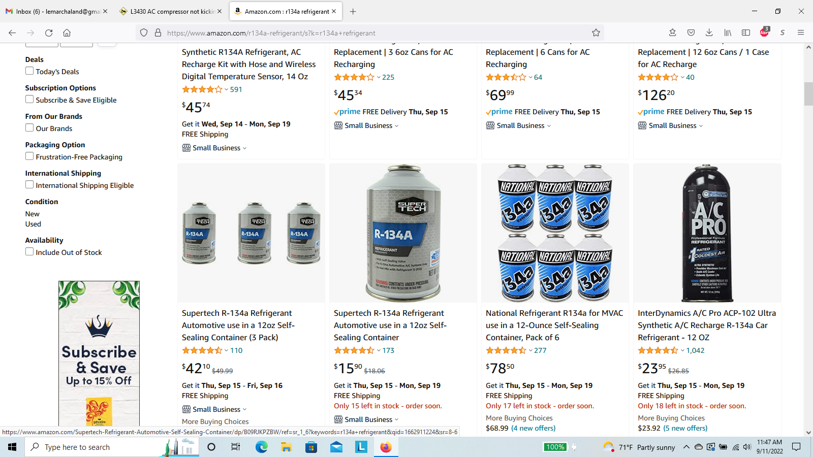

Kinda sounds like a refrigerant loss. Rather than spend $$$$ on set of gauges, many parts houses & Wally World carry those 16 oz refrigerant cans with the hose & gauge that fit ONLY on the suction (low pressure) side. Before you dispense any refrigerant notice the reading on the gauge. Not real accurate but will show if you do have a leak. Look for oily spots around hose ends, or where they might have rubbed a hole. Hoses usually are the culprit, & leak needs to be repaired before any refrigerant is added. If you are low, & can’t find the leak, parts houses also sell a kit, (yellow dye mixed with the refrigerant) making the leak easier to spot. Also DO NOT mix refrigerants, make sure of what you have; more than likely R134. If your system is completely evacuated (like a busted hose), after the repair you can find the capacity of your ac system & add exactly that amount back, without gauges. I’ve done it, but I’m a lot more comfortable using the gauges. You will probably also have to make a jumper wire to compressor to get it to run until the pressures are close enough that the high / low switches allow normal operation.
