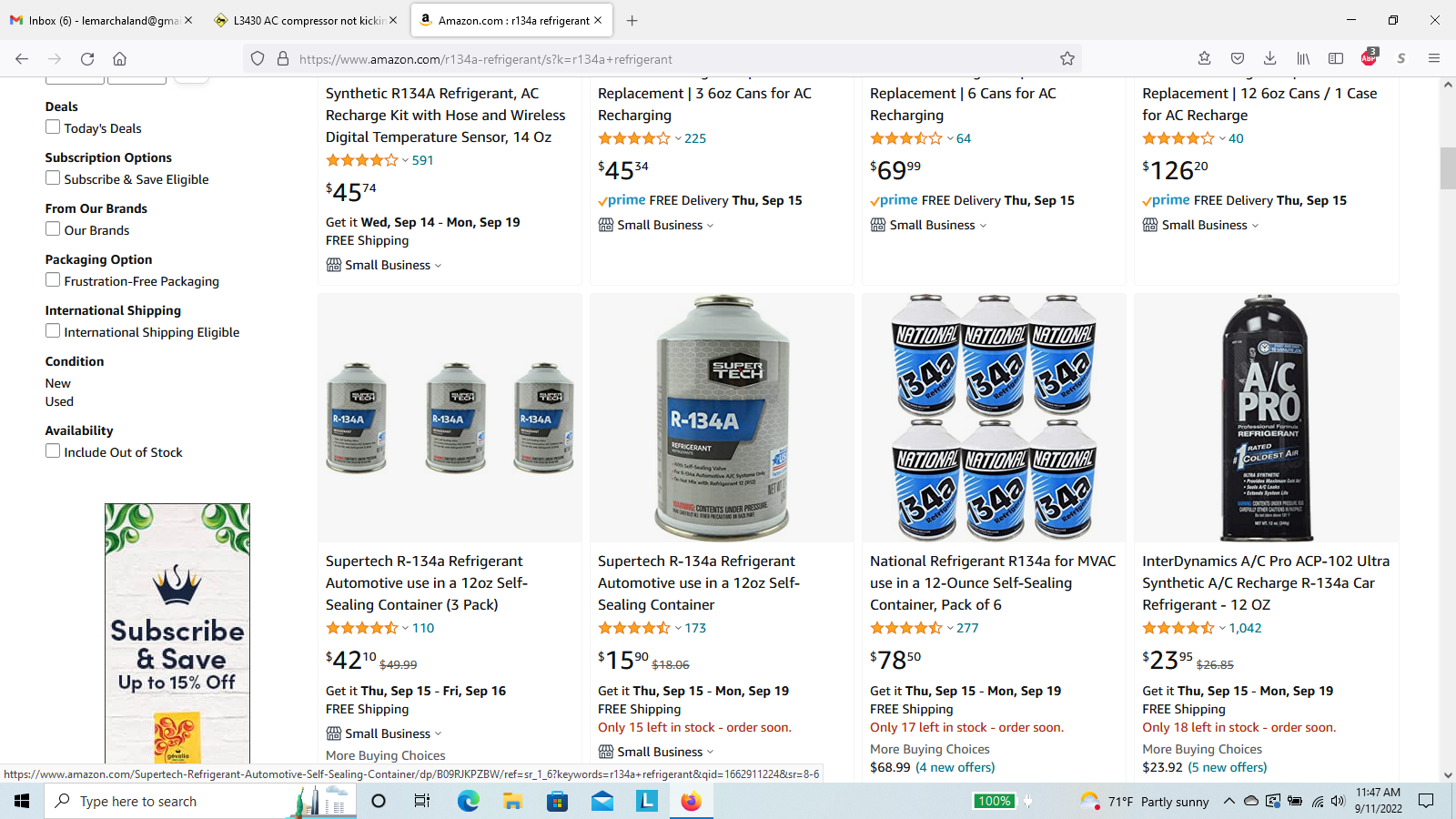

Without the proper refrigeration tools, diagnosing and fixing any ac (tractor, house or car) is a total crapshoot and stay away from those 'fixes in a can products' as you can overcharge a system and destroy it easily. All refrigeration systems take a very specific amount of refrigerant so guessing don't count and could cost you big bucks in the end.

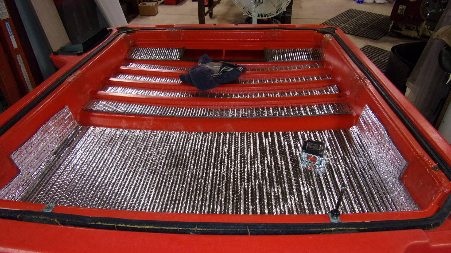

I did a thread a few years back under Kubota owning and operating, detailing how to insulate the non insulated roof on Kubota tractors. Your blow molded roof is a heat magnet in the sun and really puts a strain on the AC unit trying to cool down the cab. I insulated mine with foil-bubble-foil sheet (available at any box store) and glued it to the underside of the roof with 3M spray on adhesive. Makes a huge difference on a hot sunny day when the sun is beating down on the roof. I've included a picture with the insulation installed.

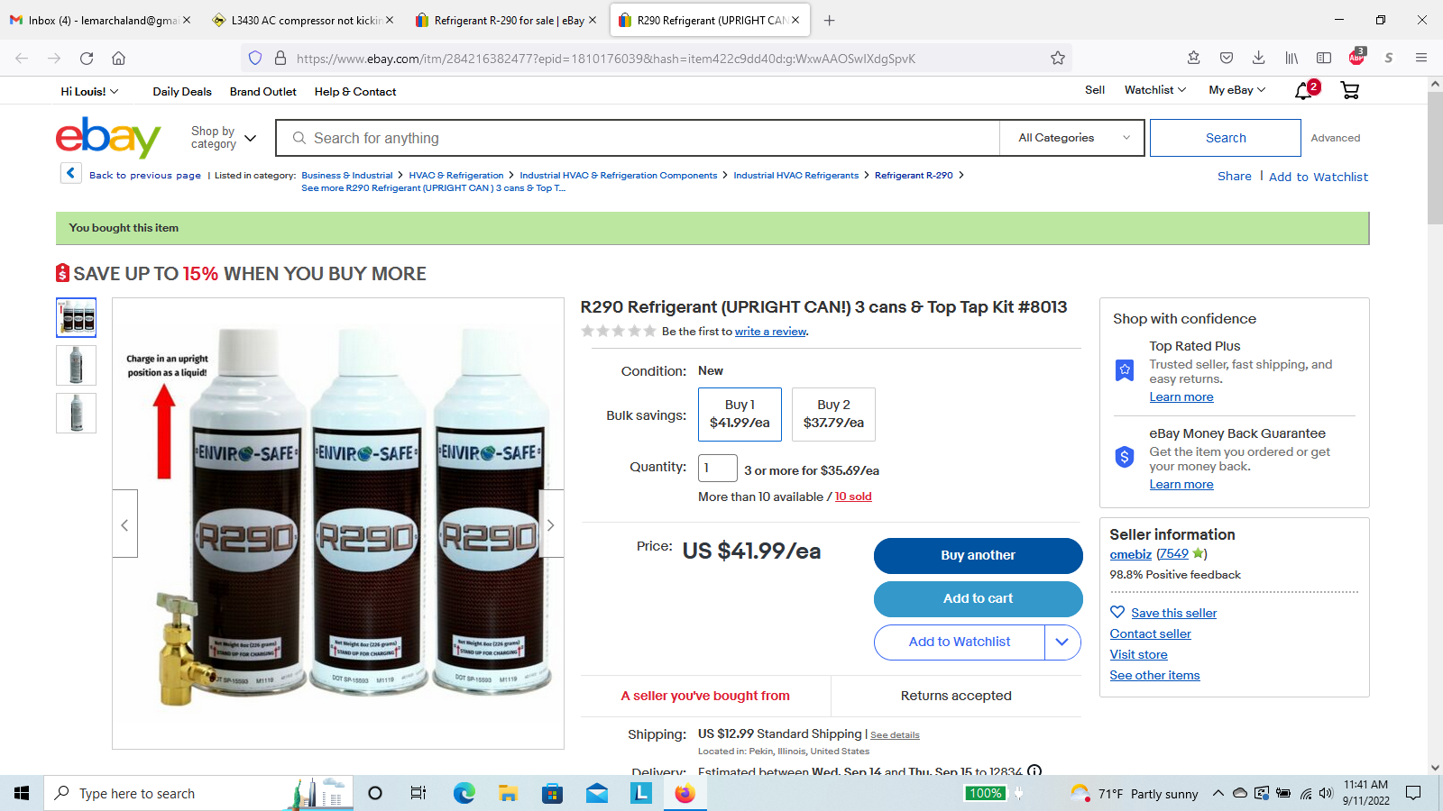

Jim... I've switched to dried propane as it's compatible with all modern refrigerants and it provides a much better thermal transfer. Not cheap and hard to find however.
/ L3430 AC compressor not kicking in #16
Nothing is cheap TODAY due to the China Flu & USA politicians that like to give $$$$$$$$ AWAY. How much does dry propane cost per ounce?
Many yrs ago a local shade tree mechanic was installing regular propane in auto/tractor AC systems. Somehow local law enforcement office got notified of him installing propane in AC systems & told him to cease & desist!
I would have to wonder under what authority they had to tell him to cease and desist.
Propane is a good effective coolant gas.
