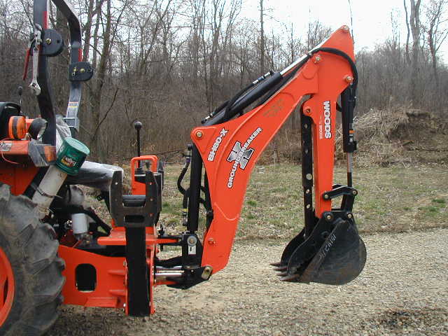

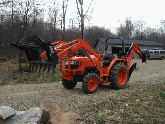

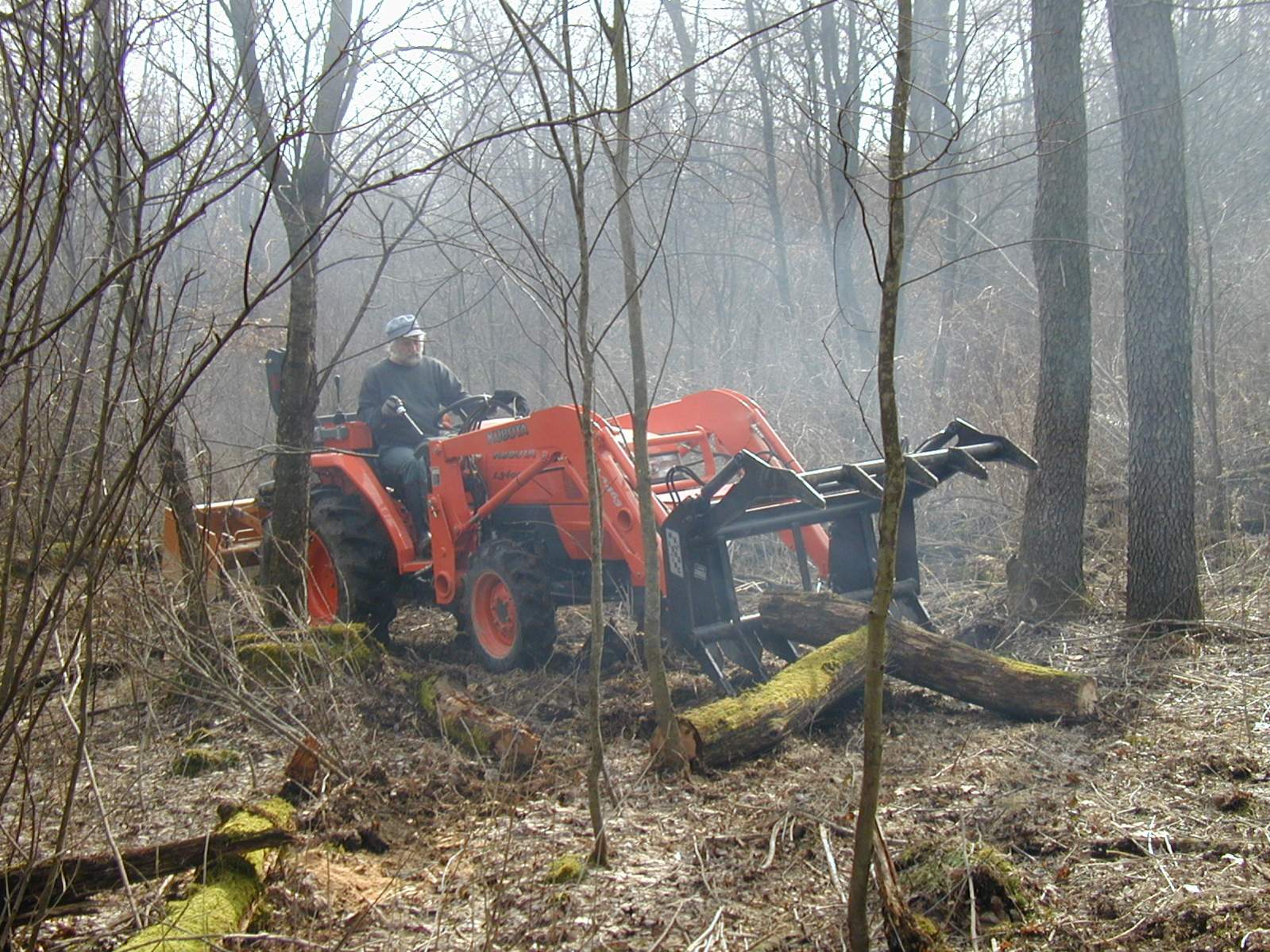

Here's my L3400 with WR Long grapple and Woods BX 80 hoe.

jw5875, Did you go with the WR Long electric over hydraulic or the diverter for the controls on the grapple?
Also on a side note? How did you plumb the BH? It looks like you have a second tank back there for it.
/ L3400 Grapple? #12
Electric over hydraulic valve that comes with the grapple kit. Back Hoe has PTO driven pump for self contained unit, no "Plumbing" into the tractor hydraulics.

Jw5875,
Im curious, WR Long makes two different light duty grapples. What made you chose this style over the other one (OBG 2) with the longer tines on the bottom? Im getting ready to order mine this week but unsure if Id be more happy with the OBG 2 or the RBG 2 (the one you have). My land is full of rocks, limbs and logs from timbering. I think Id perfer the OBG 2 as it would also allow me to lay items on the bottom tines and move around the property. Can you roll yours back and lay items on the tines? Like logs, bales of hay, chains, chain saw...ect.
