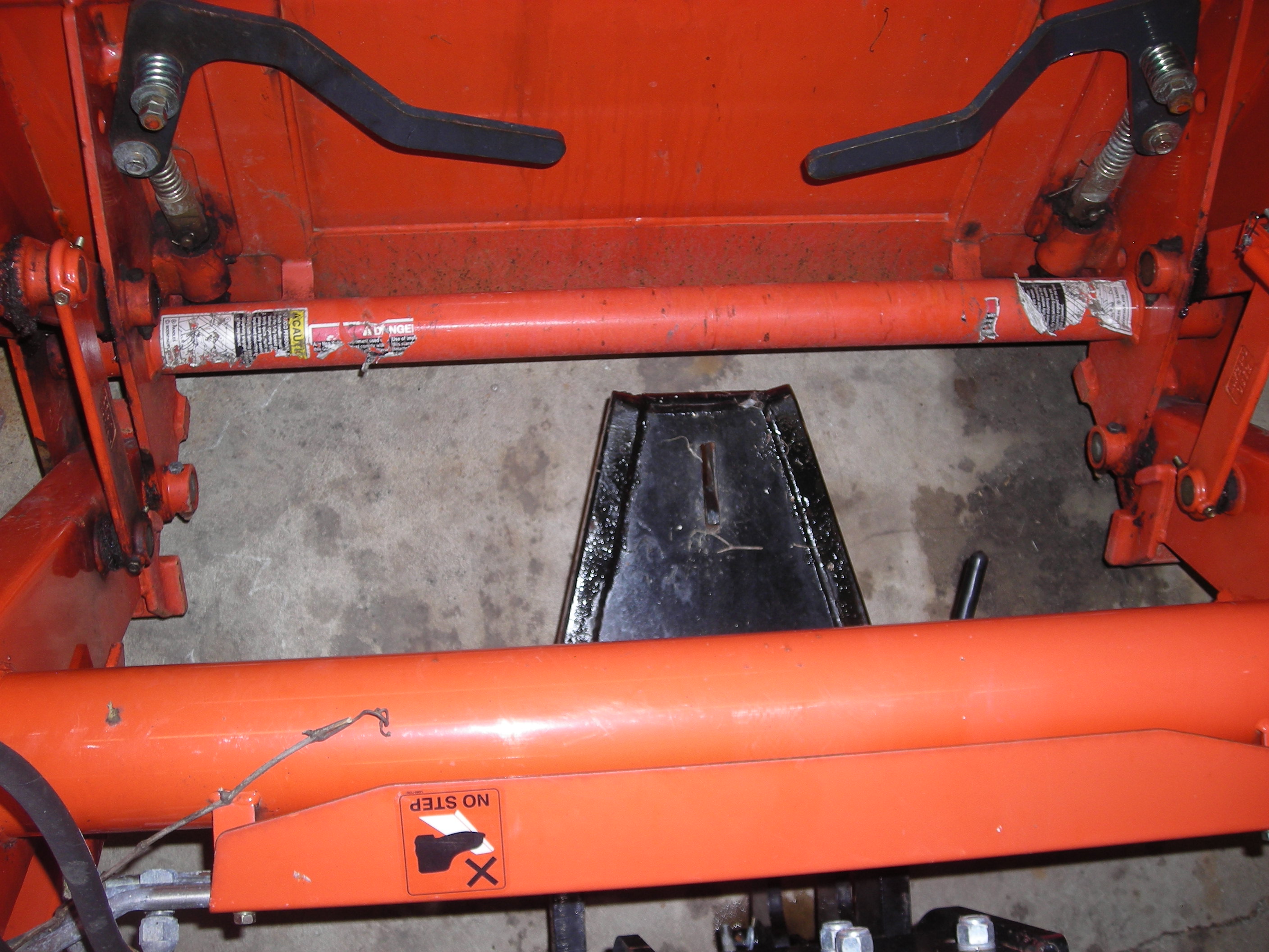

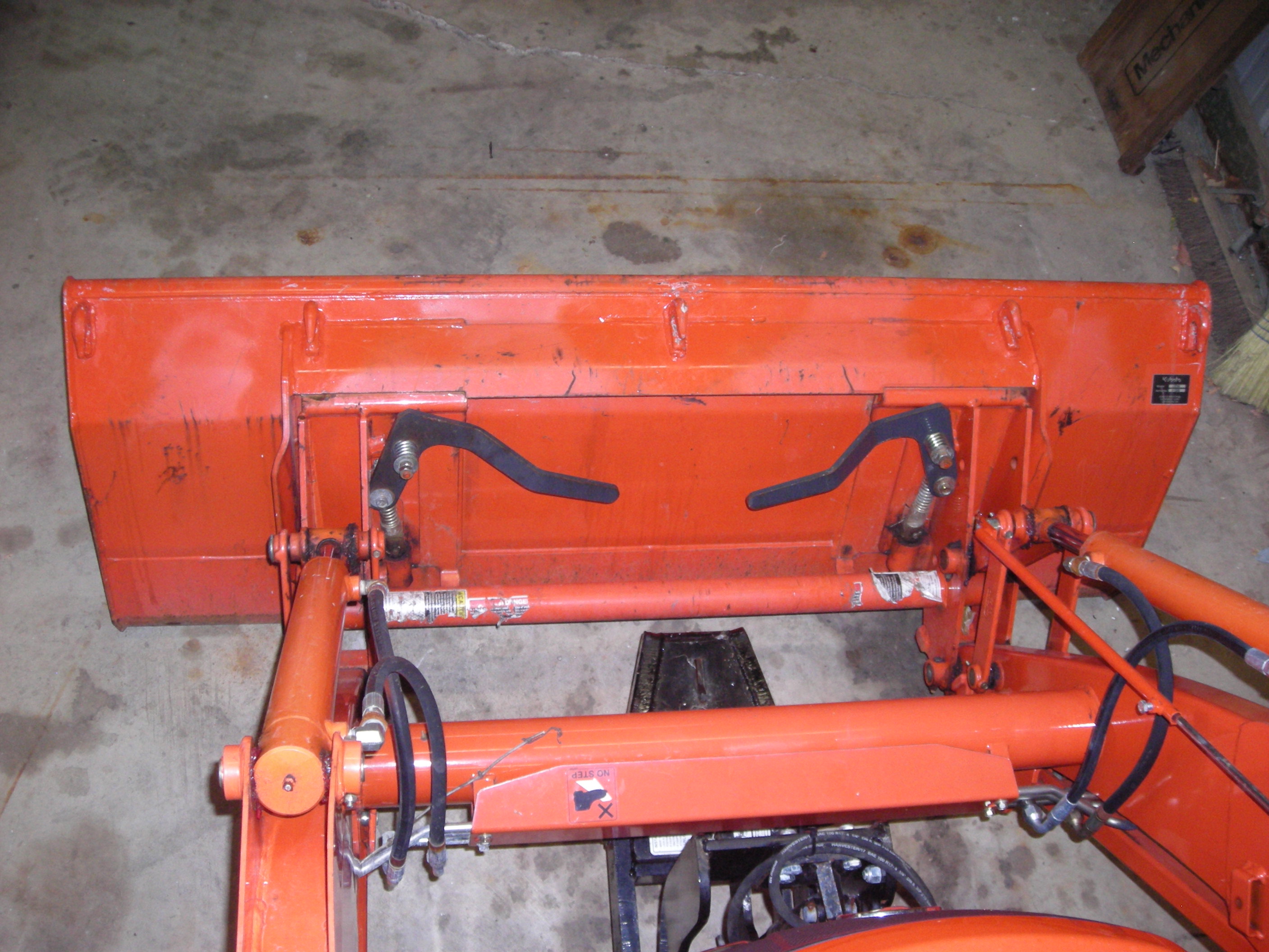

The sub frame for Kubota's front mount blower can stay on if you want to remove the blower to use the fel.
I don't think that is the case for the LA724. I have minor interference with mine, but if careful, I can get some FEL work done with sub-frame on. Philip.
