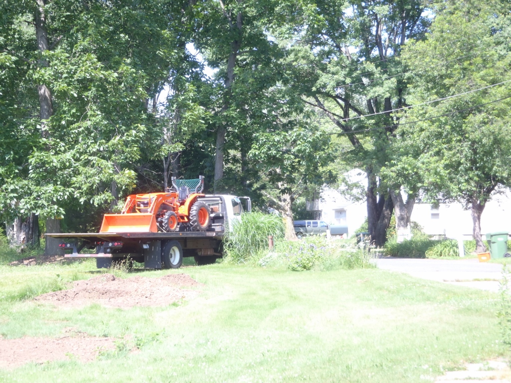

Dealer came & took my L3240 away to install a BH92 hoe.
But now there is a question about which mounting kit to order.
Apparently the one they got (BH4997) "doesn't fit up right".
So it sits at the dealer and here sit I, without my #1 go-to tractor.
All the while chores are not getting done.
And I miss it.

Anyone have a BH92 on their L3240?
If so, which mounting kit did they install?
Thanks in advance for your help!

Will a BH92 fit your L3240?
On TractorHouse, the only L3240 had a BH75 on it.
If you build a 33 hp L on Kubota's site, it will show a 7.7 BH. A BH77.

Unfortunately I don't have the part numbers you're looking for but I can assure you that it does fit on a L3240
If you had a cab you would need two mounts the one on the tractor is the one you need. The one I have on the backhoe is for a cab, sets it back a little further to clear the cab.
When you do get it back at least you won't have to live with the cab adaptor. Not thats it's a big deal just doesn't look as neat and tidy. The dealer can't figure out the right part numbers? Have him check with Ahearn in Spencer Mass for the right number.

It will definitely fit, kcender (tbn member) had one locally but has since sold it. I doubt he'd know which adapter was used, but you could try a pm.

Sorry,Baby Grand,but I don't think I will be much help to you.My L3240 was an '09 with a BH90 backhoe.It is the older model of backhoe with a straight boom.The BH92 backhoe was available for the tractor but it was more money.Good luck with the backhoe.
