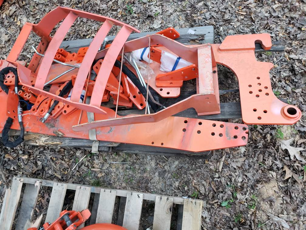

Does anyone have a picture or installation manual for the BH92 subframe on a early model GL3240 open station?
I recently bought a number of parts from a Kubota dealer that was closing down, one of the things I got was a NOS BH92 subframe with an assortment of brackets for the GL40 series tractors.
Using parts diagrams I believe the brackets I need are from the B81003 mount kit, unfortunately I haven't been able to find a cross reference to the wholgoods mounting kit number, which is BH4941 for my model.
I haven't been able to find any good pictures of the subrame installed from image searches so far.
I was also able to get a set of the cab model extensions which will save me a lot of fab time if I can't find an affordable BH92 and end up going with an aftermarket BH

Attached below is the BH92 install instructions broken up into 4 parts. It has subframe install instructions in it too:
  • BH92_Install-1.pdf
  • BH92_Install-2.pdf
  • BH92_Install-3.pdf
  • BH92_Install-4.pdf
   / L3240 Backhoe subframe pics/install help
Thank you very much, this gives me the info I needed.
