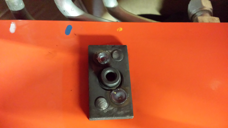

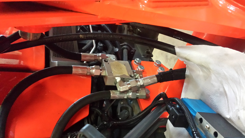

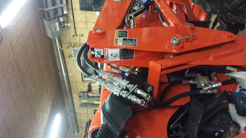

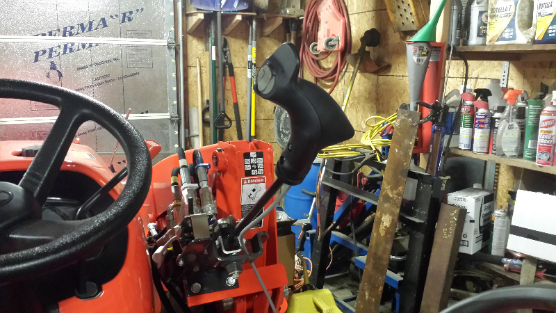

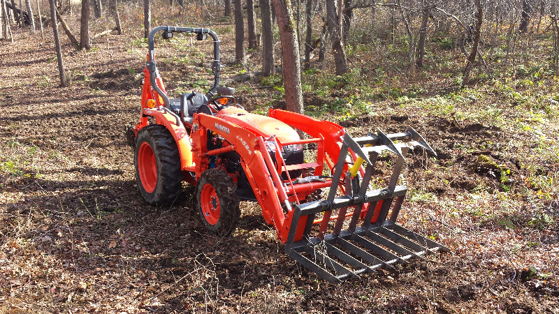

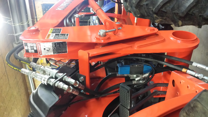

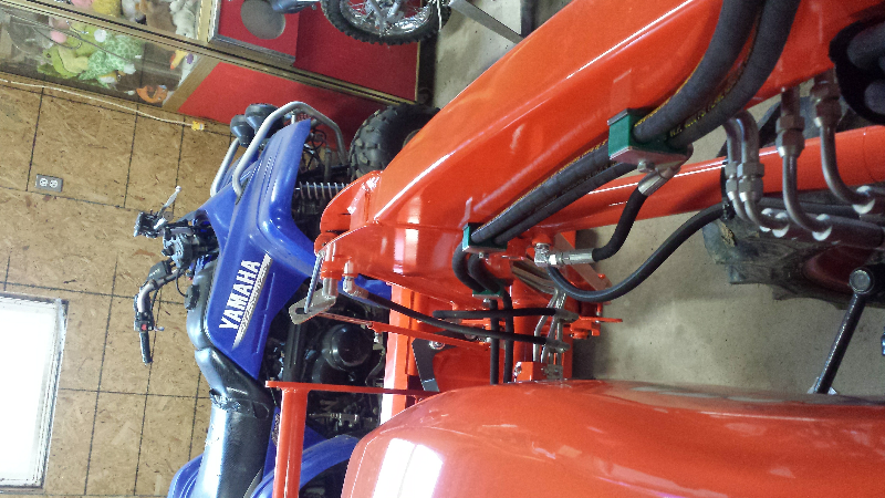

I recently built a 3rd function for my L3200 in attempt to save a bit of money over the wr long kit. I have right around $450 in it including the John deere joystick. Everything was ordered from surplus center except for a couple relays and wiring. The hoses from surplus center are great quality and are marked made in the usa. If anyone uses the John deere joystick be sure to use relays to activate the valve. I had to replace the switches and found out they are only rated for 0.1 amps and the valve takes around 3 amps. I have about 20 to 25 hours of use on it with the grapple bucket I built with no problems.

I think installing a 3rd is about the same as a diverter. Instead of breaking into the curl you break into the power beyond. Only difference being is one extra switch to hook up. I am certainly no hydraulics expert this is my second hydraulic project with the first one being a simple tubing bender. So I'm pretty new with all this.
   / L3200 3rd function build #9
A diverter is just 2 lines. Break into existing lines and run the two new ones to the new cylinder.
PB would require the PB cartridge, PB supply line, and a return line plumbed in somewhere.
Not a whole lot harder, but does require more stuff.
