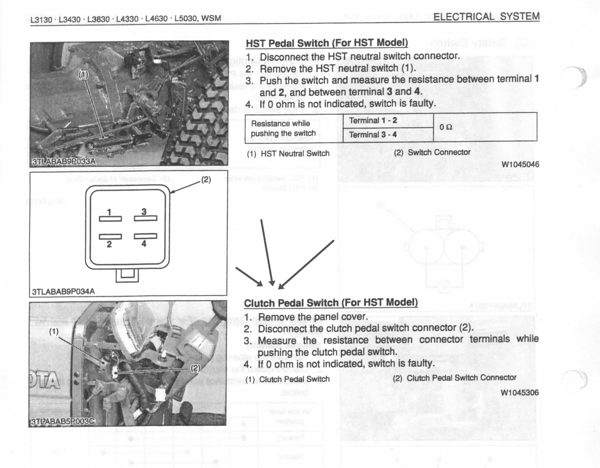

My l3130 isn't kicking over although the electrical system is on, dash is on, glow pug switch clicks over and the pto is disengaged. I noticed one time when I jiggled the hst pedal it kicked over for a second and then nothing. I'm pretty sure the problem must be with the hst pedal switch but I can't seem to find the pedal switch for the life of me. Can anyone make a suggestion? The tractor is a 2004 L3130HST.

First of all, Pat, shell out the hundred bucks for the manual.... lol...:)
Seriously, on page 9-s36.....
Clutch Pedal Switch (for HST Model)
1. Remove the Panel Cover.
2. Disconnect the clutch pedal switch connector (2).
3. Measure the resistance between connector terminals while pushing the clutch pedal switch.
4. If 0 ohm is not indicated, switch is faulty.
If the attached picture didn't uploade correctly, please let me know.... zcowboy001@yahoo.com

Thank you so much Zcowboy. The manual certainly would be beneficial and I'll order up a copy.
Problem solved!
I found that the hst pedal connects via a linkage thru the transmission to the left side of the tractor where a electro-mechanical switch is activated. I loosened the lock nut on the switch and threaded it in closer to the actuator and it now works!
Thanks so much for your help!
