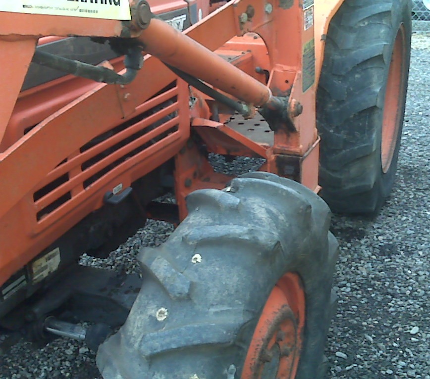

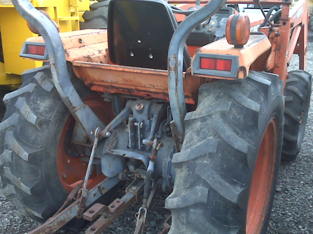

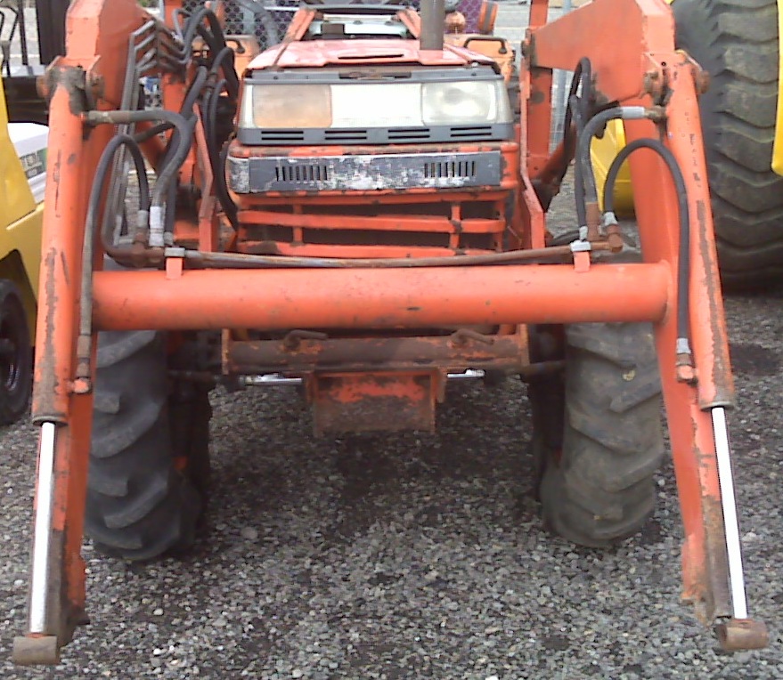

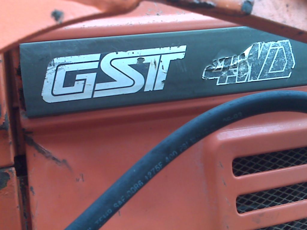

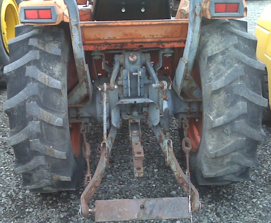

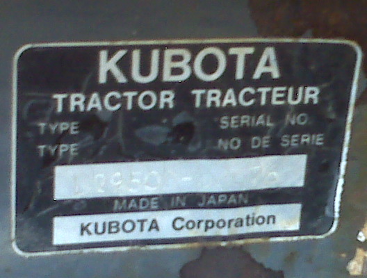

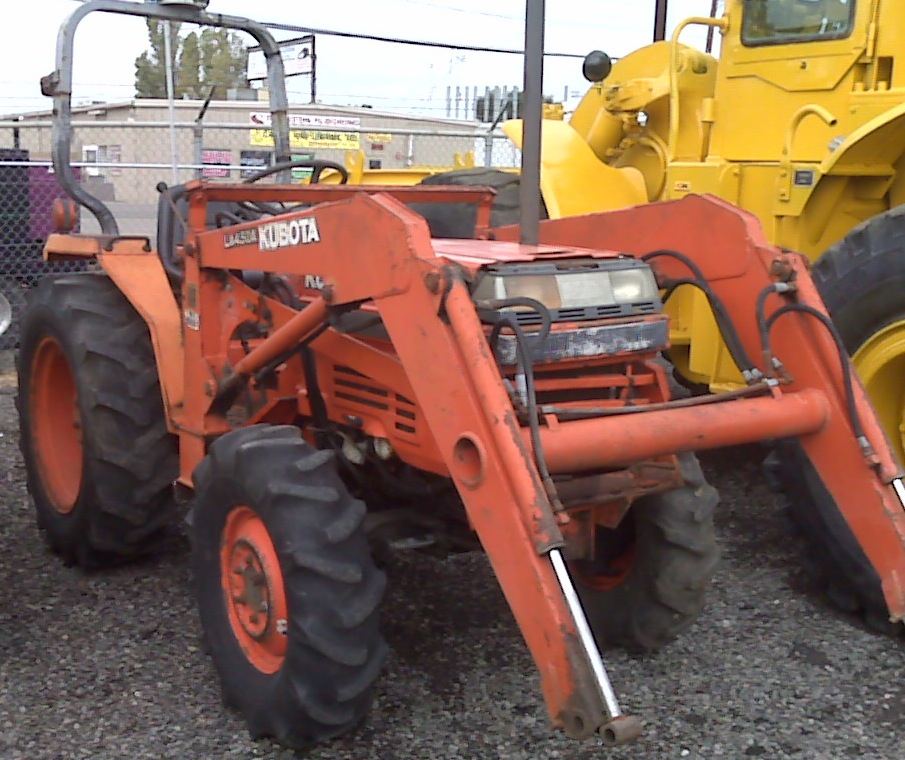

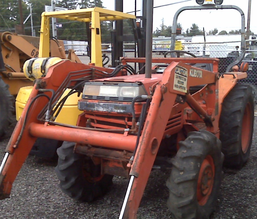

I am a total newbie looking for a tractor for my 5-acre horse property, main uses will be moving manure/compost, tilling and some grading/small scale earth moving. I'm looking at a L2950 GST, have specs and pics and would appreciate this group's feedback on whether this is the right kind of machine for my needs and if this is a good deal....thanks!
Here's what the seller says:
"It has a 4 cyl Kubota engine & it'll host any kind of implement, such as a rototiller, flare mower, box scraper, auger etc etc. It has a front loader bucket too for lifting hay, dirt, compost, clean out horse stalls etc. It has new tires and is 4x4. $75oo, that includes a brand new front bucket that isn't on it in the photos & either a box scraper or a rototiller.
For $8ooo I can give you both the rototiller & the box scraper. It was recently serviced in June & is a pretty expensive machine w/ low hours too, you'd be getting a great deal.
3500 hours"
I feel like that's a lot of hours but the price is right :) However I don't want to end up with something that can't do what I need it to do and/or breaks down constantly. What do the experts say/think??
Thanks!!

3500 hours!!!!! I'd never do it but I always buy new. 0% for 60 months returns next week and even longer for a slight fee. Never make your first tractor one that will sour you on tractors. If you have to do a major repair the dollar amounts will be in the thousands and you'll still have a wore out tractor. Also, for FEL work I wouldn't ever have anything but a HST, I know, here comes the old country guys that don't like color TV or automatics that tear up according to people that don't own them. People that do don't seem to have the tear up problem. Most newer tractors that are sold are HST's, ask a dealer, because that's what most people want. Rare to find someone that will "go back to gears" after having an HST. Not saying there aren't any maybet one or 2 but for everyone that prefers gears there are 99 that prefer HST. Ask a dealer that sells them. The gauntlet is thrown so get ready.

Tractor definitely, more stability and visibility. There are plenty of used Kubotas out there w/less than 500 hrs. They are just broke in at that point! I got both of mine w/200+ hrs. If you plan on using the loader a lot get a little bigger tractor.
