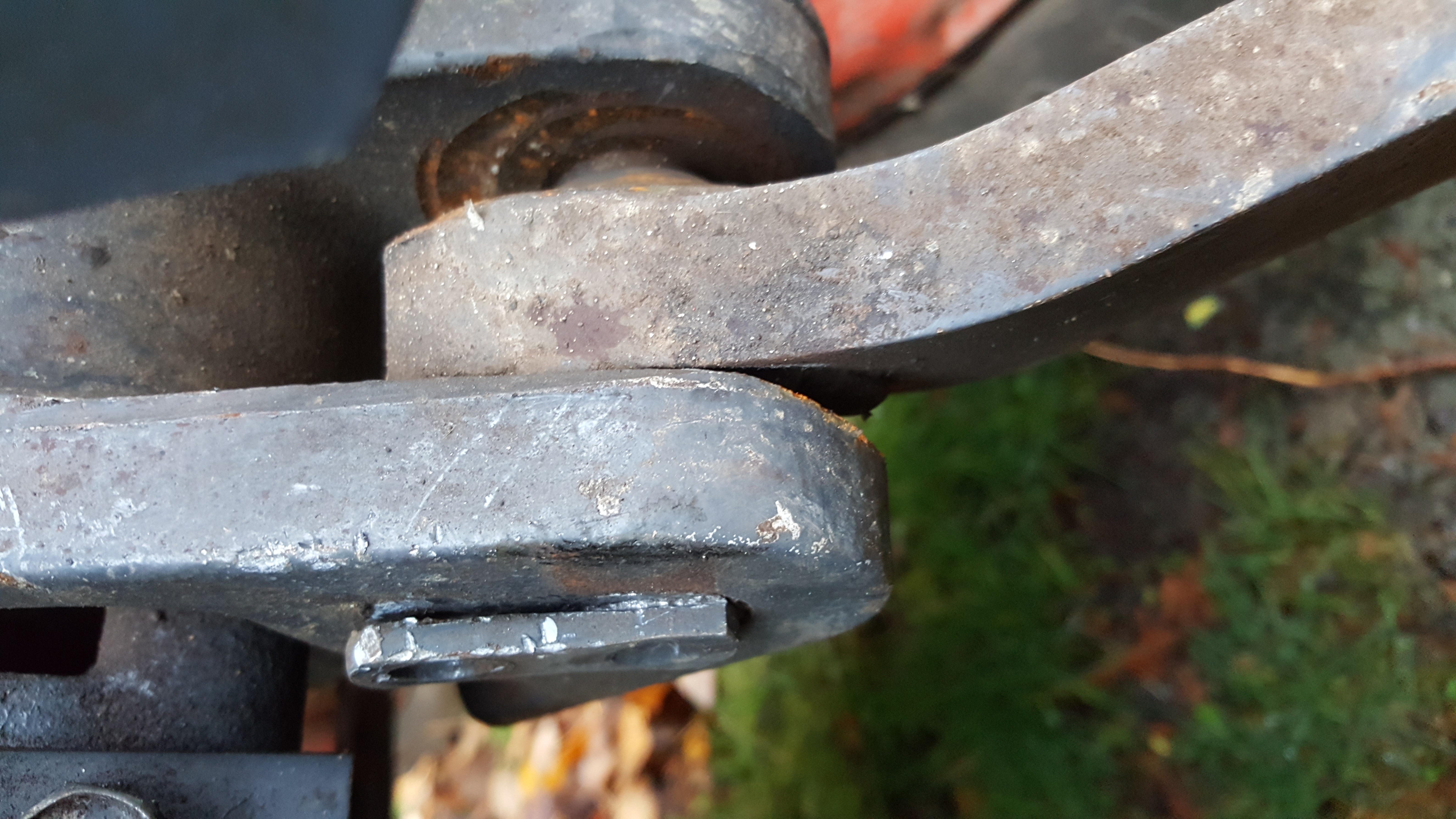

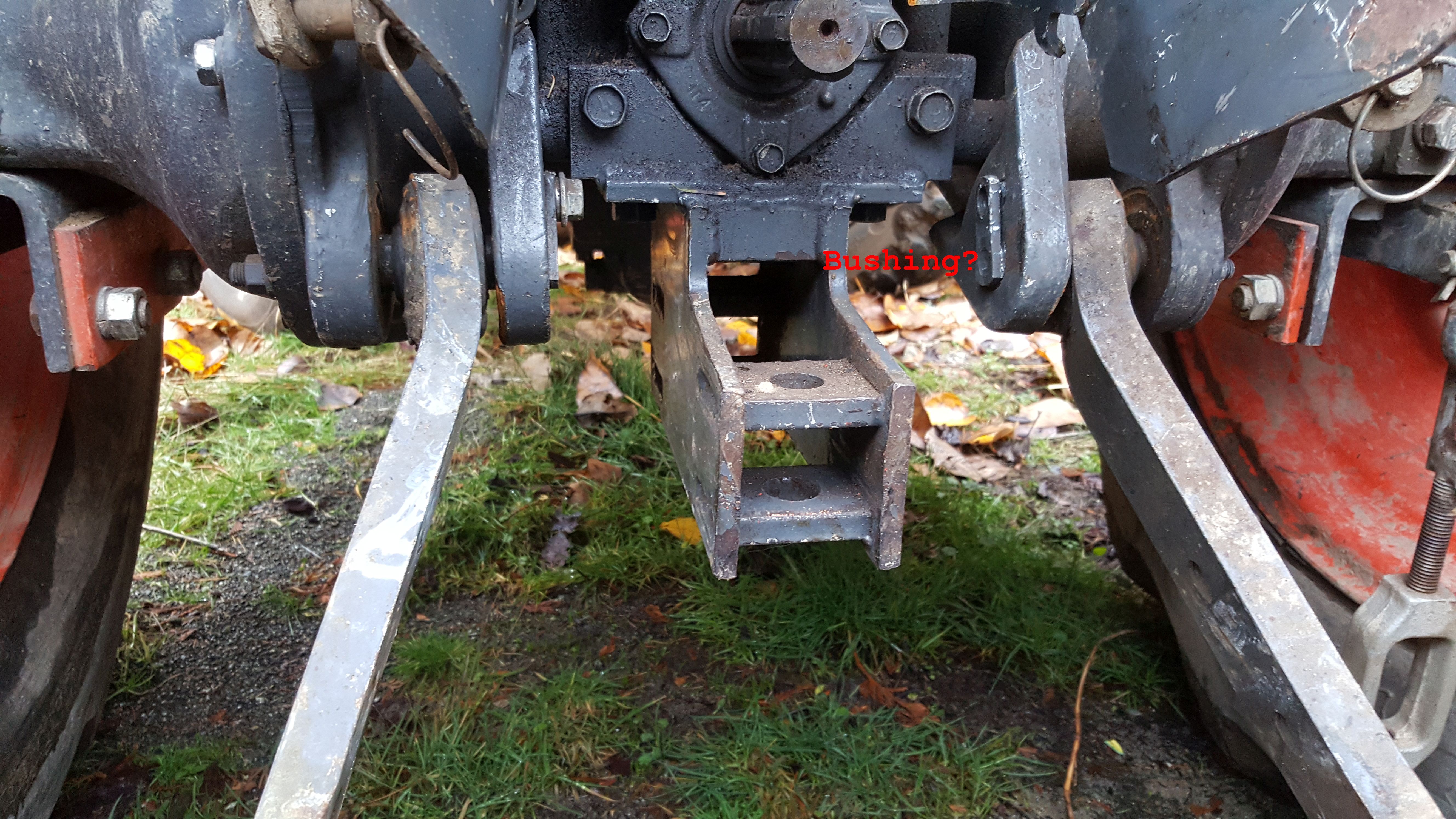

I need to replace both lower links on a kubota L2900, but I'm puzzled on how to proceed. It looks like there is a pin, hold in place by a bushing, but trying to remove that bushing is almost impossible.
How do I proceed?

I'd remove the drawbar mount and go that way with it. Brass drift and some penetrating oil. Doesn't look like a fun job.
   / L2900 lower link replacement - how to - please #3
Looks straightforward; remove the nuts on the pin, and the bolt in the anti-rotation arm, and the drawbar mount, as bspeedy notes, and drive out the pins. Ten minutes, unless something is really stuck.
   / L2900 lower link replacement - how to - please #4
I'm guessing that the keeper bolt on the RIGHT can be removed without hitting the drawbar bits. If so, then that pin's inner bracket's tab gets rotated down so that it/pin can clear for pushing out. Penetrating fluid, a few shocks, and if you can get a clamp on there to help push on the outer threaded end (with the nut spun out to the end- something that you should look to do FIRST, before removing the inner keeper bolts) I think that should do the trick.
I had a keeper bolt eject itself on my NK5510 and the pin dropped out (being a newer tractor it wasn't frozen in place0. Obviously, in my case, plenty of clearance:D (I was lucky that the pin ended up resting on the drawbar frame)

Easy to do. Remove pin, remove bolt, pull out rod. And also detach lift arms. They are a little heavy so be prepared.
