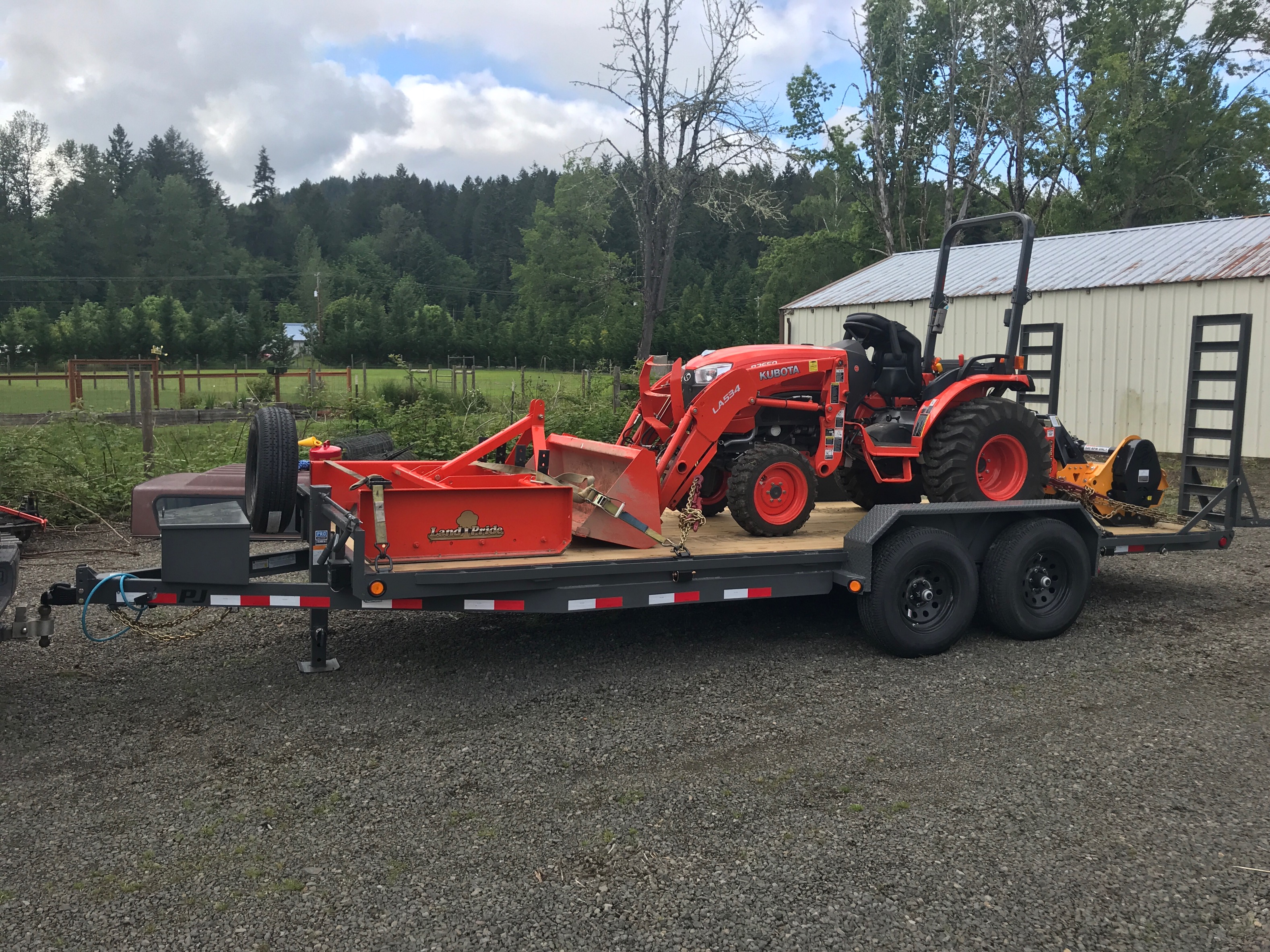

Not 100% sure but if the trailer is decent, with brakes, seems like it would cost closer to $2700 around here.
   / L2501 package price check #12
Same here. Make sure you are getting 5k axles on it. 3k of trailer, pushing 4k of tractor with loader & loaded tires. 1k per implement. That pushes you past the safety margin for a pair of 3.5k axles.
Fitting a tractor & implements on a trailer is one thing. Balancing it properly for 10-15% tongue weight is another. You need extra room to adjust the load as well for any impliments. Go for a 20' if you can.

Get the longest trailer you can manage. I have a 20ft. Wouldn't go smaller if I were shopping today.

Another vote for a longer trailer if you have space... My B2650 with a flail mower on the back and a grader/scraper strapped down up front just about maxes out my 20’ deck.
Btw, my total loaded weight here is 7,600#. A little over 3K of that is the 10K rated trailer.
