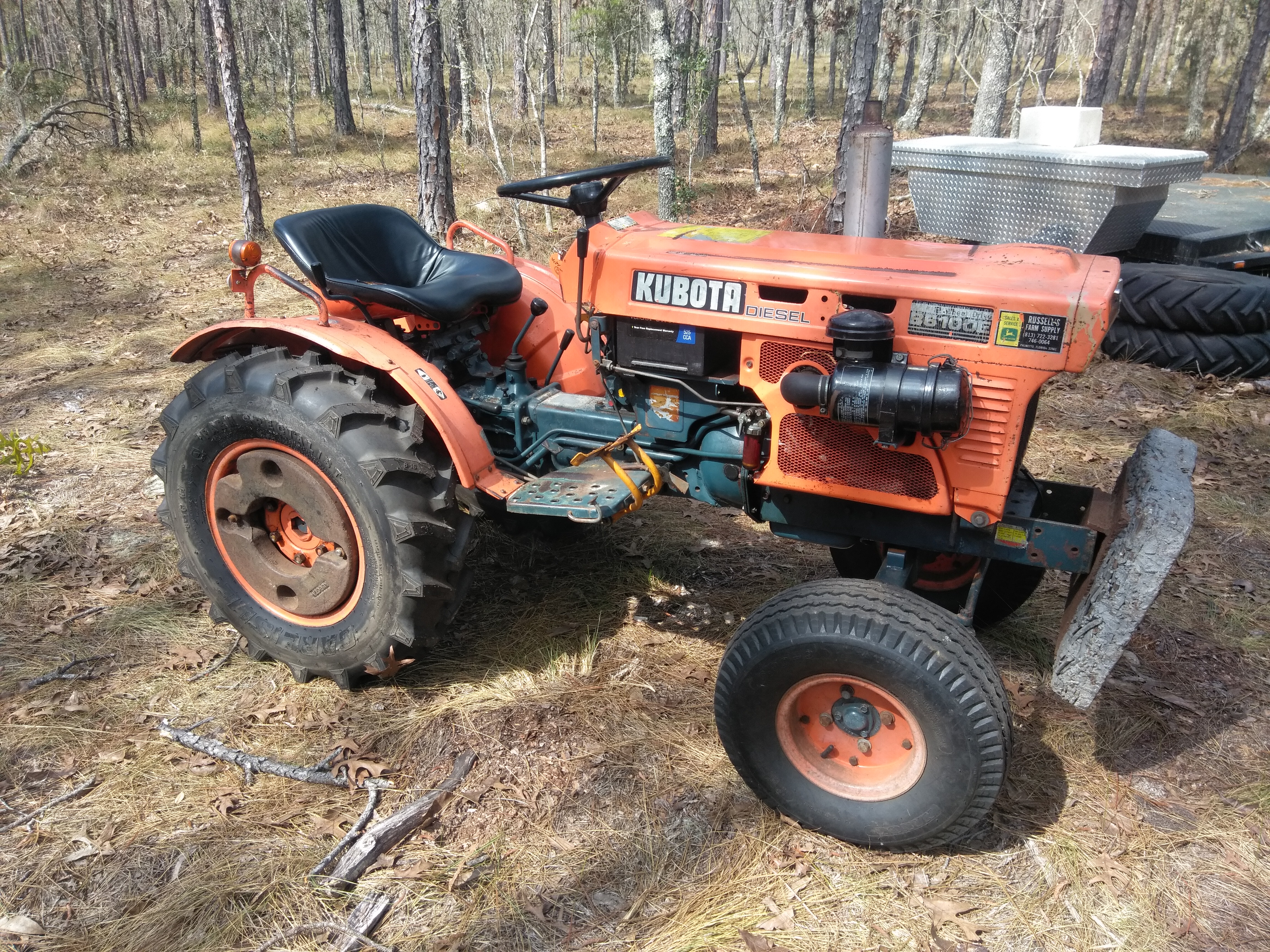

I'm considering trading in my B series, I need a backhoe, backhoe attachment is 7 gees plus and that's alot of money.
What should I expect for trade in value? Guy said they could prob. make it worth my while.
Not crazy about giving up my B series, it's been a great tractor and still has zero issues. IMG_20190302_110111.jpg
