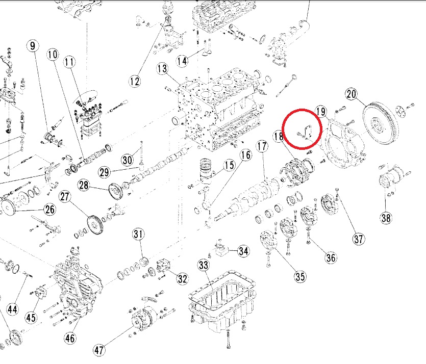

One year later... So this is embarrassing! I cant find the flywheel viewing port for the TDC mark. I'm guessing it is hidden behind the loader frame, like the 2-stage clutch adjustment. Anyone know?
It appears to be on the right side of the bell housing about the 3 o'clock position.
