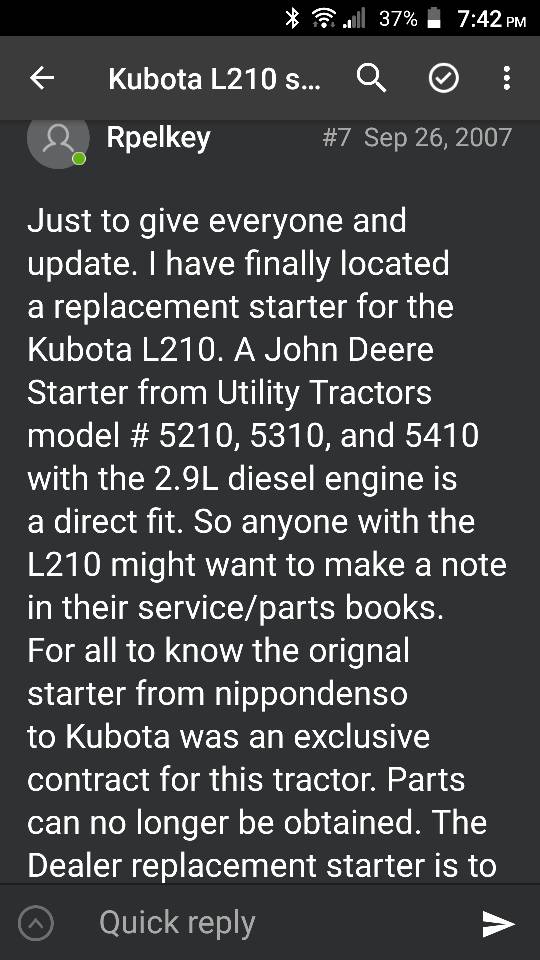

mitsubishi satoh s470
Does anyone have a source for a starter solenoid for this tractor? I have been stiking out.
I just finished up a l210 project. I ordered a John Deere 5210 starter and bolted right in Screenshot_20180820-194226.jpeg
Thought about ebay $30, or whole starter for 90
