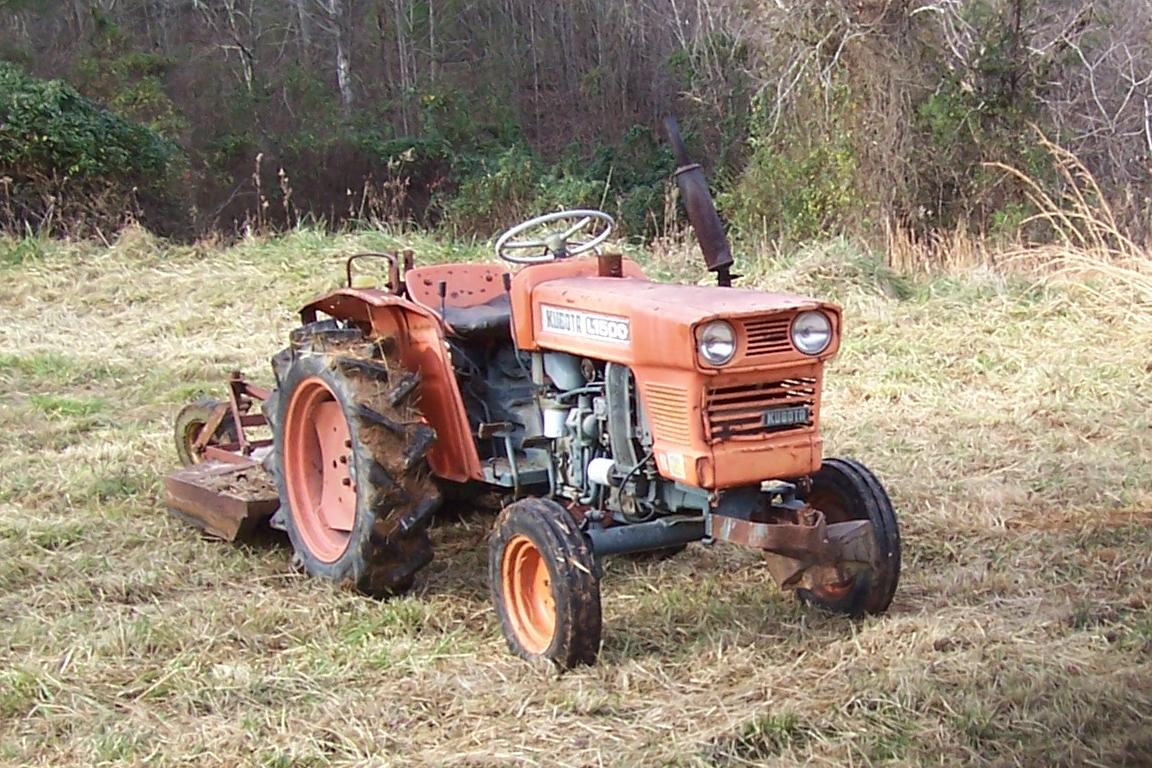

If you're sitting on the seat the dipstick is below and forward of your left foot. It's much lower on the engine than you might expect. I assume you are talking about the engine oil.
Attached is a photo of my L1500, Archie.

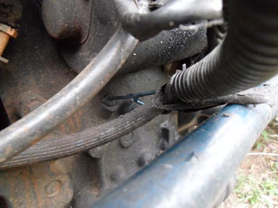

   / L1500 Oil level
Thanks Archie - found it! The ring at the end of the dipstick is being used as a cable tie to stop them rubbing the transfer shaft (mine is a 4WD) which threw me off the scent. See pics attached.
I'm in Australia - and can get a full filter set here for the service. It's been a reliable workhorse - wouldn't want to wreck it by neglecting it.
