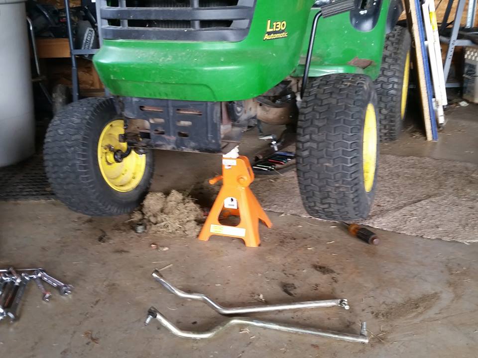

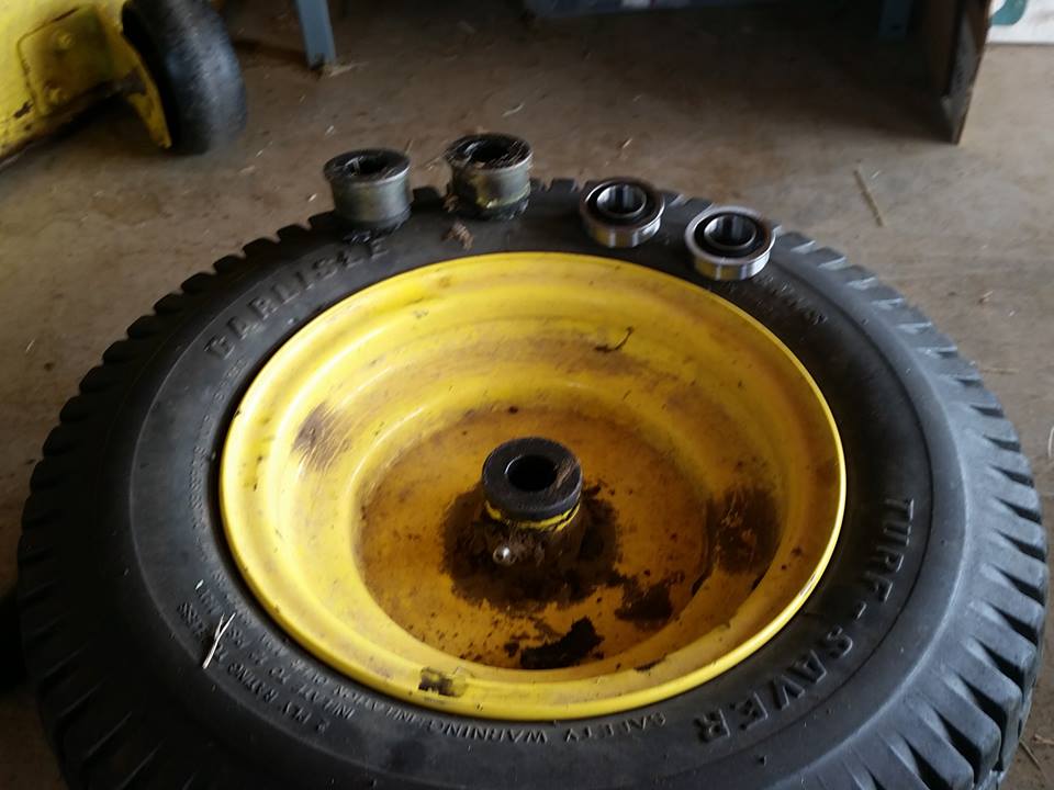

I have my dads L130 (2002 - 2005 years) - it has a terrible front end alignment issue (huge toe out - which explains the hard steering) so its getting 1) bearings in the front wheels replacing the bushings, , 2) new adjustable tie rods and 3) a few other misc steering parts..
1) The front wheels have grease fittings - But since im going to the bearings, do you still need to grease the wheel? the bearings are sealed.
2) I got the adjustable tie rods installed but still need to align the front end. Any tips/suggestions on how to easily do that? How much toe in should i have?
thanks
brian

For an L130, zero to less than 1/4" toe in should be more than adequate.
If there are grease zirks, then a couple pumps of grease will not hurt a thing.

The hardest part was getting the old front wheel bushing off.. I did go with JD OEM bearings - there were a lot cheaper bearings online, but a lot got horrible reviews.
One thing i found interesting.. the new tie rods have the adjustment NOT at the tire end, but where it attaches to the steering plate underneath the tractor..

OK.. good news, its all back together.. I bought a new pinion gear off Amazon (no OEM) and it needed a little smoothing of the edges to get it started and then some taps with a hammer to get it on the shaft.. Once on the shaft I used the old gear to push it up in place (tip from an amazon reviewer)..
On the front end alignment I did the best that I could I has a piece of oak flooring 3" that I used to measure the front and back of the tire with to get it close enough.. While on the ground, i put one end of the board in front of the tire in the center (has a clear mfg line) and then marked the board where the center of the other tire hit.. Then I measured the rear of the tire and compared measurements.
It took a couple of times to find the best position/length for the tie rods The new OEM tie rods are 2 turns from the shortest length. I may try to find a wider board (so its closer to the center of the tire). I started out with the rods in the shortest position and the toe in was like 1", BUT boy it felt like you had power steering it was so smooth..
Note 1 - there is so much free play in the steering you wont be able to get it exact. you could measure multiple times and get different readings..
NOTE 2 - when the steering pinion is in the center position on the L130 (and I assume others) there is a hole in the frame that matches up so you can put a bolt through both to keep the steering from turning..
