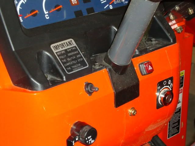

On the L3400 there's a set of wires under EACH fender, for that purpose (work lights). They're fused at 10 amps in the fuse box next to your left knee.
I spliced a switch into the main feed (yellow wire with red fleck on mine), and mounted the switch in a hole drilled through the dash. Make sure the switch will handle the current the lights will draw.
