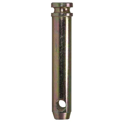

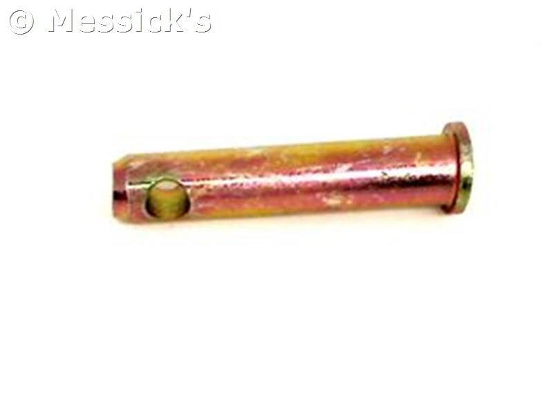

Glad it had a happy ending. For others that encounter this in the future and maybe even without the lift cylinders, the farm store Chinese toplink pin will usually not work. What always will work is the OEM pin. Messics has them in stock and pricy at $12 or $24, depending on model.I suspect they are that expensive because other pins often don't fit and you have to go OEM. I do in my L4300.
Here's pic of an OEM pin below.
Below is a farm store one that may or may not fit, usually not..
