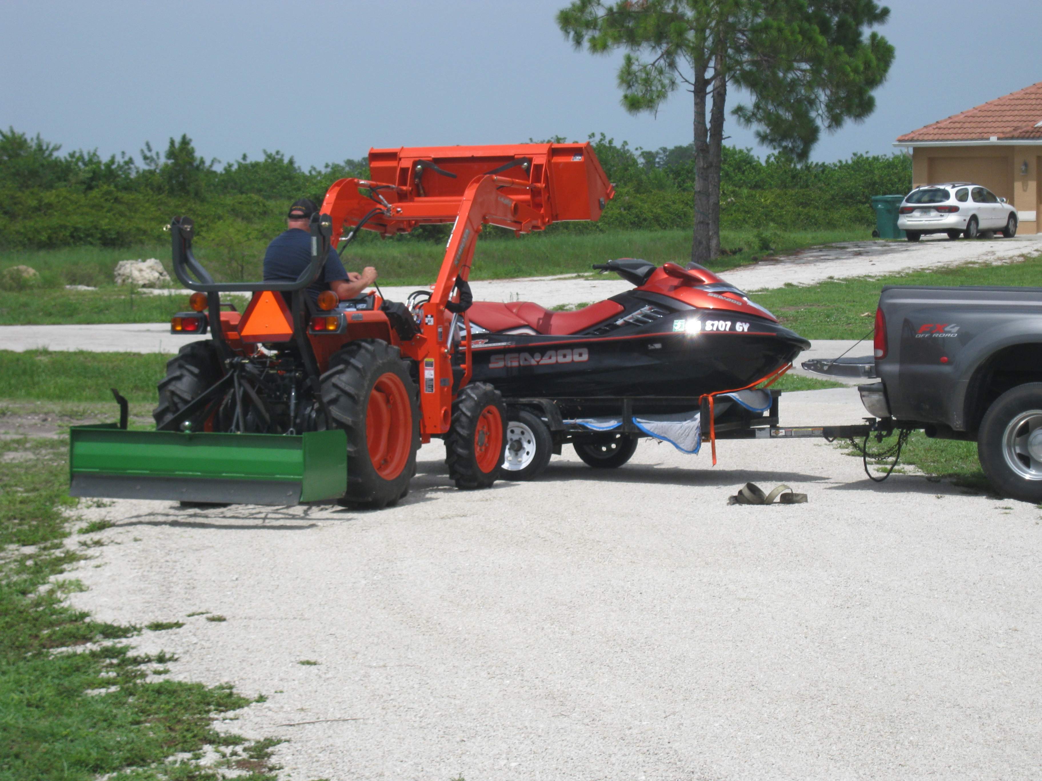

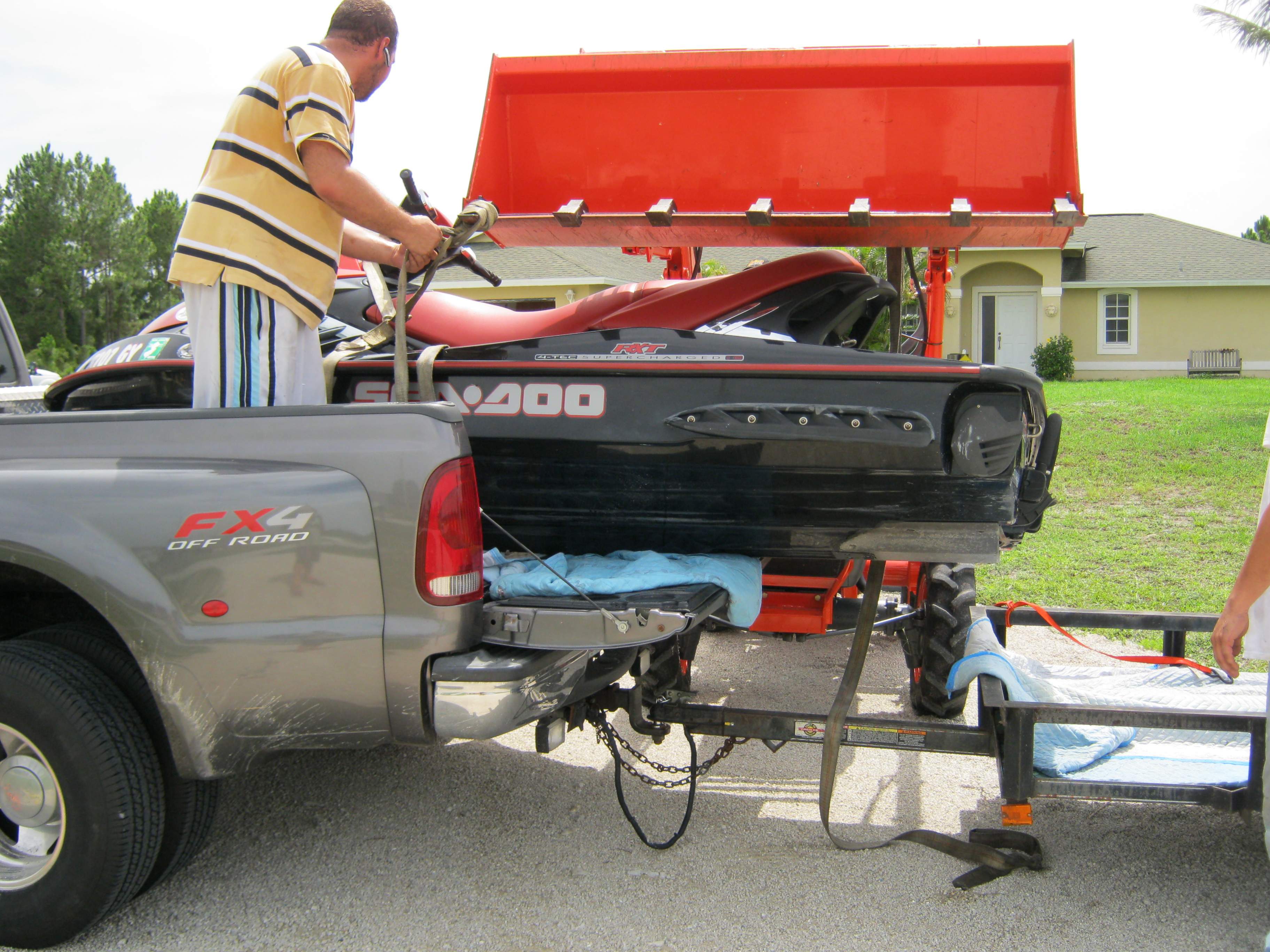

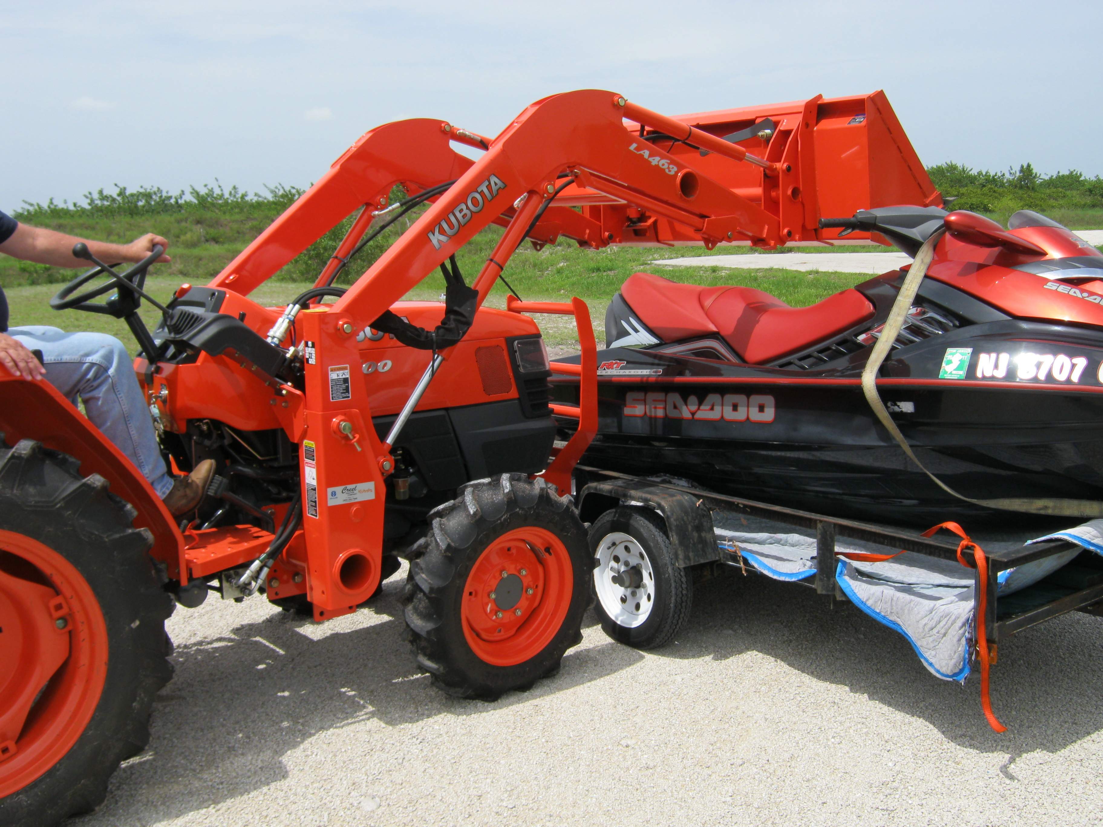

I remember this thread it was a blast from the past , at least to me because I use to own a L3400 DT (gear) direct transmission . Seemed like this was an issue , as was a cable that controlled something which I cant remember rite now . I loved mine dang good small tractor .
Here was a thread I always keep pinned on my computer on bumping up the lift capacity .
https://www.tractorbynet.com/forums...-up-lift-capacity-l3400.html?highlight=cowboy
