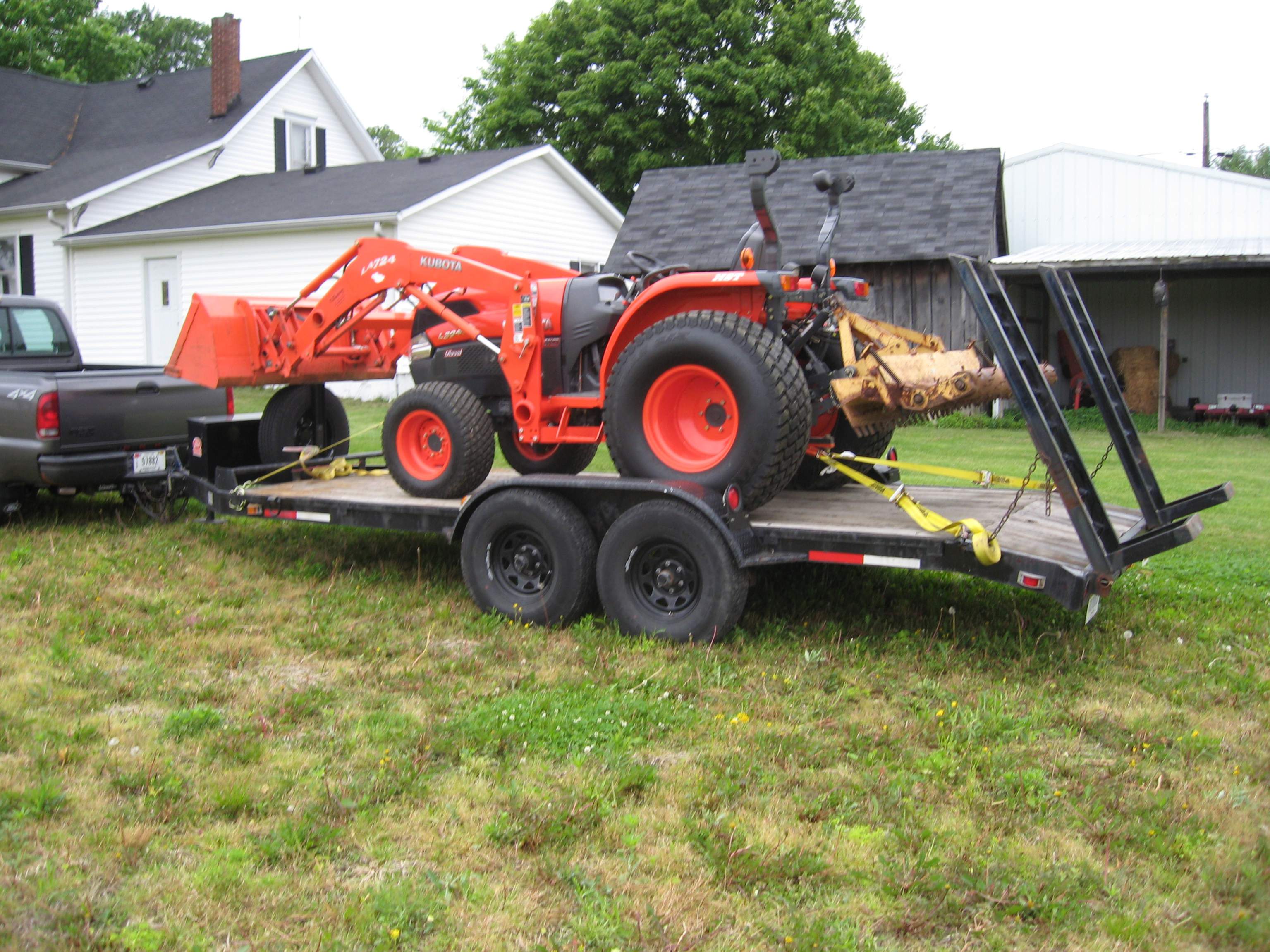

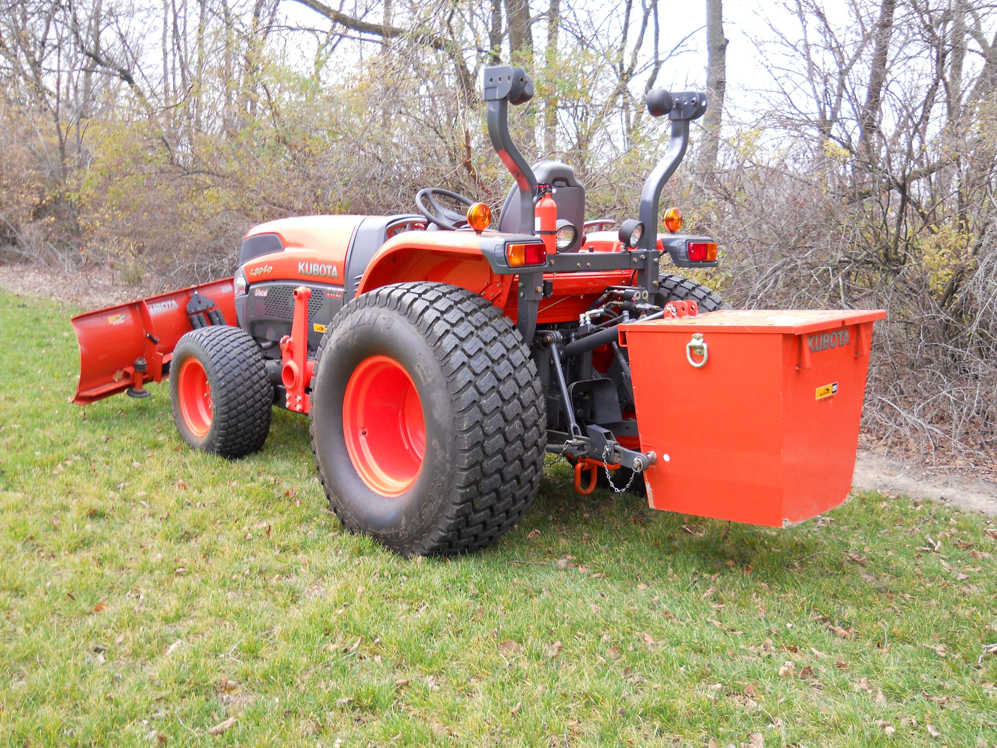

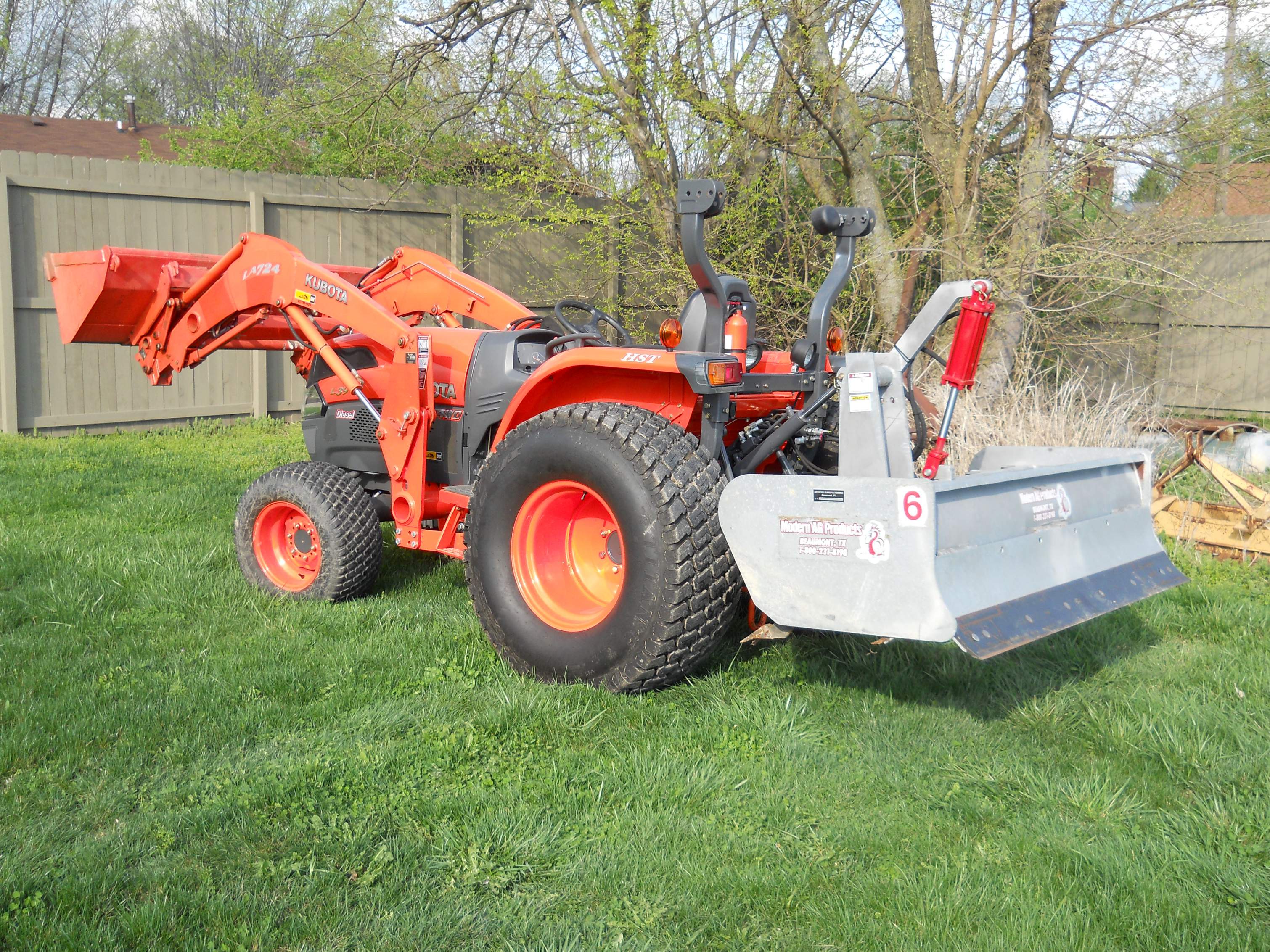

Here are the 3 items I use for ballast with my L3940 and FEL. Ballast box @ 1250#, box blade @ 1150#, pulverizer @ 925#. Each do a fine job of counter balance and adding traction, and I DO NOT have loaded tires, nor will I on this tractor. The ballast box is nice because it is compact, so I don't have to look over my shoulder as much to make sure I do not accidently swing into things. I once drove into a ditch to retrieve a large rock for my neighbors 'prized' rock garden. Too big for his Teremite to get. Little uneasy sitting on the seat, but by taking it slow, and using a little common sense, and nearly killing my neighbor as he made one last push to roll the rock into the bucket, the rock and Kubota made it out just fine. Take it slow and learn your limits, just takes time. Good luck! Philip.

   / L series doesn't feel safe with bucket on #53

In my experience, the safest counterweight is that ballast box mounted on the 3PH and carried low (don't have to have that 3PH fully raised).

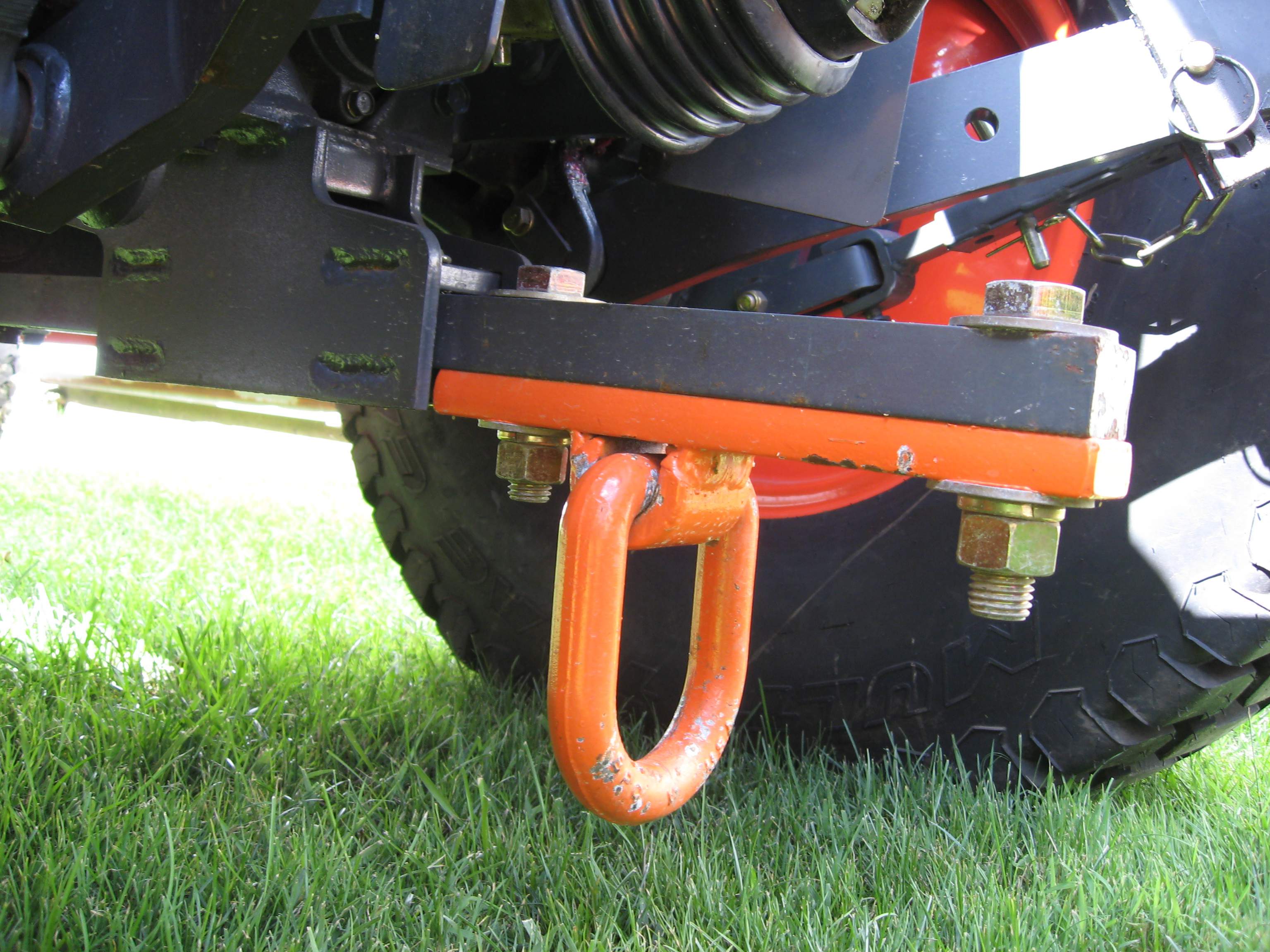

Notice in 2nd pic that your lower links are extended. Can you work with them out? That might work for me if so..
Oh and you know what the d ring bolted on your draw bar is called? The dealer couldn't find me it.

OK, that is a very poor/bad example by me. I hooked that up for a quick picture only. I should have set ballast box on ground, backed up, and locked the end links. I/you should always operate with the end links closed. Appoligies.

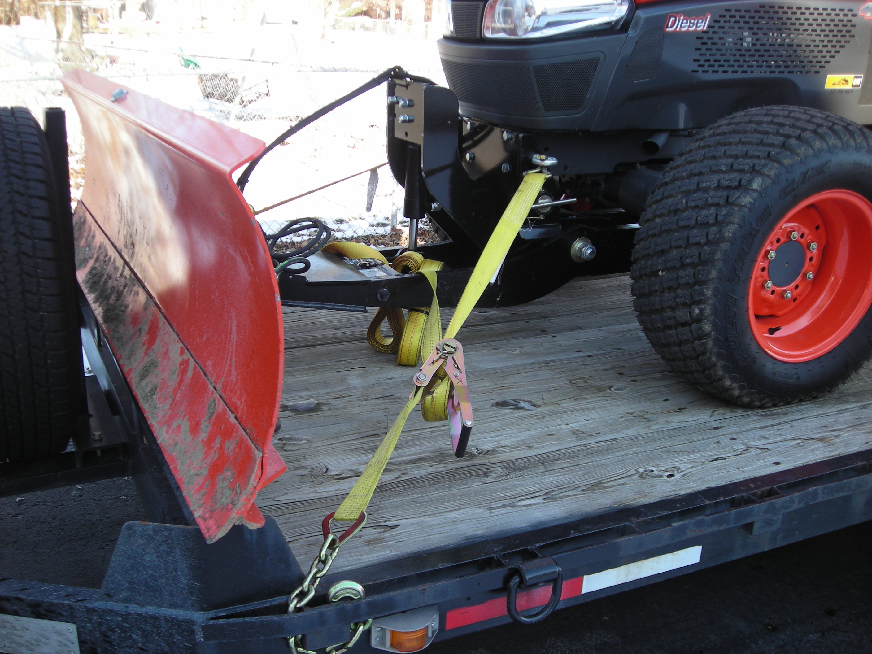

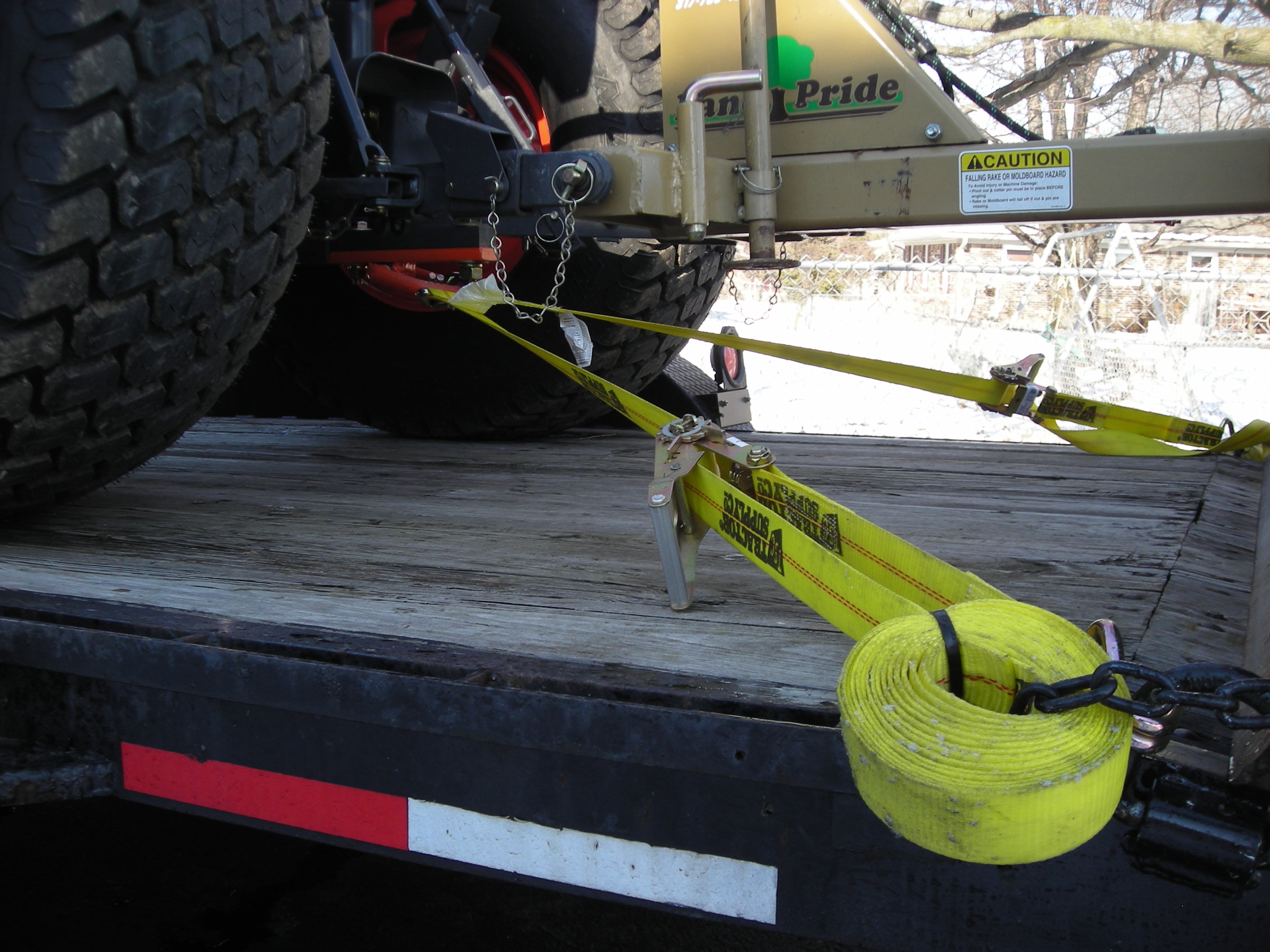

Yes, it is called a D ring. This is how I tie my tractor down to my trailer. It is a piece of flat steel that I drilled holes in to mount to my oem drawbar, then I welded a D ring to it.
