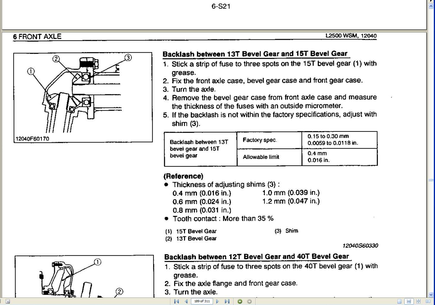

Looks like they are a little bit to much on the inside looking at the wear marks.
Maybe this will help, from my L2500 manual which is probably close.
Rob

   / 'L' Series Correct Frt Gearcase Shimming - Bevel Gear
Thanks Rob, that helped. I assume by "too much on he inside" you mean they were too deep?
There was a single 2mm originally. I ended up with a .8mm on that bottom bevel gear. I'm doing the seal on the other side too and will be checking that gear also. I told the dealer if it looked like the first one, I'd be back - and looking for a bigger break on the parts!!
   / 'L' Series Correct Frt Gearcase Shimming - Bevel Gear #4
From what I could tell depth was decent, but there was a lot of wear on the inside...large part of the gear and little in the small end. Even though it's a bevel gear, IMO it should still cover equally. Where your gears broke, it seems that is where most of the wear and pressure is.
