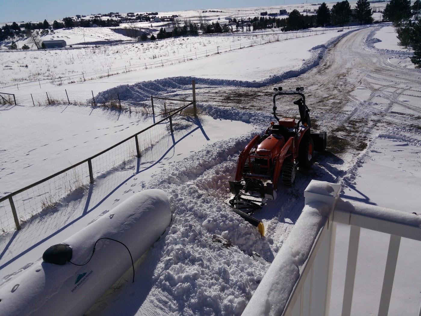

Today we got about 18" of heavy wet snow. My small JD was in the shop getting serviced, so I borrowed my neighbor's 39 HP Montana tractor. One thing I noticed was that the R4 tires on his much larger and heavier tractor spun on the slick spots and lost traction more than my little 20 HP tractor with R1 tires. Of course the larger unit was more stable, comfortable and got the job done quicker. But interesting about the traction. Also the rear tires on my 4100 are loaded, while his are not.
/ L series comparison #22
Loaded tires certainly help. But r4's do suck in snkw compared to r1's
/ L series comparison #23
That is why I put on the chains in the last week of November.:) Of course we haven't needed them. In fact we don't need a tractor. A boat would be a nice accessory here in Missouri about now.

I own a L3901 and love it. Run a bush hog and have LA525 loader. I quickly learned that weight was needed. I have sloping ground and with out it I was tippy feeling. I added Rim Guard to my R1 tires which added over 500lbs of weight. Huge difference. I have pushed two snows with my loader this week. 9in and 5 inch. Never had an issue with traction in 4wd. I am trying to get a rear blade to use as well but no luck so far. Good luck on your decision.

Shortest possible answer: Kubota has them available as a factory part. Many here have spacers. I believe OEM is 2", not sure.
Grooved R4's.

Notice the grooved R4 tires on the above photo that Garandman posted. Many users report much improved traction by grooving their R4 tires. When I had a L3400 I grooved my R4 tires, but we only had one small "rabbit tracking" snow to try them before I traded off the tractor. I felt it helped quite a bit, but we just didn't have enough snow to be sure. The concept of how it works is that snow on snow offers good traction. where rubber on snow does not. The grooves pick up and hold snow in the grooves and it acts as a traction device against the snow on the ground. This is why most users report better traction in snow from R3 tires than R4 tires in that the R3 tires have many grooves to pickup and hold snow. As for ice though, I don't think anything works as well as a good set of chains.
