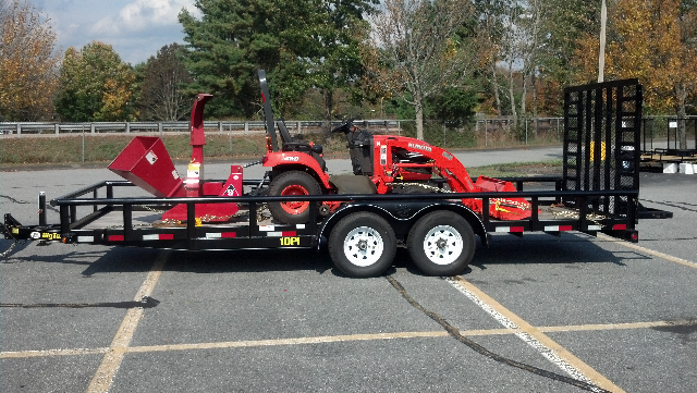

I am a tremendous fan of quality and overkill. I pulled the trigger on a BigTex 10pi for my BX2360. At most my tractor weights 2600# but i bought a trailer that will last as long as my tractor.
Quite frankly i invested in the ramp. Last trailer i used for landscaping i destroyed. Bent the ramp to high heck and springs went bad because to rear support when loading equipment on/off.
Cheers! Remember quality matters!
