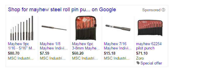

I agree and these are very good roll pin punches with protrusion in the center so punch will be centered in roll pin.
