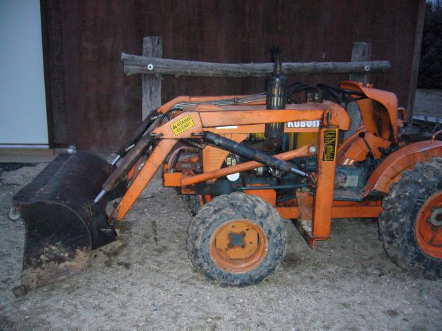

I think my b7100d tractor is about the same age (serial number 59680) and it came with a b219 loader. Runs off a front PTO pump with the reservoir in the right hand upright, round back bucket.
Its getting dark but I grabbed a few pix, will post here shortly.

Here are the pics of my b219 loader on a kubota b7100d

I'm thinking those may be aftermarket hydraulic cylinders. Try a shop that does hydraulics and see what they say.

My 1978 B6100 has the Kubota B219 loader just like Charles' B7100.
My FIL is the original owner and I got it from him. The cylinders may look aftermarket because they're not painted Kubota orange but they're original.
I have a leak in one of mine and got the re-packing kit from tractorsmart who advertises/posts here. Looks like a pretty straight forward repair if I can figure out how to remove the snap ring holding it together. The snap ring that came with the kit isn't like any snap ring I've ever seen. It's hard steel and has no "snap" to it at all plus it's as big around as the cylinder so normal snap ring pliers won't open wide enough. Until I come up with a plan of action to get the snap ring off, I'm just living with the leak.

THANK U SO MUCH. if my exhaust wasnt mounted horizontally, instead of vertically like yours, i'd swear it was the exact tractor! if i hadnt noticed the vertical exhaust in your pics, i'd be out to the barn to make sure mine was still there! i even see similar scratches and wear on the loader,etc.
