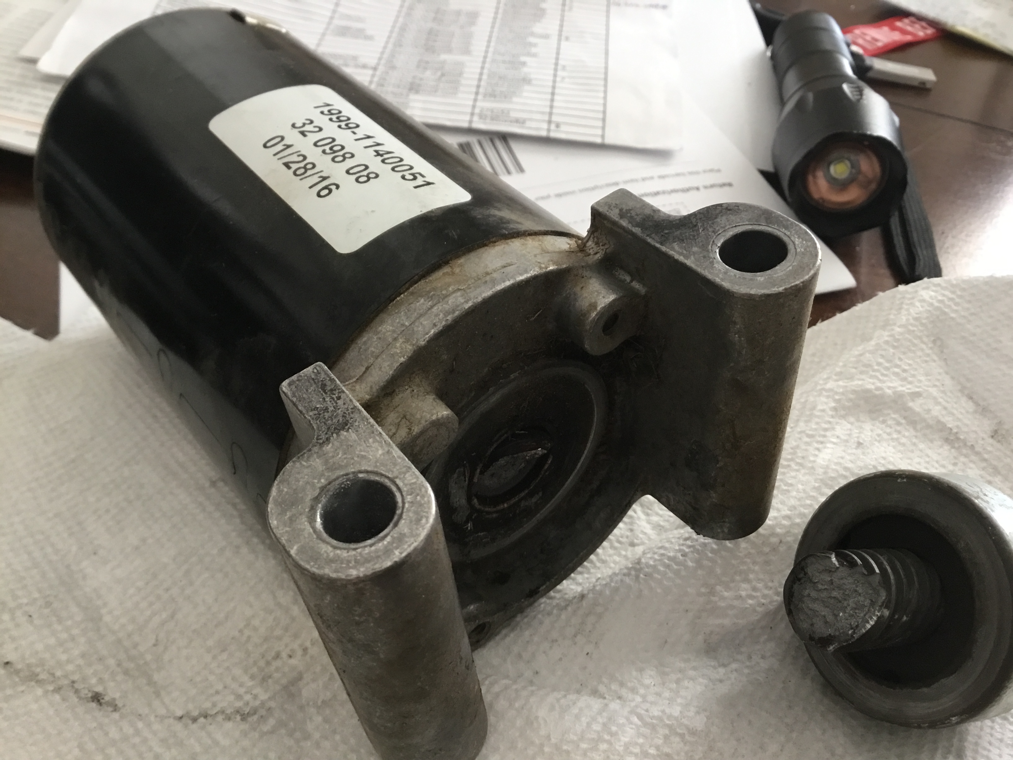

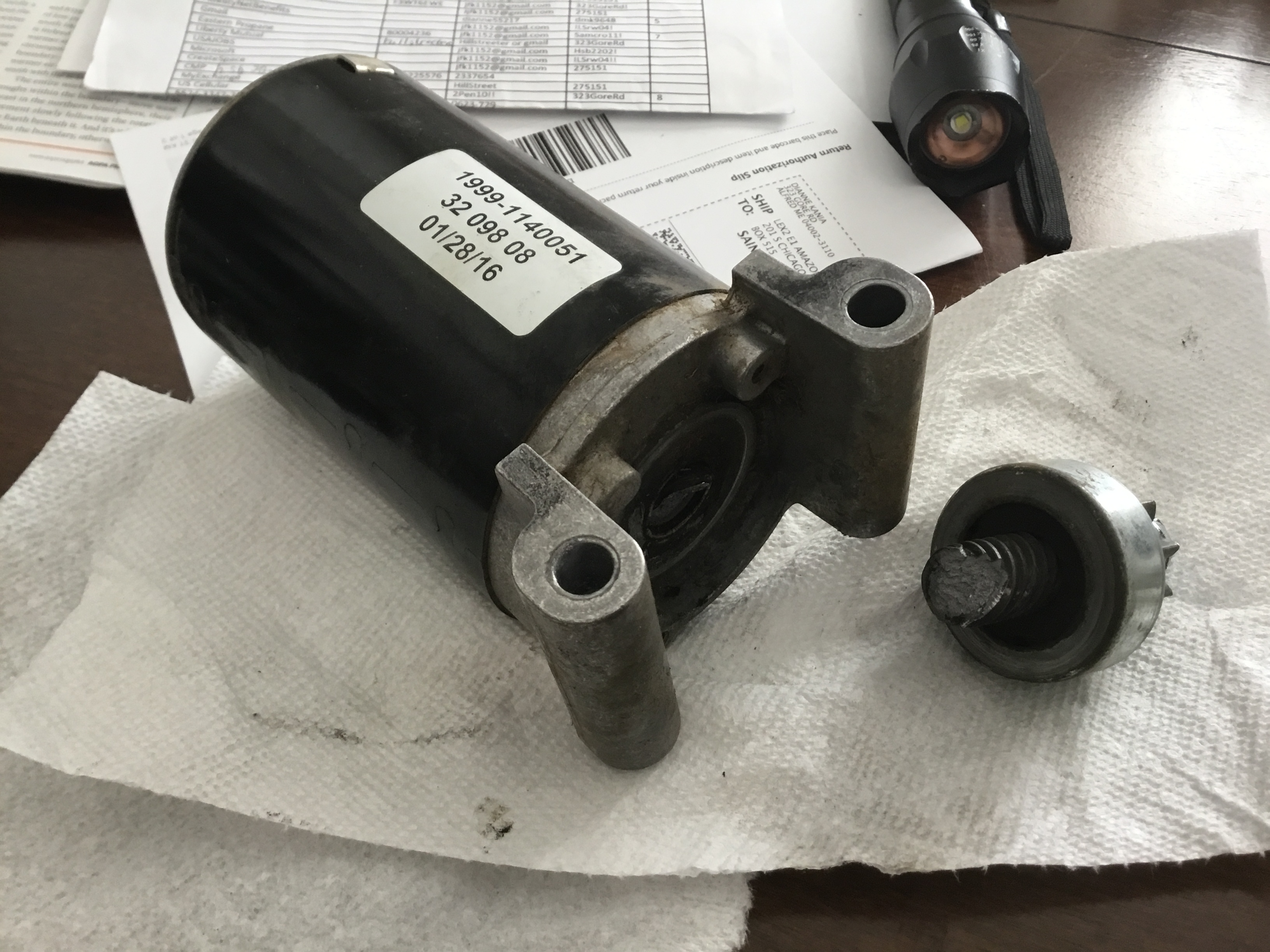

91D8DF91-4C4E-4DD1-947F-10080CA2354F.jpegFE6CCE33-B94C-46CD-88B6-337E41C8C9B6.jpegFrom the OP: I jumped the solenoid this morning and got the same groan. I took the thing apart to see what was up and I found the starter was broken, the starter shaft was broken in half. I don’t know what caused it but I have the dealer looking into it.
Oh, and the engine turns freely.

View attachment 597476View attachment 597477From the OP: I jumped the solenoid this morning and got the same groan. I took the thing apart to see what was up and I found the starter was broken, the starter shaft was broken in half. I don’t know what caused it but I have the dealer looking into it.
Welcome to the Kohler Courage twin starter issue. The top bushing wears and gets oblong, and then gets to a point where it will bind with the flywheel, and then it breaks the shaft off. Replace the starter on move on. There is a way to upgrade to the Command series solenoid shift starter which eliminates most of the starter issues.
