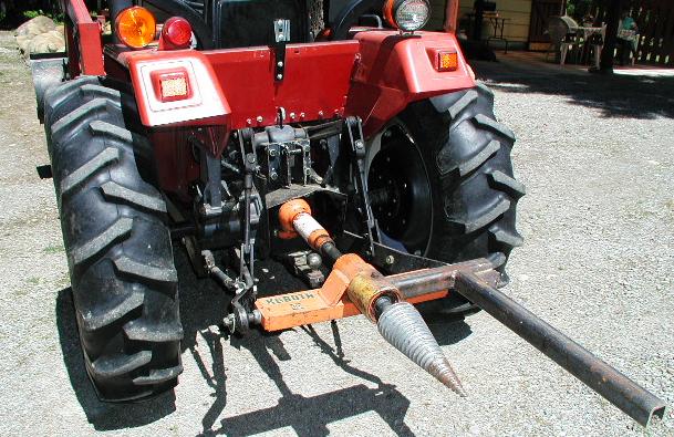

Gudday Treeboone, I just had a look at the pic of the woodsplitter,thankfully I have never seen one in Oz, looks like it's well named.Being an X farm machinery mechanic I could see that an operator could be seriously injured without any problem,if I were you I would look at the hydraulic ones,I have one that runs from the tractor hydraulics and it's abeauty. I wonder who dreams up these implements? must be someone with plenty of time and very little to do except think of ways to make useless and very dangerous machinery to be sold to an unsuspecting populus. Kerry.

Guys I have used that splitter for 10 years. Yes it is dangerous. But faster than anything else I have used.
That is made in the u.s. by unicorn manufacturing.
It is rare to find a piece of wood that it wont split.
Exceedingly to get it stuck. Ground speed pto reverse usually works.

Ok...at the risk of being mobbed here /w3tcompact/icons/blush.gif...I just saw an almost identical unit being demo'd at our local Farm show here. I'm having problems seeing the danger in them. The PTO was turning sooooooo slowly and the conical bit was doing all the work....gradually pulling the wood onto the bit and splitting it. I actually thought it looked pretty good. The only things I didn't like were (1) that the wood does not split as cleanly as a splitter does it and won't stack as neatly and (2) it seemed sooooo slow!!! I know they look kind of dangerous...but if you operate them at a VERY low speed as the salesman was....In fact he indicated and it was even in their brochure that they are safer than splitters as you don't have that quick split/flyout issue to deal with. Am I missing something???

Very slow operation might be all right, but even at low motor rpm, say 1000, the rear pto would still be turning at about 200 rpm. My arm can't rotate 360 degrees three times a second without damage. Ouch!

Maybe the model I saw had some sort of reducing gear in it. Honestly you could pick a spot on the screw head and follow it easily as it turned around. It was VERY slow. Did I mention it was extremely slow!!! Too slow for me to think about doing much wood with it so I moved on. /w3tcompact/icons/smile.gif

re: the screw type wood splitter. I have five acers in Massachusetts. In the seventies and eighties
I was on a strictly wood economy; for both heat and hot water in the house. ( two stoves,15-20 cords
a winter). I had one of the screw type splitters on my one-ton International Harvester pick-up.
I've got hundreds of hours using "the screw"!!! IMHO, it was without a doubt the BEST splitter
I.ve ever used. Reasons: 1, It did indeed relolve very slowly, nothing happened quickly!!, safe.
There was never a time that things were filpping around. 2, there is a 'kill switch' near your hand
or foot at all times. 3, power!!, knots, root balls, tree jounts, were no problem at all. The power-
torque comes from the design, ie: the Screw not the driving device. 4, ease of operation: since
the 'screw' was only 12-15 inches off the ground lifting was kept to a minimum. I just rolled or held
the log ( 2" to 2' ) up to the the screw and when to grabbed; just step back and watch. Yes, it was
sometimes necessary to use a mawl to knock a log loose, but only one in a hundred.................
5, One man operation, quick, quiet..........
