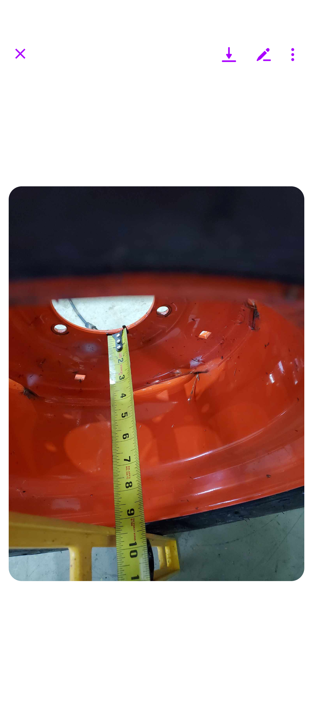

Happened across an ad locally selling a pair of 12-16.5 R4's. But they are off the rear of a B2601.
Bolt pattern and hub hole all look the same based off the pics. Hour and a half drive away so dont wanna waste a trip.

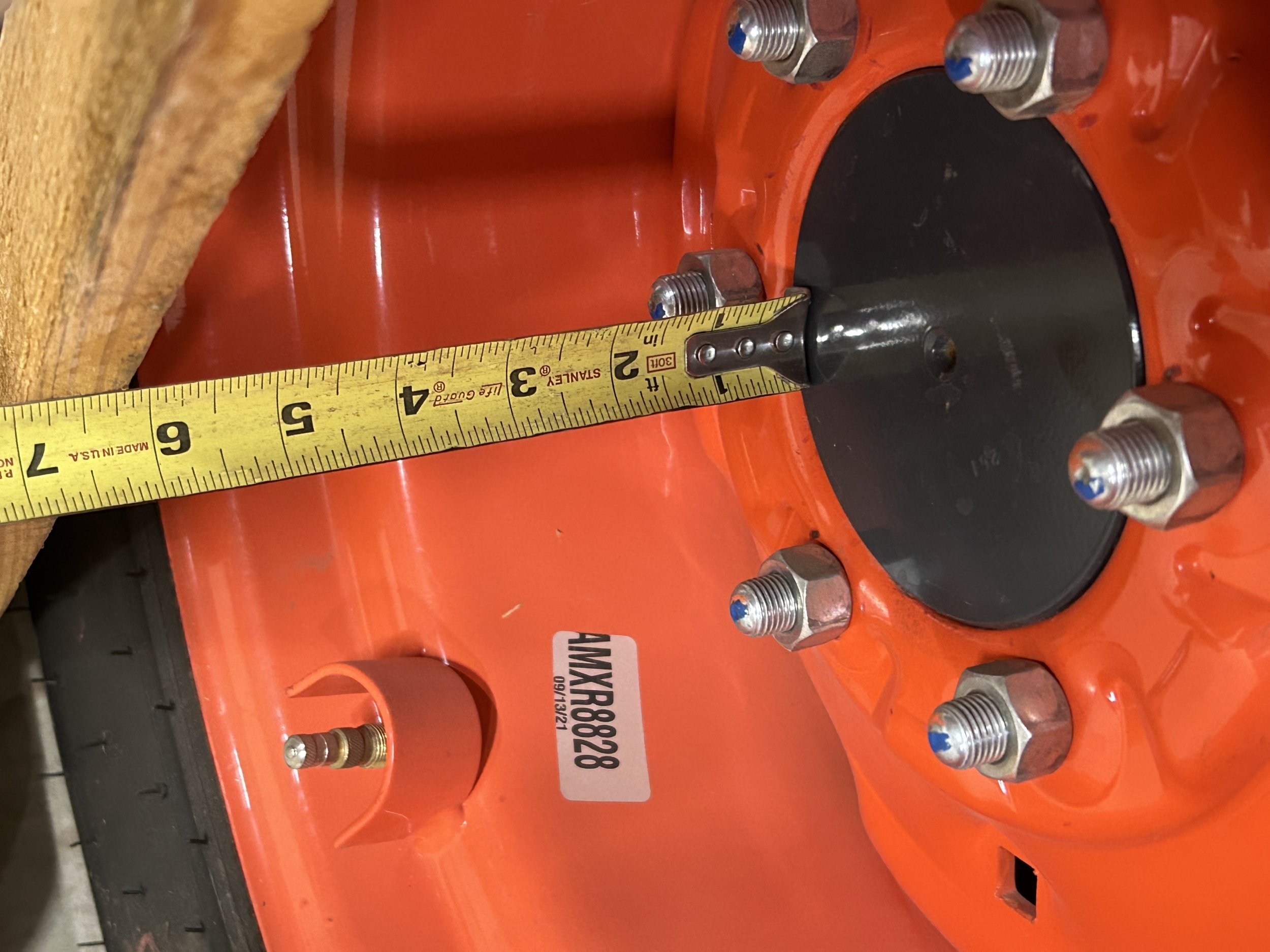

I have R4 tires on my MX. what measurements do you need?
   / Kubota Wheel interchange...B-series vs MX
Wheel offset is the big one.
I can measure my stud diameter on my tractor.
I will do that this evening.
Thank you.

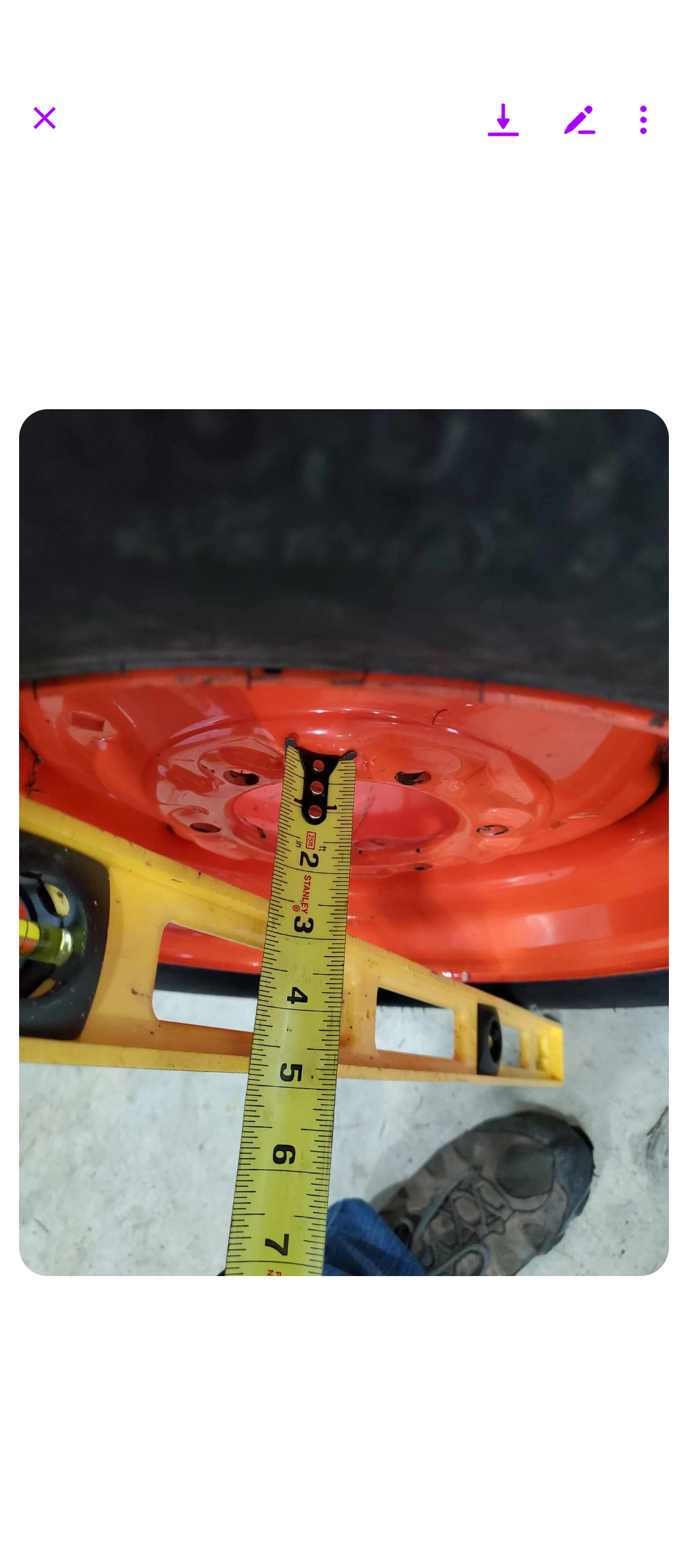

This is what the guy sent me for the rims he has....see if yours are close
Definitely an offset difference.
Seems the MX is somewhere pretty close to the middle of the rim....whereas the B rears have a lot of offset.
Gonna make the either stick out way to far, and probably hit the loader frame, or be way too narrow and hit the frame or something when turning
   / Kubota Wheel interchange...B-series vs MX #9
Yeah, you’ll probably have to buy MX wheels.
