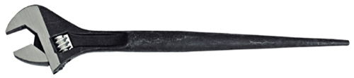

[a little OT]
I've got a really useful tool in the box. It's a big "crescent" wrench with a handle that tapers into a spike. Seems like there are always some holes to be aligned when wrestling with the tractor and accessories. I suppose adjustable wrenches are evil, but mighty handy.
Anybody know what that tool is called? I haven't found it or a pic on the web yet.

I think this might be what you have, Crescent 10" Adjustable Construction Spud Wrench. Iron workers use wrenches with a similar end.
184081d1287960630t-kubota-tractor-tool-kit-recommendations-crescent-at10spud-2.jpg.png
That's it, but mine's bigger :laughing: 15" or so. It rides around in the pickup in a waterproof tool box. Handy in the field.
Thanks for the info,
Z.
I picked up something similar from TSC the other day - although it's probably 16" long overall. It stays in the toolbox behind the tractor's seat and gets a lot of use. Also in there are an assortment of lynch pins and top link pins for whenever one goes missing.
