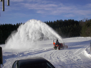

Until the ground freezes and I get a base of snow to work with gravel drives are tough on shear pins. I usuallly use my back blade for the first couple of snows. I turn the blade backwards and angle it. This way I don't dig in and bring up more rocks. I want to try a piece of plastic pipe on the cutting edge of the blower to see if that will help early on. I'll let you all know if it helps or not. /forums/images/graemlins/smile.gif
