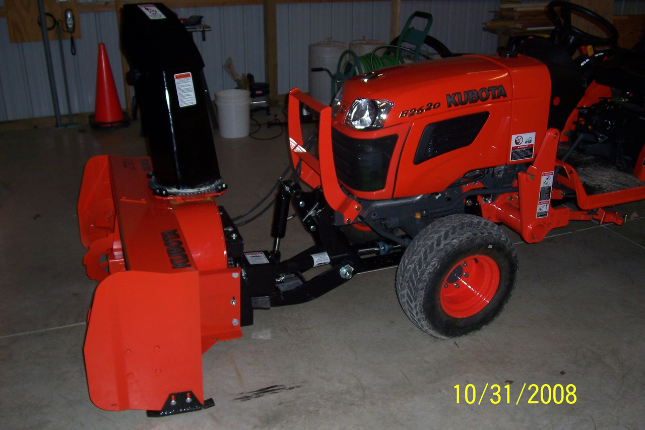

The skid shoes are different and it's an inch wider for starters. The configuration tool specifies it as heavy duty, but it's really hard to tell where that applies from pictures only. Here is one pic I took of mine when it was installed. I can take more pics easy enough if you like. We have 4" of snow in the driveway right now so I believe I will be trying it out today. I could wait for it to melt but that wouldn't be any fun.

That's a real nice set-up! Could you post a picture of your rig from the other side? I was hoping to see the hydraulic set-up. I own a 2920 and I'm having a tough time deciding between a blower like you have, and a pull-behind that mounts on the three point. My dealer said I could have a front-mount blower by spring, and a pull behind sometime in January. Just not sure about how well they work. Anyone have any experience with those? Anyone hear of a heavy duty 63" front mount that will fit on a 2x20? Dealer said it would work???

Sure I will post some more pics. I just got back inside from 'trying' to clear the slushy white stuff in the driveway. Just as I feared, it clogged up the chute just as bad on the 2620 as my old one. I hosed it out and put it away until it get a little colder outside.
Also, I was investigating why my dealer removed a brace underneath the tractor that connects to both loader supports. This brace is about 10"x6" and has 4 nuts welded onto it. It certainly wasn't a clearance issue as I removed one bolt from each side of the quick hitch and was able to put it back into place with no interference. The 'problem' is the bolts (with 1.5" of thread) are not long enough to make it through the thickness of the quick hitch and lock washer and still reach the captive nuts. I'm thinking my dealer could have just used a longer bolt instead of removing it completely. I think I will go fetch me a couple! Stay tuned for some pics. Maybe I'll get the wife to take some action shots if this snow keeps up!
I did ask my salesman at purchase time about compatibility with the 62" blower for the B3030 series. He said it wouldn't work and mentioned it being too heavy or something. This one is plenty big and covers the wheel width which works for me.
