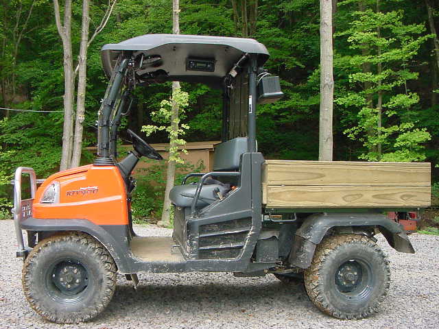

Having a rainy day here so I'm going to have to wait on sending a better picture. Here's an older picture of the machine. I got a 32"x48" piece of 1/4" black PVC and bent to the contour of the inside of the ROPS. There are 2 speakers mounted in the front of the sheet (as well as an extra 12V plug). The stereo is in a box mounted to the bottom of the PVC sheet. The amp (not yet installed) will be concealed between the roof panel and the sheet of PVC I installed. The 2 speakers mounted off the back of the ROPS (pictured in their down - transport position) are on quick-release clamps so I can remove, turn or tilt. I mounted a bed light and a cab light. When I install the amp, I'm also installing a panel for toggle switches.
If you think you'll be doing something similar, let me know if you want more details (places to get the PVC, clamps as well as some of the stereo components).
Those quick release clamps are great also. They can be used for mounting most anything to the ROPS. Actually, I made the windshield and used these clamps so I can quickly remove it on nice days.
