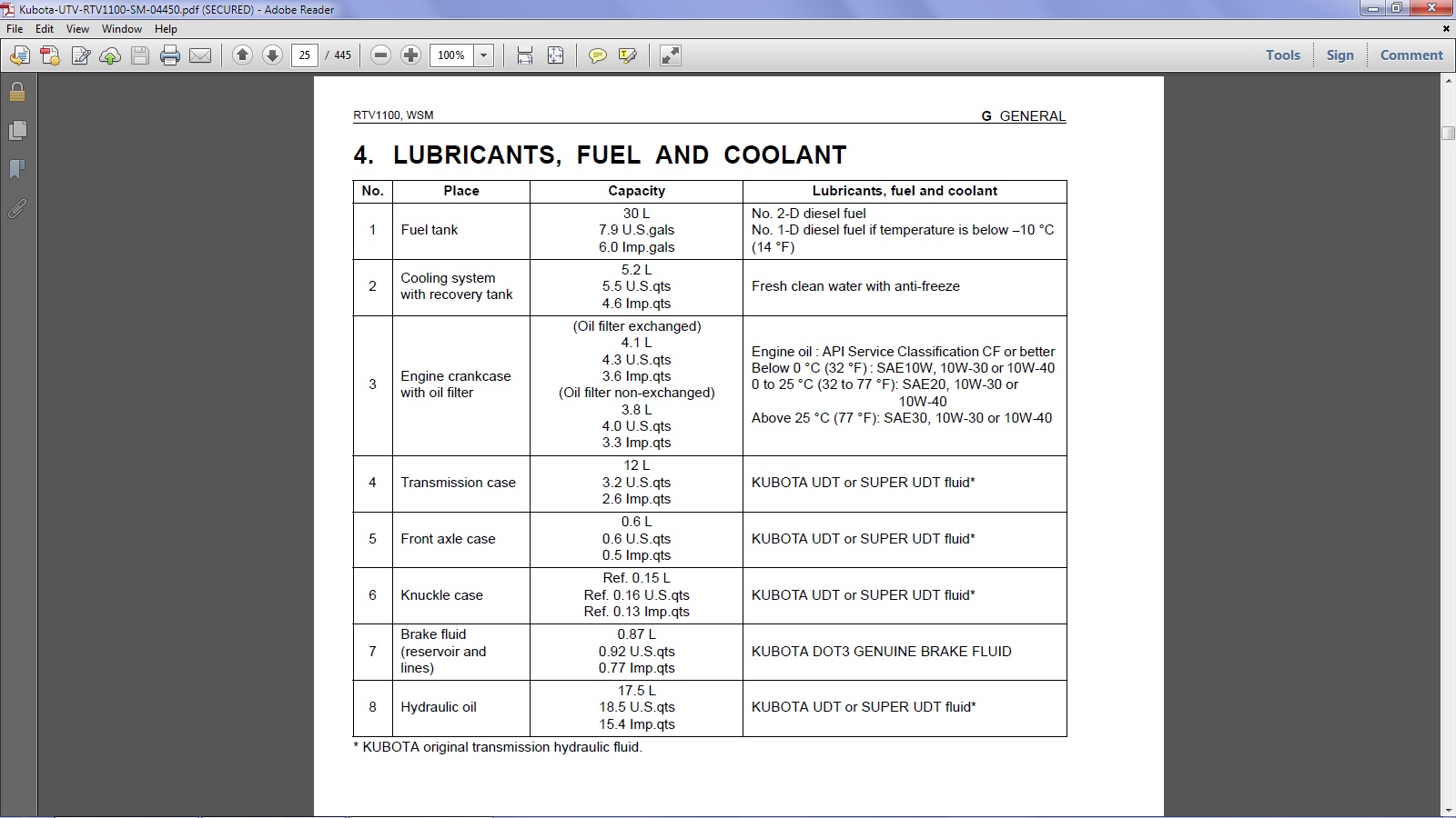

A little late, but good info for others. Amounts would be very close for both 900's and 1100's if not identical.
Got it, same in my manual also.Like I stated before fluid was very thick like 80-90 weight.I replaced it with super UDT as manual suggests.coobie
