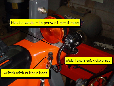

Rear light with switch and quick disconnect. Chose quick disconnect to be able to other 12 volt acc.

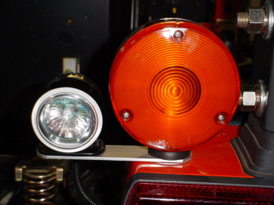

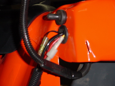

It is a PIAA fog light with a spot beam. The wiring for whatever was already there, I just tapped into the wiring and ran it thru the switch. Thru the switch and into a male/female quick disconnect so that the switch can be used to turn other things on and off. ie sprayer. The light I mounted on a 1 1/2 x 1/8 aluminum flat bar. The flat bar I drilled a hole the same size as the mount on the signal/hazard light But I put a large diameter plastic washer between the flat bar and the paint on the tractor. I forget where I got the light but it is cast aluminum and I only got one of them. I think it was a warranty at my old job.

Another picture.
