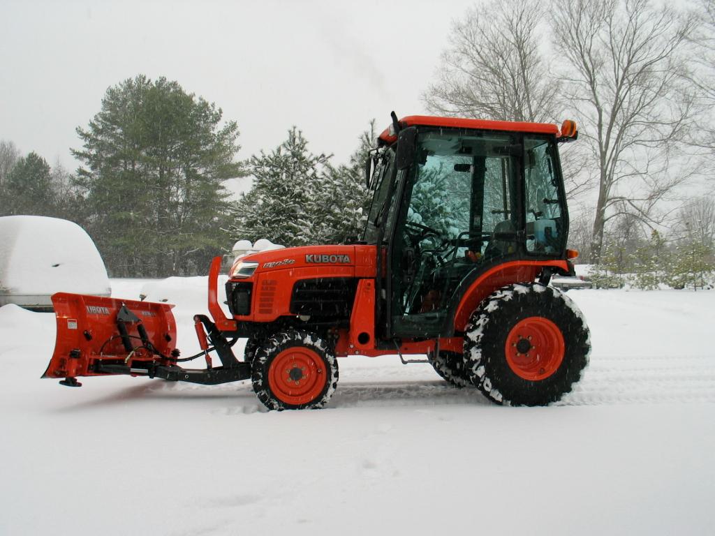

Though it might work, (I don't know for sure) the quick hitch for the B3030/B3200/B2630 is different from the one used on the B7800, and mounts to the tractor at different points. I've saved some pictures other members have uploaded, so let me see if I can find some...... Yes, you will see that the newer quick hitch is much shorter.

I suspect Chuck's pdf showing the rearward mounted quick-hitch subframe may be the B2761.
If that is the case,it most likely was never designed for the B3030.
